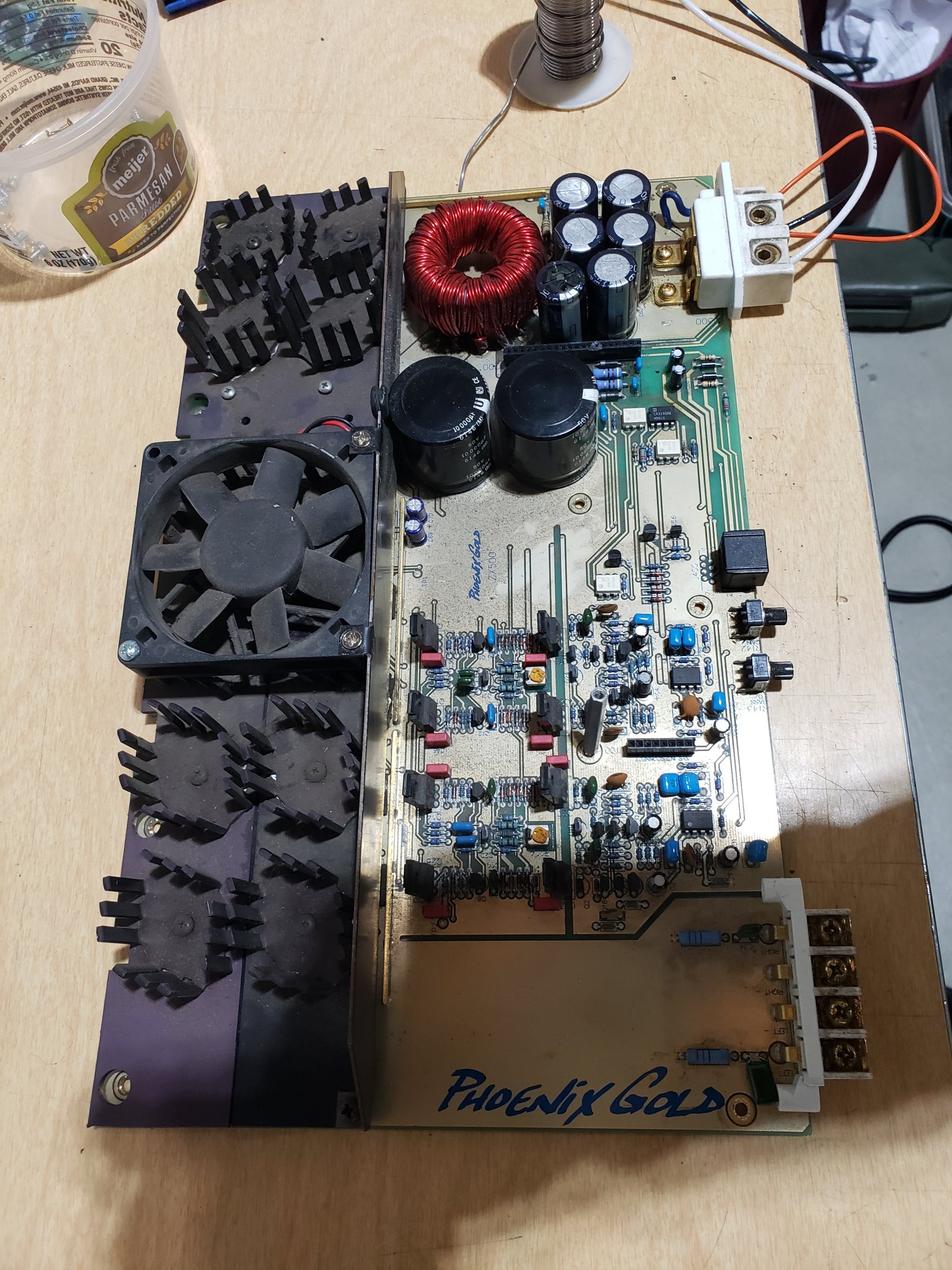

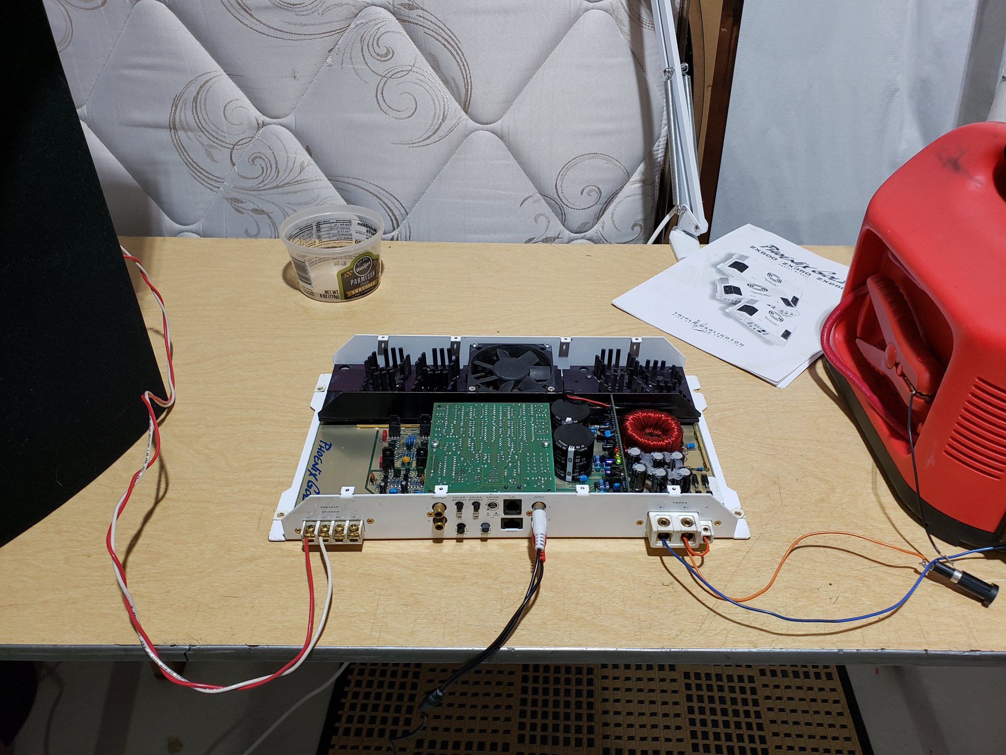

Im working on this amp for a friend. No power light. No voltage to chip that oscillates the 12v to transformer. I need a schematic.

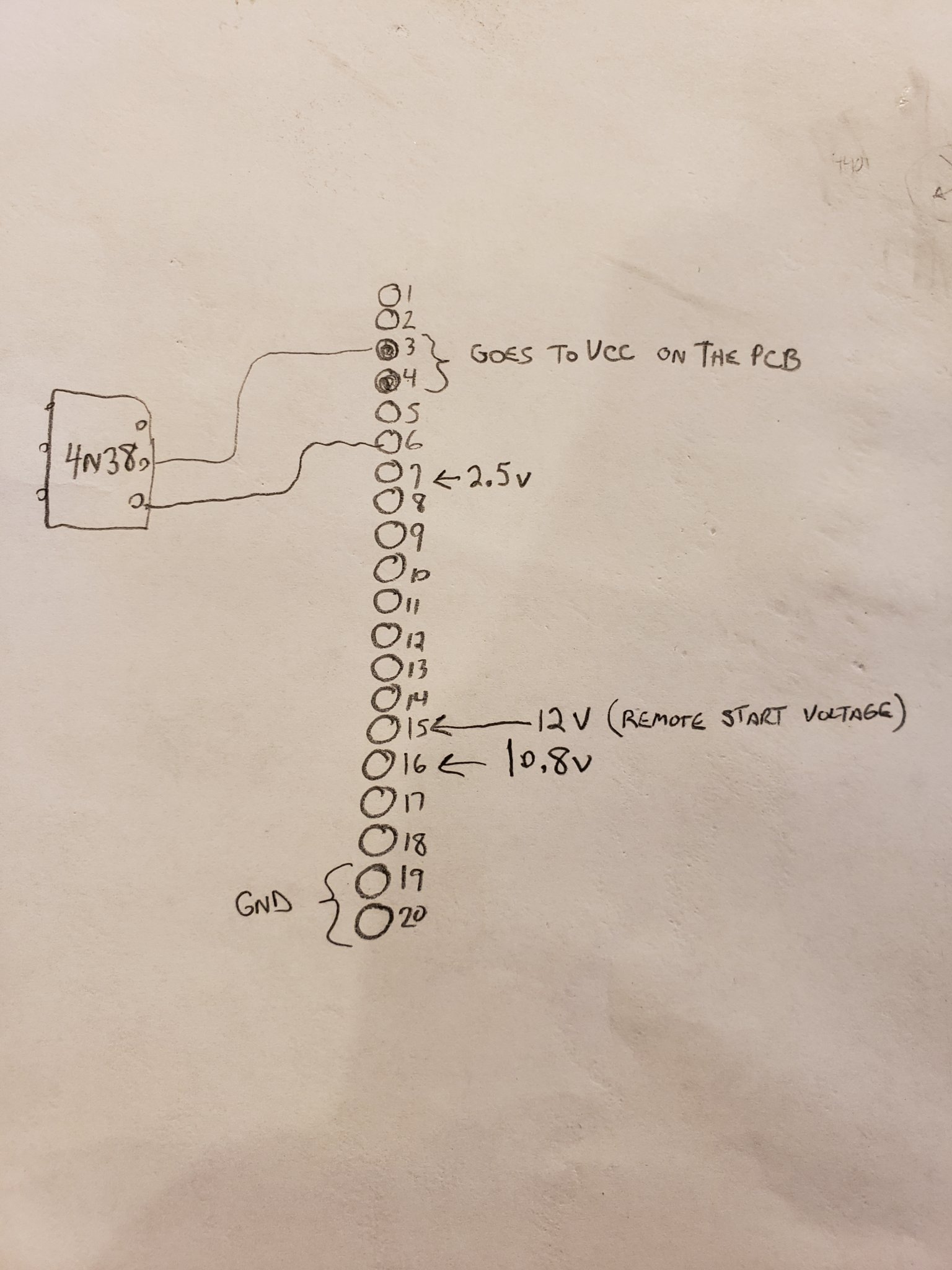

Hi Perry,
I attached a pic with voltages.
The Vcc for the IC's on the small board goes to pin 3 and 4. Their grounds are pins 19,20.
The remote start voltage is pin 15, with a perfect 12v.
I did try to reverse engineer the Vcc voltage and found it goes to a 4N35 ic on the big main board (i marked it 4n38 on drawing); an optocoupler.
I cannot find any opens or shorts on any components.
I think you should have 12v on pins 1 and 2 from the notes I have.

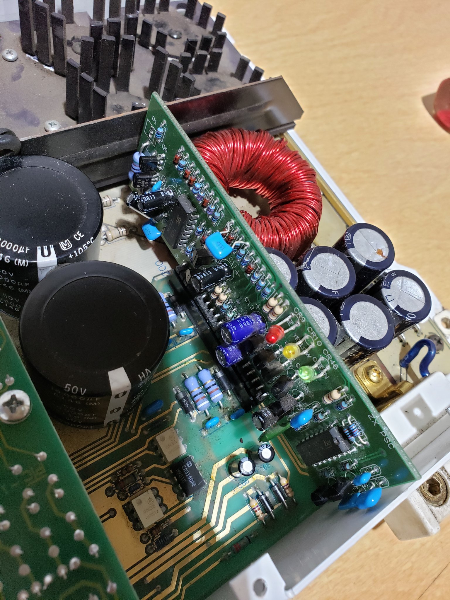

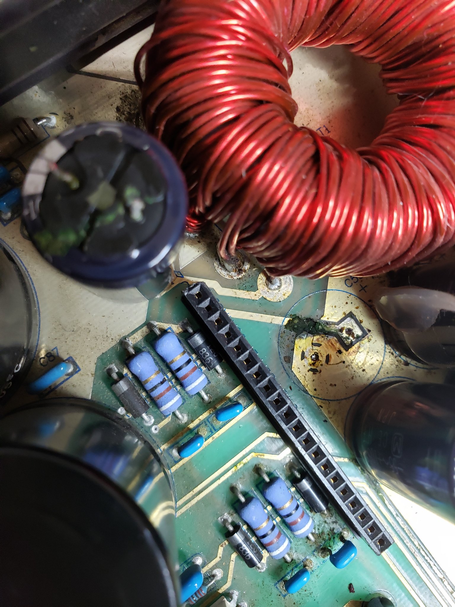

Hi Perry,
Pin 1 and 2 have continuity to the trace. I pulled the cap and I do not have continuity to trace where the cap is soldered.
Damaged trace.
Looks like either cap leakage or moisture. Probably cap leakage.

You may want to pull (at least) one of each different size/series cap to see if any others have leaked.

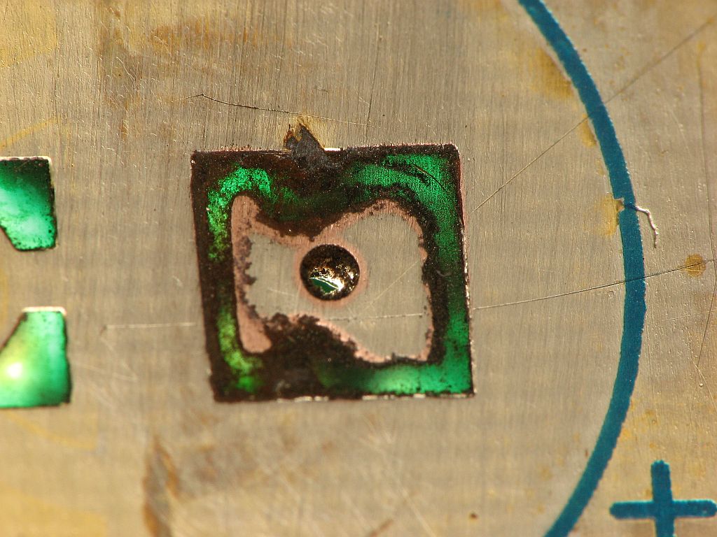

After cleaning the board thoroughly with acetone, take a bright light and aim it at the back of the board for any solder pads that had electrolyte leak on them. If you have any that look like the attached image, electrolyte may have saturated the fiberglass and it may have to be cut/dug out.

If they're not leaking, they're likely OK. Some amps had a LOT of cap failures and for those, a full recap is required. I know that these (and many other PG amps) had bad primary filter caps. The rest, I don't know. I had an M100 come in before that had extensive board damage that resulted in a large part of the board burning.
I suggested checking the various caps of each type to see if they were leaking. Looking at the photo, there aren't many caps so it wouldn't be hard to replace the electrolytics.
Did the board show signs of electrolyte saturation around the solder pads?

Hi Perry,
I'm going to replace the 6 primary caps and the two big ones.
The only ones leaking were the 6 primary ones.
C57 did show signs of electrolyte saturation around solder pads.
I soldered temp wired a jumper wire and it did power up.
I am going to repair the trace on pin 15 for remote power up. I did notice that corrosion initially, but I had continuity.

Hi Perry,
Ok, everything is working correctly now. I have one last question:
The fan does not run. It is not very hot. I have let it on playing to see if the fan comes on.
Does the fan only come on when unit is hot?
John
