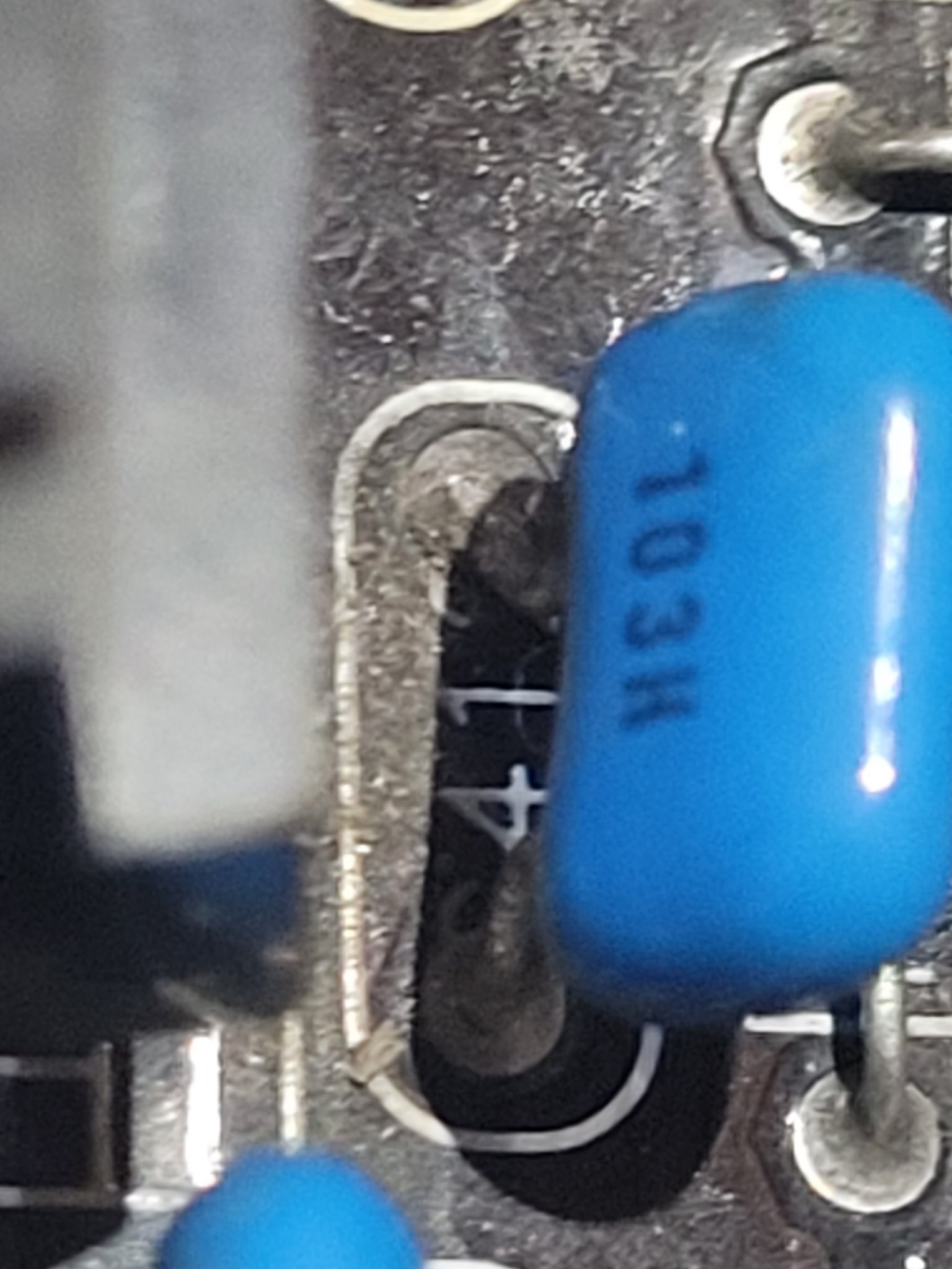

I am missing a part in the circuit board and was hoping that it could be identified I have other parts on order I would appreciate any help thank you

Thank you for your reply and I was just cleaning up the board a bit more, also straightening up the every thing and I did find another C41 and I believe it's a polyester film capacitor, blue one and as far as I can tell I only need the 1 I found a very similar one on line but it's a pack of 500 would anyone know where I could get 1 or even 5 please help I do miss the amp I have other zxti's 2 600 and a 400.. I do find the amps very strong, loud and clear!!!!! Thank yous all for the help in advance. If thee was a sound shop or repair shop close by I would send it I live close to Ottawa Ontario???If you can't find the corresponding part in one of the other channels and no one can help, try the following forum.

0.01uF (10 and 3 zeros, in picofarads).
If there are no markings on the other side, it's likely rated for 50v. The k indicates that it's a ±10% tolerance.

Your awesome thank you very much. I honestly thought it was 105H but I don't read circuit boards but I wish to learn more and more these older amps are amazing. I'm hoping to collect more. And now I'm much older and have more respect for my equipment. I do still like to use up to its potential I will order that part right now!! 11:44 pm February 8 and I have some of the parts0.01uF (10 and 3 zeros, in picofarads).

Is the cap shorted or otherwise defective?
A J=5% tolerance, K=10%. That covers most small capacitors.

The part is missing either melted or blown up there is a " C41" on the board where the 2 wires are sticking out and the same reference number was under the blue 105 capIs the cap shorted or otherwise defective?
