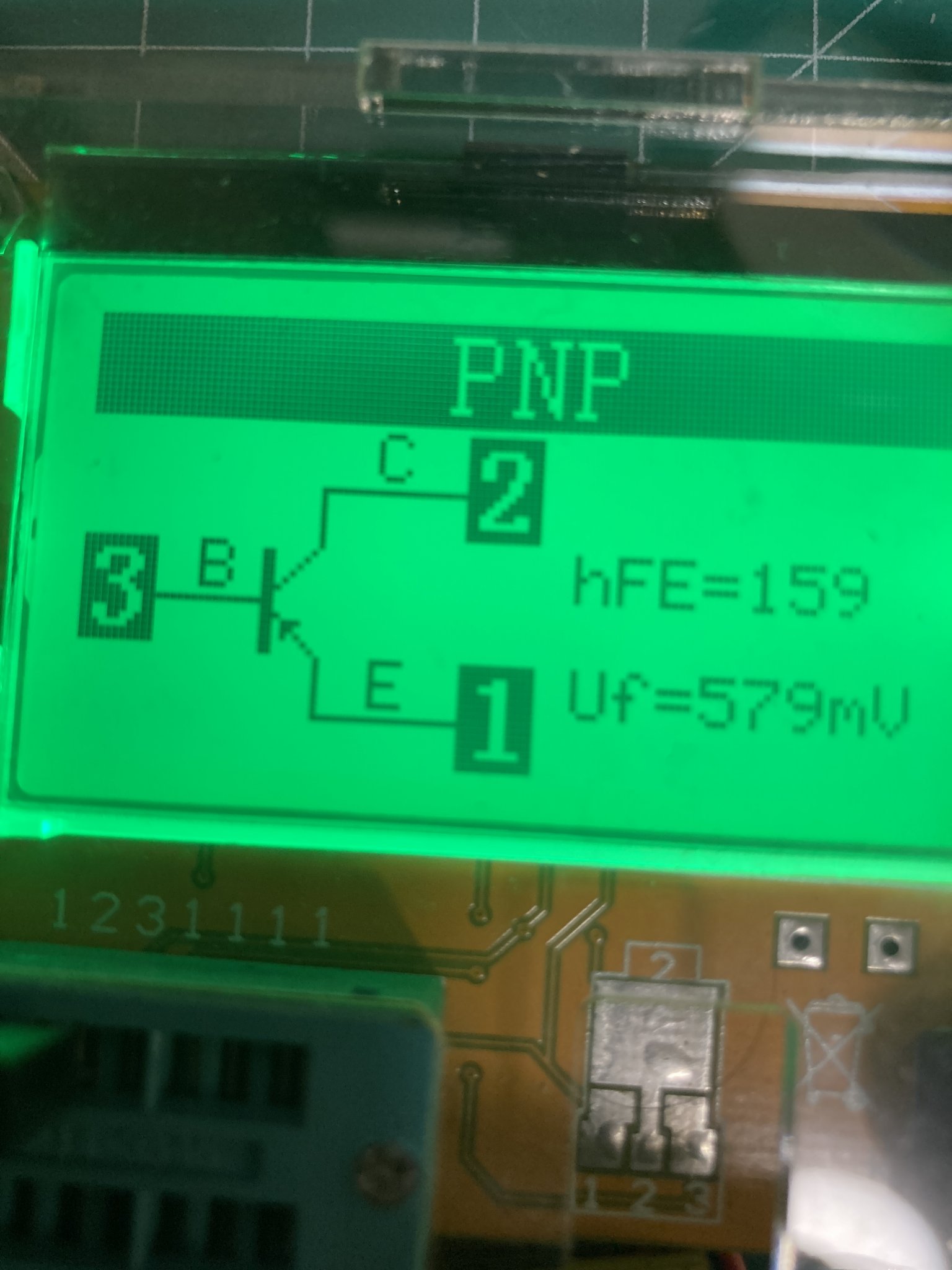

I traced back from pin 12, through one resistor and one diode to a 649A transistor. It's emitter traces directly to the DC input. However, when I measured its voltages, the emitter only had 4.3 volts. I then verified at the DC input that something is loading down the 12 volt input to 4.3 volts. Current draw is about 1.5 A.
I have some, but they are mostly small signal transistors.
Oddly, here is what the tester showed out of circuit for that transistor.
You can jump the transistor location from collector to emitter to allow further testing. Be careful when applying power in case there is a shorted component being fed by that transistor.
I don't trust those testers. The BE junction is essentially a diode and more than about a volt difference means that that junction is damaged.
I am not sure. I had a fully charged, known good battery connected and was getting the same voltage reading on B+. Battery read in excess of 12 volts unconnected and then B+ read 4.3 volts (approx.) connected.
I do not know enough about these circuits to isolate the cause, but it feels like something is definitely loading down the input voltage. Obviously, it's not a dead short.
Is there a circuit I could study somewhere that is representative of this type of amplifier power distribution? To be honest, I don't even know which all components are fed B+ directly in these amps. I think I am spoiled because in my other electronics work, I rely heavily on schematics and diagrams.
