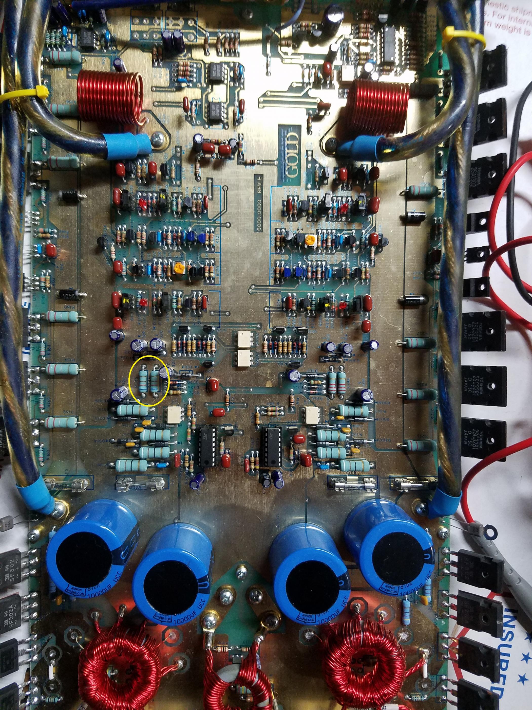

Phoenix Gold MS-2125 no rail voltage

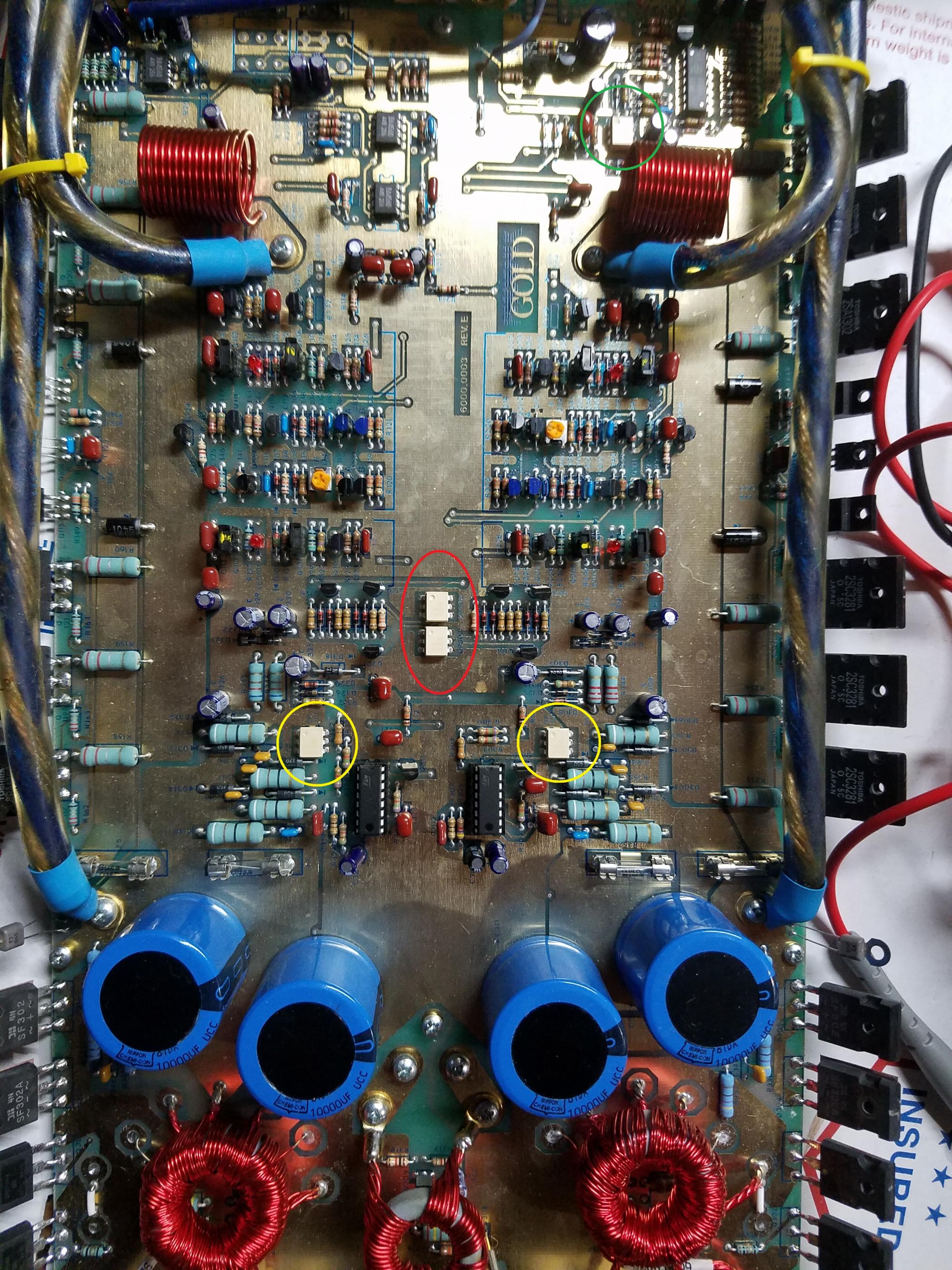

There are 5.
Opto-couplers circled in yellow are both: 1/2 +1.10v, 4/5 +2.54v
Circled in red are both: 1/2 +1.18v, 4/5 +0.018v
Circled in green: 1/2 +0.004v, 4/5 +11.74v

All the flame proof resistors check good with the exception of the two circled in the attached photo. Both are of the same value but are giving quite different ohm readings. They are also both getting very hot when the amp is powered up.
As I was going though checking the transistors in the right channel I found one of the 51ohm resistors was shorted open. I replaced it and regained power on that channel. I then checked the resistors in the left channel and found it also had one of the 51ohm resistors shorted open. Amp is now powering up and functioning as it should.
