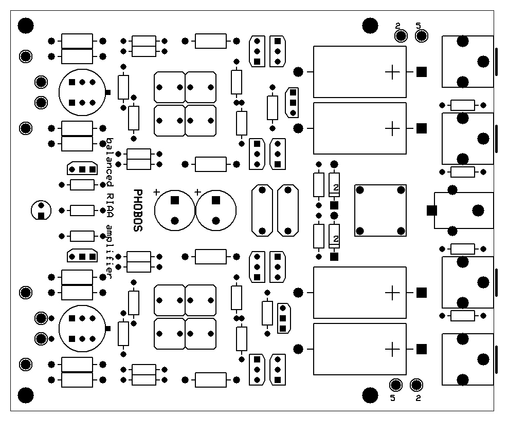

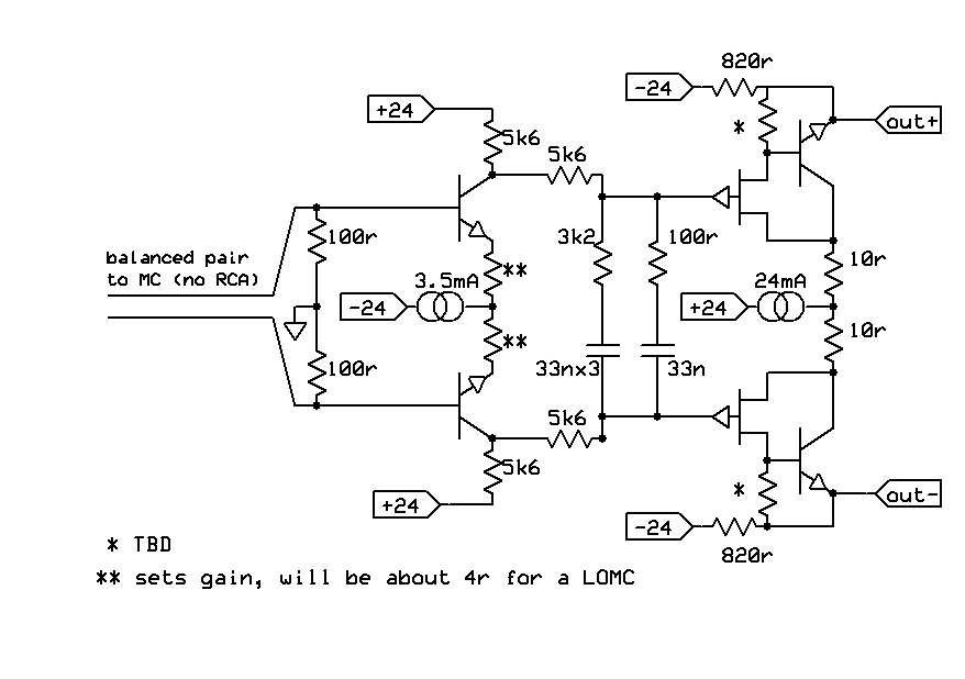

Here is the latest schematic and board layout. The board is 4.7in X 3.9in designed to slide into a standard Hammond enclosure. It employs the ubiquitous 3.5mm trs jack for both input and output. If needed, cables that go from these to XLR are readily available at pro audio sites, not to mention ebay. I have installed 3.5mm jacks at the turntable, connected directly to the wires from the tonearm. Still some tweaking to do, should have one operating in a couple of weeks.

Thanks for starting this thread Polyphaze. I have wanted to build a balanced phono stage for some years now, but I have never been able to work out a design that satisfies me. The Phobos looks just perfect for my needs and I will be building this up ASAP.
I will be running off +/-24 volt rails ( 4 x 12V SLA batteries) so circuit values may be different to yours. Are you able to update your circuit with all values so I can work through the values I will need.

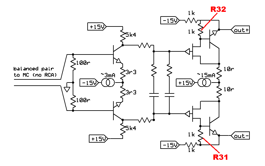

I would like to ask about resistors R31 and R32 (labeled in the attached schematic).
The voltage across each of these resistors is VBE, about 0.7 volts.
If their resistance is 1000 ohms, the current in each of these resistors is about 0.7 milliamperes.
So the drain current of the Pchannel JFETs is about 0.7 milliamperes.
The total current per side is 7.5 milliamps (15mA / 2). The PJFET gets 0.7 mA and the NPN gets 6.8 milliamps.
That is what I would to ask about. The current in the NPN is about 10 times larger than the the current in the PJFET. Why? Why this particular 10-to-1 ratio? Why not 2-to-1, or 1-to-1, or any other ratio?
Thanks for your time!

It seems that no changes whatsoever are required to run with 24V rails. However, in the output stage, one could increase the CCS current, and decrease the R of the output load resistors, thereby lowering the output Z, a good thing.

Hi Mark, my simulator (SIMETRIX) doesn't have models for the exact components we use, but using generic devices I have tried out a few scenarios. What I observe is that, for a fixed current, the more current that gores through the BJT the higher the gain. Now we need enough current to turn on the fet, and keep it turned on for the full voltage swing of the first stage. The 2SJ74 fets I have measure Vgs of 300 to 400mV for drain current of 1mA, and this seems a reasonable figure. This implies that the drain resistors should be about 700ohm (but it would also be worthwhile measuring Vbe of the BJT at collector current of 7mA to check this figure. In fact I think you need to measure Vbe and match the BJTs for this to ensure that jfets get equal current for equal drain resistors.)
So, there is no magic ratio as far as I can tell, but I intend to start with fet current of 1mA and see how we go.
OK that seems OK - but you haven't included the values for the components in the eq network. What would these be?
Thanks, Hazard

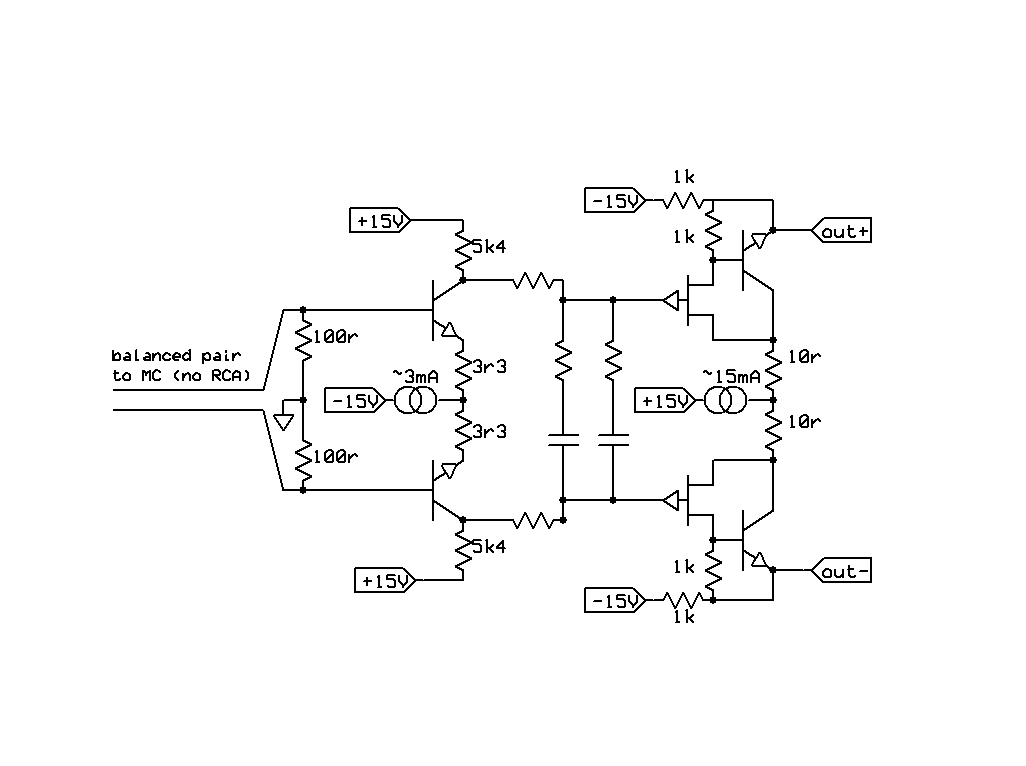

Here is an updated schematic, optimized for 24V rails and adding some component values.
Thanks Poly, I've been playing around with this in SIMETRIX. I found some spice models for MAT02, and 2SJ74, so hopefully the simulation is pretty close to real life - its certainly very different to the outputs when I used generic devices. I have included both the circuit diagram and response curve. For inpuy of 0.5mV, output is around 2.5V @ 1kHz, so gain is just about right for ZYX and Denon, with a little overhead if real life circuit doesn't meet simulated results.
Note I have used +24/-12V rails. This helps to keep load resistors on the output stage, which define output impedance, as low as possible. Current in 2SJ74 is now 2mA, I need to check matching on my devices (which was done at 1mA). I will build this and test when I receive MAT02, due in today's mail.
OK, good progress. That response curve is very cool.
I was puzzled at first by your move to a -12V rail, but realized you must be looking for gain, as 74db is a lot more than I have ever needed. However, increasing gain is much better done by decreasing the emitter (source) resistors. So lets go back to -24V rail, decrease R11 R12 to 6r, decrease output resistors to 1k, and up the source current to 30ma. The circuit should now have the same gain profile, but with lower output Z and headroom galore. In fact, with an overload input of 5mv, output will be a very clean 25V with room to spare!
BTW, I'm leaning toward all BJTs in my implementation. No particular technical reason, I'm just a bit out of my comfort zone working with jfets.
You should probably try them in your sim, if just for a reference.

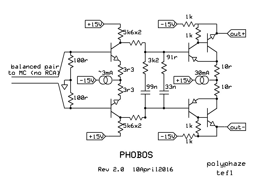

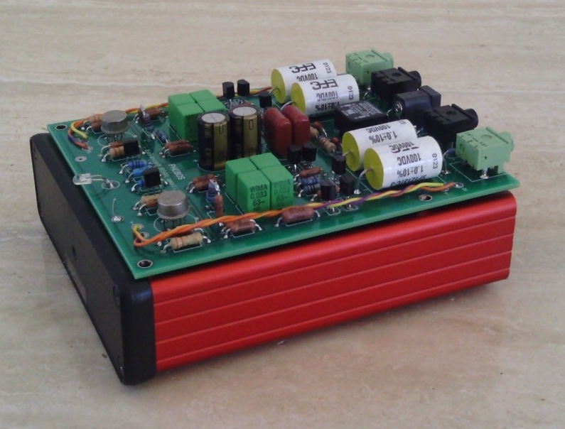

OK, the deed is done. Here are a couple of pics, and schematic, of Phobos 2.0. After several several hours of listening, I can say that it is a marked improvement over the original, which was already quite nice IMO.
You are right Hazard, 24V is a bit too hot for this output stage. I went with 15V because that was easiest for me, 12V or anything in between is fine.
There is an offset in this first build, hence the output caps remain. With more careful component matching, and better regulation, I'm pretty sure the caps can be dispensed with next time.
I'm going to send a pm with some other details.

Looking nice Polyphaze. One question - is CCS in output stage really 30mA? based on values shown, this implies about 1mA in the pnp device and 14mA in the npn device. What is dissipation in this device? I can see that the purpose of this current is to keep the load resistors (and hence output impedance) low, but I am surprised to see 14mA in one transistor.

The CCS is 30mA. The quiescent Vce of the npn bjt is around 8V, so dissipation is about 1/8 watt, easy enough for a T92 package.

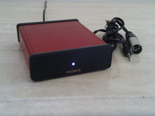

Sometimes my diy projects take a while to reach fruition. In contrast, this project only took me 5 months to complete.
I finished up building the Phobos circuit all bjt as proposed by Polyphase, better to stick with a proven circuit firstly then I can experiment with j-fets etc later on. I decided to stick with +24V/-12V rails so I can continue to use my existing SLA batteries for power supply. So I tweaked a few resistor values. But otherwise built it exactly as designed.
I sent my Lenco to the workshop a month ago to get it ready for the debut of the Phobos but it's still there. So I pulled my old AR turntable/ Rega arm combo out of storage. This lead to further delays - there is another thread on this forum about Rega arms, did you know that Rega arms don't support balanced output? I didn't know this, and spent a frustrating week testing my finished Phobos for non-existant faults - finally I had to re-wire the Rega arm.
The current turntable is far from state of the art, but with my Monster Alpha Genesis 1000 it is making a very nice sound. This cartridge is only 0.2mV, but there is oodles of gain, and with battery supply it is dead quiet. I don't think its quite as nice as my old VSE valve amp but it sure is a quiet in comparison. But I've been running the Phobos for one day only, I've had the VSE since 1988 and its had a number of mod.s. Give me time to get to know the Phobos better, and we will see where we go.
As with my Strain Gauge pre-amp, the output stage is transformer coupled (Lundahl 1527XL). I have a variable resistor across the output of the transformer (its actually a series switched attenuater from eBay). Changing the resistance changes gain, my preamp is a selector switch so I am going from the output of the Phobos directly to power amp input. And its sounding great.
There has been quite a few phono pre-amps on diyaudio lately. But not many are balanced like the Phobos (actually I can't recall seeing any others). And it \\the Phobos sounds so good, I don't have any desire to or need (or indeed the time) to try other circuits). Thank you Polyphsae for a brilliant design, I am very happy with my pre-amp. Can't wait to get the Lenco back and hear it working with a 'proper' turntable.
