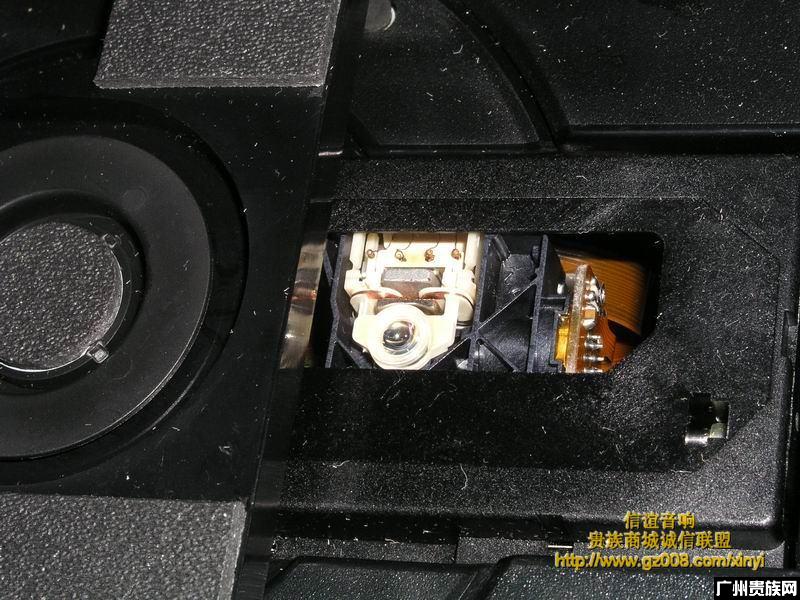

Spent the weekend trying to fix my them and after fiddling with just about everything it turns out the lasers are still fine. The heads need manual adj despite all the docs floating around stating otherwise.
Tweaked the alignment of the heads with a torx screwdriver using purely trial and error gets rid of the "no disc" error and the "skipping track" and "not able to read copied CDs" problem. Once roughly aligned you will see the CDs spin again after door closes. Then its a challeneg to get them tweaked till they read CD-Rs and the higher-numbered tracks.
The SF-CD1, unlike Levinson and Wadia, does not have a locking screw to secure the head.
The damn silicon stud mounts give way during transportation and causes the heads to be misaligned. They were probably marginally aligned in the first place or aligned for some other bracket than your particular model.

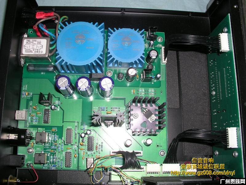

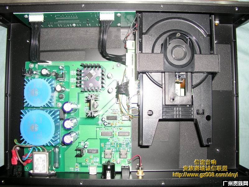

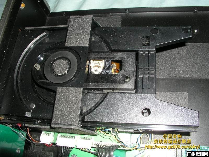

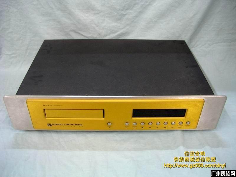

Both the SF-CD1 and SF-T1 are the same
12.4 mechanism. The CD1 is a player whereas the T1 is a transport only model.
The trial and error alignment process was a real pain. As you said its impossible to adjust while the CD is there.

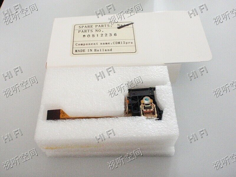

Here are a supplier of CDM12.4 and VAE1250 head (optical pickup) in an expensive version, discover by chance.
Optical Pick-up Units (OPUs) | Enco Systems
Maybe NOS devices from Philips, made in Japan, no cheap China copies in bad quality.
Are there any experiences?
Enco's Chris mentioned to me that these are not Philips heads but far east replacements although he noted that he was satisfied with the quality of this lot as opposed to others he had seen. Might give them a go myself.

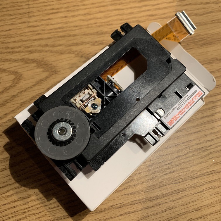

Hi All, i've been here as i've start the restauration of a micromega stage 2 -i've bought cdm 12.4 from a good source supplier in germany, belt, lubrificated the tray etc.) now i'd like to take the unit to a pro service as i need to change the old head that always shows -NO DISC-. In post #20 phi70 is saying that "A unit with a newly replaced laser will not survive a short road trip to a friend's house... NO DISC upon arrival and it happens everytime."
Does this means that i've to change in my place the new head 😉 ? Or simply that it's a waste of time (period)? I guess i could let the micromega stage 2 "live twice". Any info is welcome, cheers!
There should be NO problem in transporting the player. A CDM12.4 head should survive being thrown across a room...
The pickups that have been on offer for the last decade or more have been generally appalling in quality. If you have secured a good one then you are lucky. Fit it and enjoy.
The tray and the gears on the Micro mega tray should run 'dry'. The only points to apply a plastic/metal compatible grease are the spindles for the two tray gears.
See also:
http://www.diyaudio.com/forums/digital-source/118902-stripdown-clean-cdm12-4-a.html
See also:
Thanks Mooly, i double checked the old head in my micromega and i realized that the assembly is easier to work with: just remove the holding plastic holdings from the drive and snap again (with all connectors). Is it correct? So i will do it by myself instead to bring it to the service, as i've unmounted the tray and the mechanisms of my micromega many times. Thanks again for your help.
It all comes apart very easily. Just be careful not to damage the neoprene suspension units as you gently prise/slide them off the CDM12.4 base.
Mooly, i've received the cdm12.4 and already mounted: i needed only to bring to the new unit the old cables as the new one has got a different connector. Now the work is doine and my micromega stage 2 is reborn! It plays marvellous sound as i totally forgot it. Thanks again for your help, without it i couldn't succeed!

A friend want to know various currently delivery source for NOS versions of CDM 12.4 heads (made in Japan or made in Taiwan but not made in China).
One example is this supplier:
https://encosystems.net/product/opu1-optical-pick-up-unit-for-cd-pro-1/
unfortunately not cheap.
Thanks for more supplier addresses therefore.

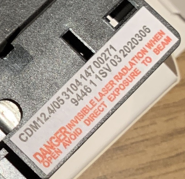

Here's a pic of the sled I just received from Partsconnexion in Canada. Not sure what it is but they should be reputable because they were the official supplier for Sonic Frontiers when the company folded, and they have always stocked ample supply of the Philips part in the past.
https://partsconnexion.com/products/philips-cdm-12-4-05-optical-laser-mechanism
As you can see I got the whole sled, not just the laser pickup shown on the web store. Unfortunately I'm having trouble with it and there was solder on the wiring terminals suggesting I am not the first person to try it or it was salvaged. The original part has the Philips logo on the sticker unlike this one.
