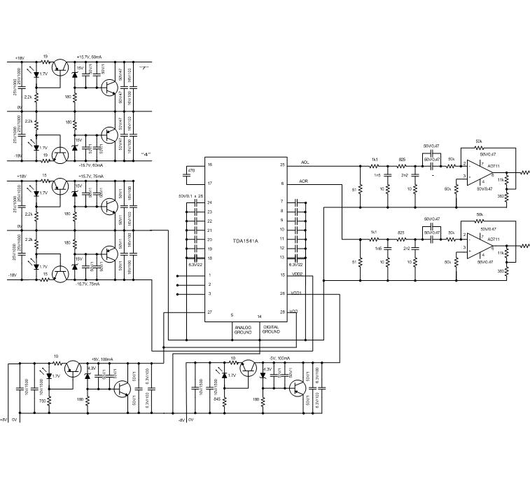

Great opportunity to compare MODs and offer believable feedback. Please give internet location of the OPA 660 circuit.
Reliable observers have reported NOS TDA1541 as the best 16 bit DAC chip once modded appropiately. But you seem ambiguous about it? You are using a 780X at the output of your power supply, most others are using TL 431 to regulate and decouple. Perhaps this would help? Also although the specs of the OPA 660 look impressive is it the best opamp for this purpose? Perhaps better to have used a socket to allow exchange of opamps for comparison. AD825, AD 8065, OPA 627, 637 browndog adapted to dual status seem to be the most regarded chips for the output.
Please use SEARCH function.
No,I use 7805 for current injection.The preregulators for OPA660 317/337 are used and finally regulation is done by TL431 ,as in original Thorsten schematics.
OPA 660 is not regular op amp and you can't substitute this with regular op amps.It is I/V converter + buffer,please see PDF for it.
