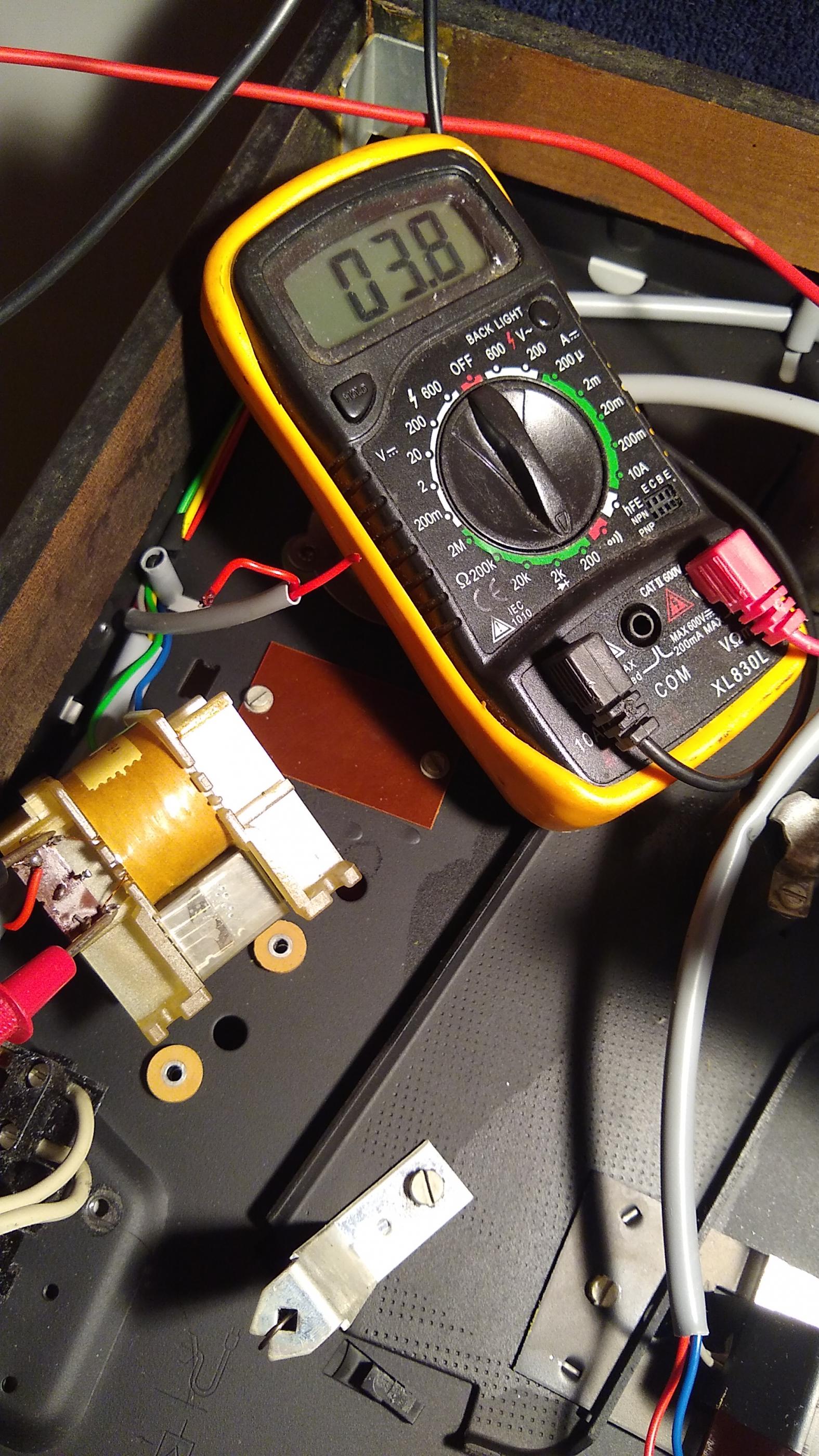

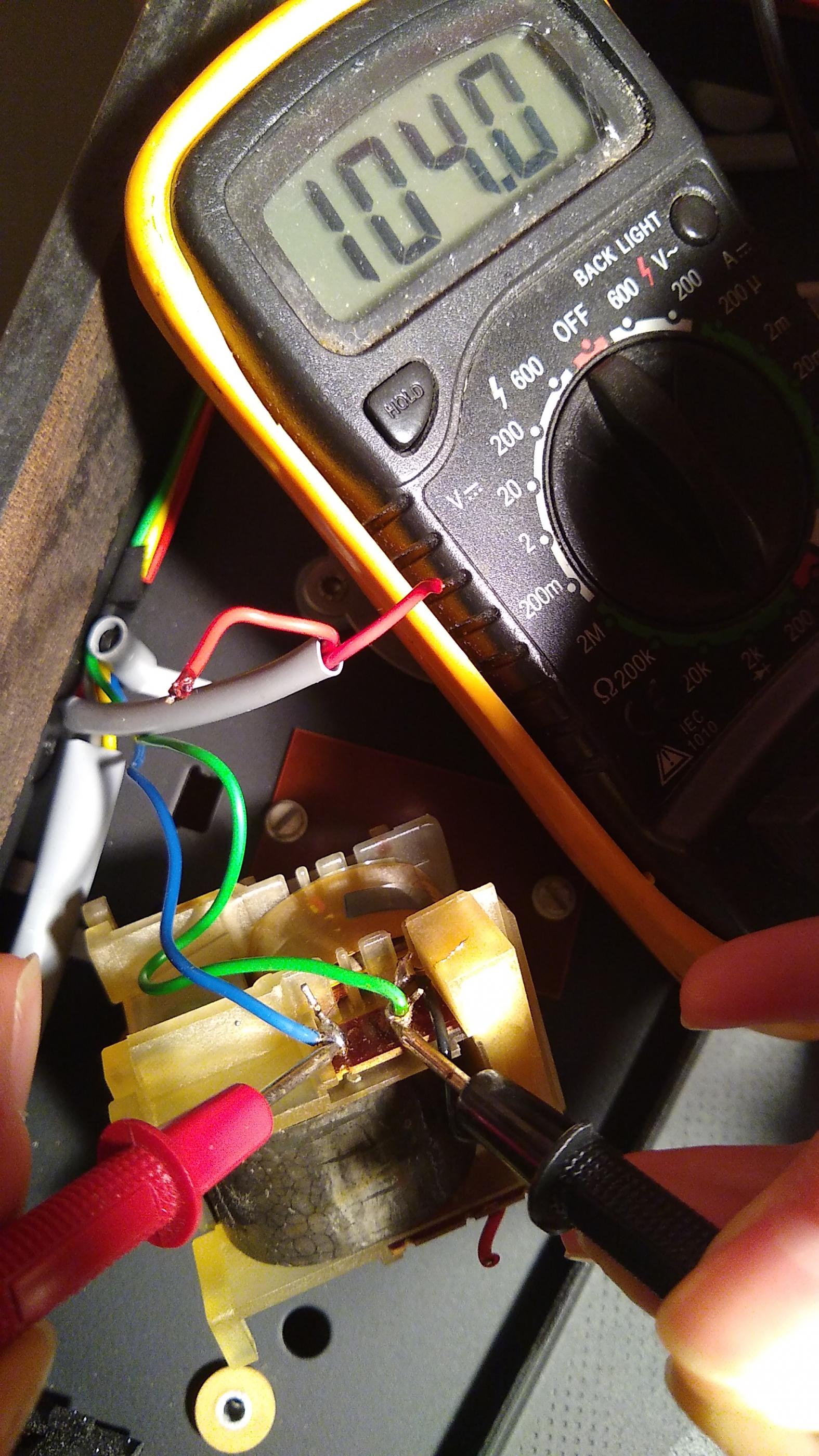

Transformer seems to be OK..So transformer is disconnected from the control board
DC coil resistance is 4ohm
Ac coil is 104ohm
I measured resistance straight from copper coil terminals.
Does this mean transformer is a toast. 4ohm is a little low for this amount or cooper I think. But what do you think? I am not an electric engineer
BTW, there's nothing like a DC coil.. Transformers are AC only and have a primary and secondary side.
So now it'd be good to know how much Vac the secondary produces and how much Vdc exists after rectification. Measure this over the 470uF capacitor. Please also measure the remaining Vac over the capacitor (ripple), for this might give a clue about how well the capacitor is performing.
