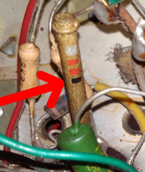

after recent thread by @Elvee I remembered I need to change caps in my Vintage Philips Radio, bought by my dad in 70s. In the past I was told to replace Coupling capacitor. Radio is working somewhat.
Please see attached images. (1) Schematic showing coupling cap position and one elec. capacitor (2) Inside radio actual coupling capacitor shown with red arrow + Blue elec. cap shown (3) A mustard Cap which has tiny part broken at lead. also shown with red arrow.
My question are
1) what type I should use for coupling ? Voltages ? Value tolerance ? Manual says 8K2pf which I suppose is 8200pf. kindly confirm.
2) There is one electrolytic Blue Philips Cap hidden at bottom shown with green color. Should I change that ? What function it serves ? decoupling ?
3) Do I need to change Mustard cap (see pic attached) do they degrade over time ? (Almost 50 years). One has broken portion at lead.

The tubular ceramic and "pinup" cap should be OK, and replaced only if they are a proven source of problems. The same with the mustard cap, which is a polyester film cap.
The blue E-cap is probably still OK, but I recommend replacing it anyway, as it is the most susceptible to degradation, due to age and heat

Thanks. I know without measuring one never knows. But since it is coupling cap. Do these type of capactiros leak ? What type of material are they ? (pic posted)
As for elec. cap. it is parallel with resistor to ground. Dont know the function of the same. It is connected to pin2 of ECL82 valve.

Many old Philips radios, but fortunately not yours, have capacitors with paper dielectric sealed with a black, tar-like substance. On Dutch vintage radio forums they are known as teerbommen, tar bombs. Those are notorious because after many decades, they have usually absorbed some moisture. Their leakage current then increases a lot, as does their capacitance. Leakage in the AC coupling capacitor to the grid of the output valve makes its bias current increase, possibly enough to damage it and the output transformer.
You have capacitors with ceramic and polyester dielectrics that are likely to be fine.

The capacitor in question is a tubular ceramic, normally very durable. It should be OK.
The E-cap bypasses the cathode resistor. Replace it with a slightly higher value, higher voltage modern type, 33or 47µF, 25V or 40V

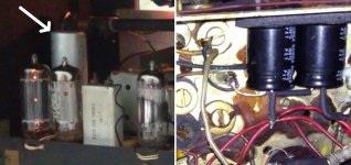

Hi, the PSU caps can be bad too. Here radio enthusiasts dislike the appearance of new PSU caps ("not original") so they build them into the casing of the quite large old original capacitor. Some even pot them with slow curing epoxy. Just a tip.
Reactions: Hiten
Yes sir. The PS caps are already replaced. I understand the originality and aesthetics part of restoration. As original Dual 35+35uf aluminum can capacitor was near rectifier tube which used to get very hot, I fixed 2 new separate capacitors at bottom inside the chassis. Now orignal serves no purpose except authentic look.
Dark brown stuff seen in right side of the picture is wax flowed in some parts which keeps some wires in close proximity of the metal chassis. So I didn't cleaned it.
