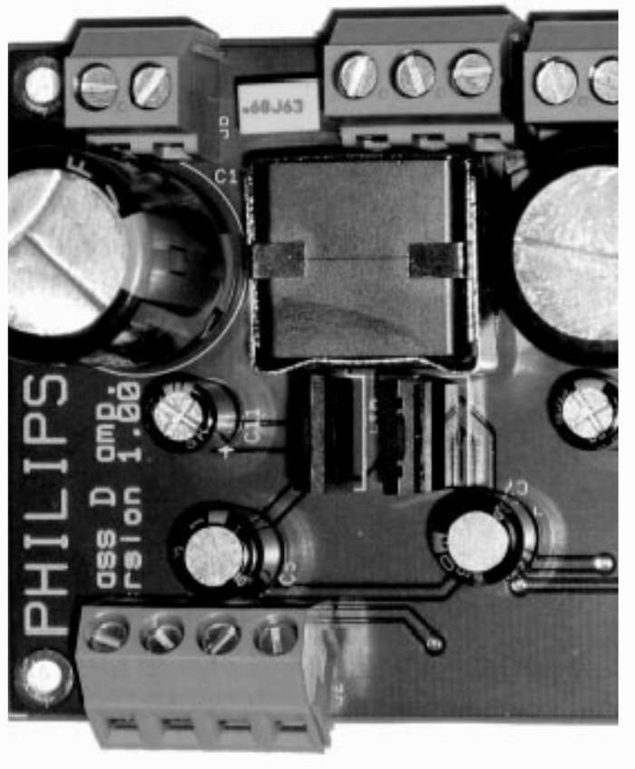

My UCD180s have an inductor marked EP17, which appears to be a Ferroxcube former.
Trouble is, there are several types of EP17, so it's difficult to know which core material they've chosen.
My Philips Demo PCB seems to have the same output inductor fitted - I'll see if there's any way of identifying it further.
Hi, rogs,
If the metal clamp is moved, could the core be halved to look at how many windings inside? And what is the wire diameter used?
Good news and bad news -
I've taken the inductor off the Philips pcb, and removed the spring - that's the good news!
The two halves of the ferrite are secured together with some kind of glassy epoxy resin - both at the centre, and at the edges. There's no way I can see of separating them without destroying the whole shielding, and probably the core.
There appears to be a single winding, of which I count 11 turns. Both connections are at the same end, so I would guess that there are two layers (possibly more - I can't see!!)
Gauge of wire? - I estimate 22swg ( sorry USA members, I'm an old fashioned Brit! - you'll have to do your own conversion to awg 😀 )
Number written on the spring --310421815671 / 0504K
Means nothing to me????
BTW, number written on the UCD 180 inductor is 'EP-17 30uH 180W -- 0619K'
And before you ask, no I'm not taking that one apart! 🙂

rogs,
many thanks for that info... I WAS right all along.. its a singe layer no doubt 😀 im guessing center AIR gap is between 0.8mm-1.5mm..
an LC meter is REALLY helpfull if building one though..
Raff
Hi, rogs,
Thanks for the info.
I'm not familiar with swg. How many mm (mili-meter) do you think the diameter of the wire used?
