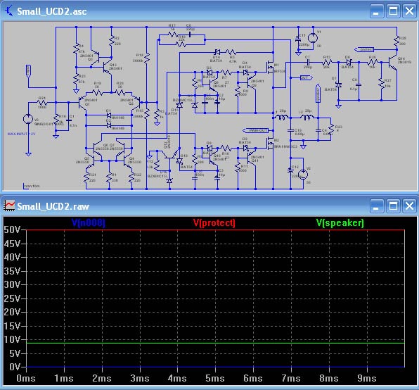

That's PhaseAccurate (Charles).Someone here wrote a tip about the schottky diode. It must have Cj as low as possible. I´m using a 6pF Cj type (BAT46),
Hi, Blmn,
Try also schottky in D1-D2 (instead of 1n4148), it will speed up the cct a little.
Fumac used 24dB filter (2L's and 2C's), but the feedback is taken after the first 12dB. The next 12dB is not inclosed in feedback loop. (If you enclosed it, the mosfets will be smoking). I tried this and the output ripple is <0V3 (p-p) 😀. But I'm not sure how to configure the values of the L's and C's to get the same 35khz cut filter with Butterworth/Bessel characteristic to 4ohm, like the original UCD paper. Using both 30uH's and 680nF just kills the trebles 😀Have someone here any experience using third or superior order filter at output?

I tried one similar (MBR140), but de Cj is higher (50pF and up).
Fripple went down to 170kHz.

I have, and it is bad result, switching freq is very low. PhaseAccurate explained this to me (Thanks, Charles). It's like putting 100pf cap from B-C of Q9-Q10.since you guys have mentioned BAT64 ,1N4148.. anyone tried 1N5819 schottky??
1N4148 has 4pf, but what we need is a diode with voltage about 0V3, to give margin about another 0V3 for C-E of Q9-Q10. 1N4148 cannot be applied here.
ok.... so you mean a 0.3Volt drop is needed with a lowest diode capacitance? .... I dont know if germanium diodes are applicable here... germaniums (some) have .2V drop???

fumac,
having 2nd order filter/s is NOT UCD anymore 🙂 tapping the feedback in between ....
RX5 said:
fumac,
not ucd_like: with some diffrent
not selfosc, 🙂
do u think 🙂
feedback is the nomal tech in amp,
most class-d is base on the same way
and dont trust the sch above, is wrong🙂🙂,is not my real SCH

IN5819 - Tj = 110pF (wow)!!!
- Voltage drop = 0.4V
1N4148 = 4pF , 0.6V drop
I dont know if there is a through-hole part with both the nice specs of the above combined....

like u i dont want to make my job just for others to make money🙂
so i cant post the full sch
u can see i have post the simple protection, include speaker and oc.
if i have a right design, the pcb can working at a vot +- 20%
phps, i use the fet with vds=100v, so i set the vol +- 40v,it can be fit anywhere.
i think the right way to make a ov proteck is base on the power.
not on the amp.
btw, if i just use ucd, i have no need to not to post the sch
do u think so.
