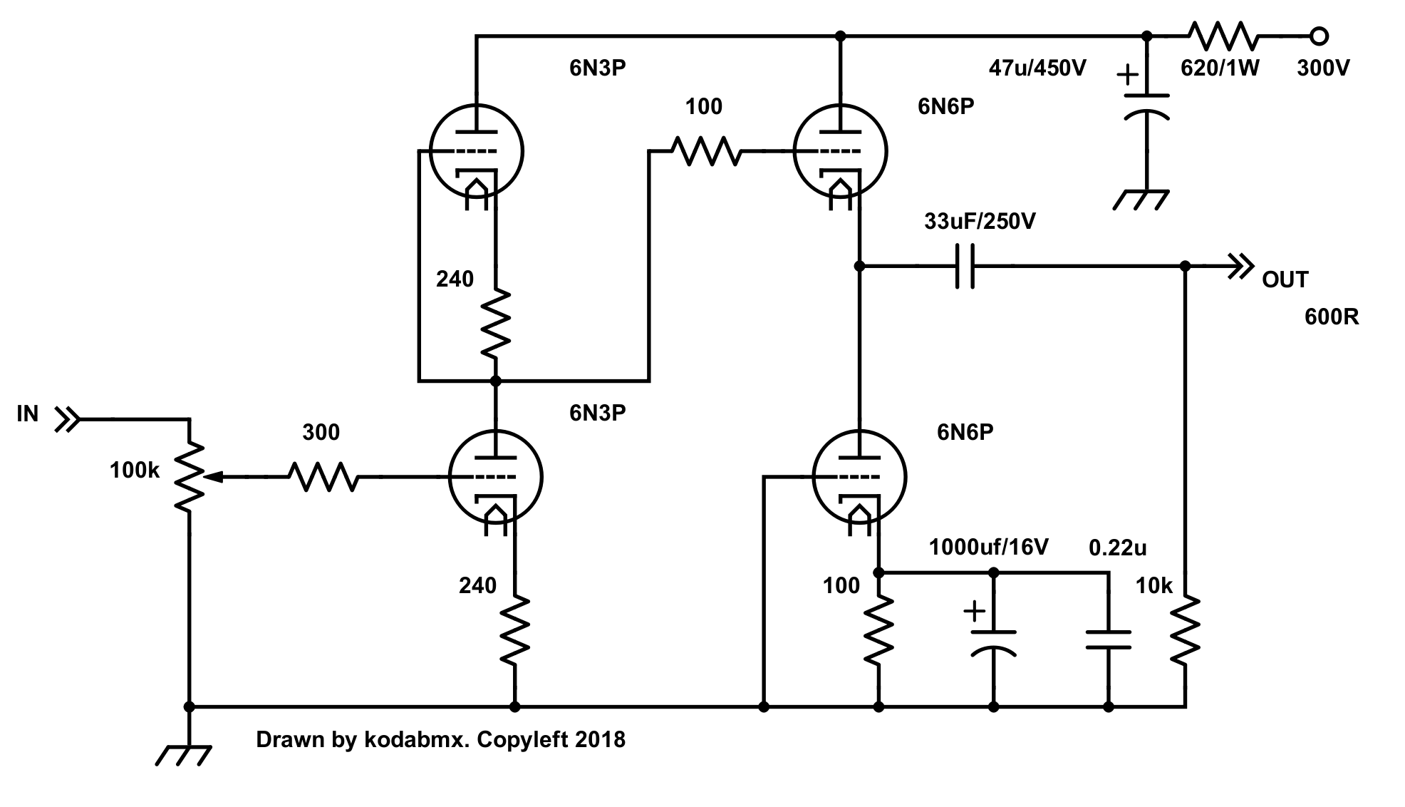

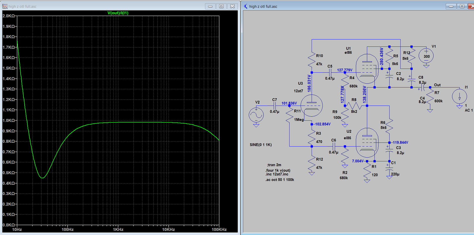

Does anyone have links to a design guide for the SPP (Series Push Pull) configuration used by Philips for their old OTL amps ? EL86 Amps
My intent is a headphone amp specifically for 600 Ohm drivers. The combination of high resistance with low power requirements (about 1W) would seem to greatly simplify the classic issues with OTL designs for normal speaker loads and higher power.
I want to re-spec the components in the Philips SPP design for lower voltage and larger tubes (triode strapped 6L6?)

But with a 600 ohm load should I study the SPP approach, or just accept the consequences of a low load?
The 2A3 predicts wretched harmonic distortion (both 2nd and 3rd) on page 3 of the links below:
https://frank.pocnet.net/sheets/127/2/2A3.pdf
The 6L6 does not look as bad as it predicts about 7% 2nd harmonic and 0 3rd and 4th on page 5 of the following:
https://frank.pocnet.net/sheets/127/6/6L6G.pdf
But if the 6L6 is triode-strapped will the distortion curves look more like the 2A3 and other power triodes?

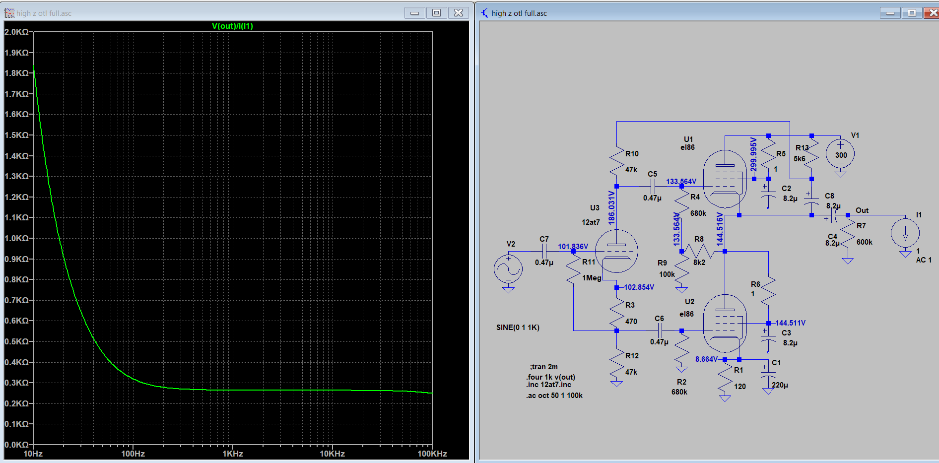

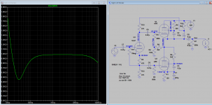

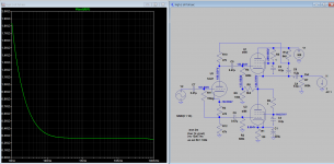

BTW the poor bottom end response is due to fallen output Z and so the output cap value after adjusted, all straight up to 10Hz.

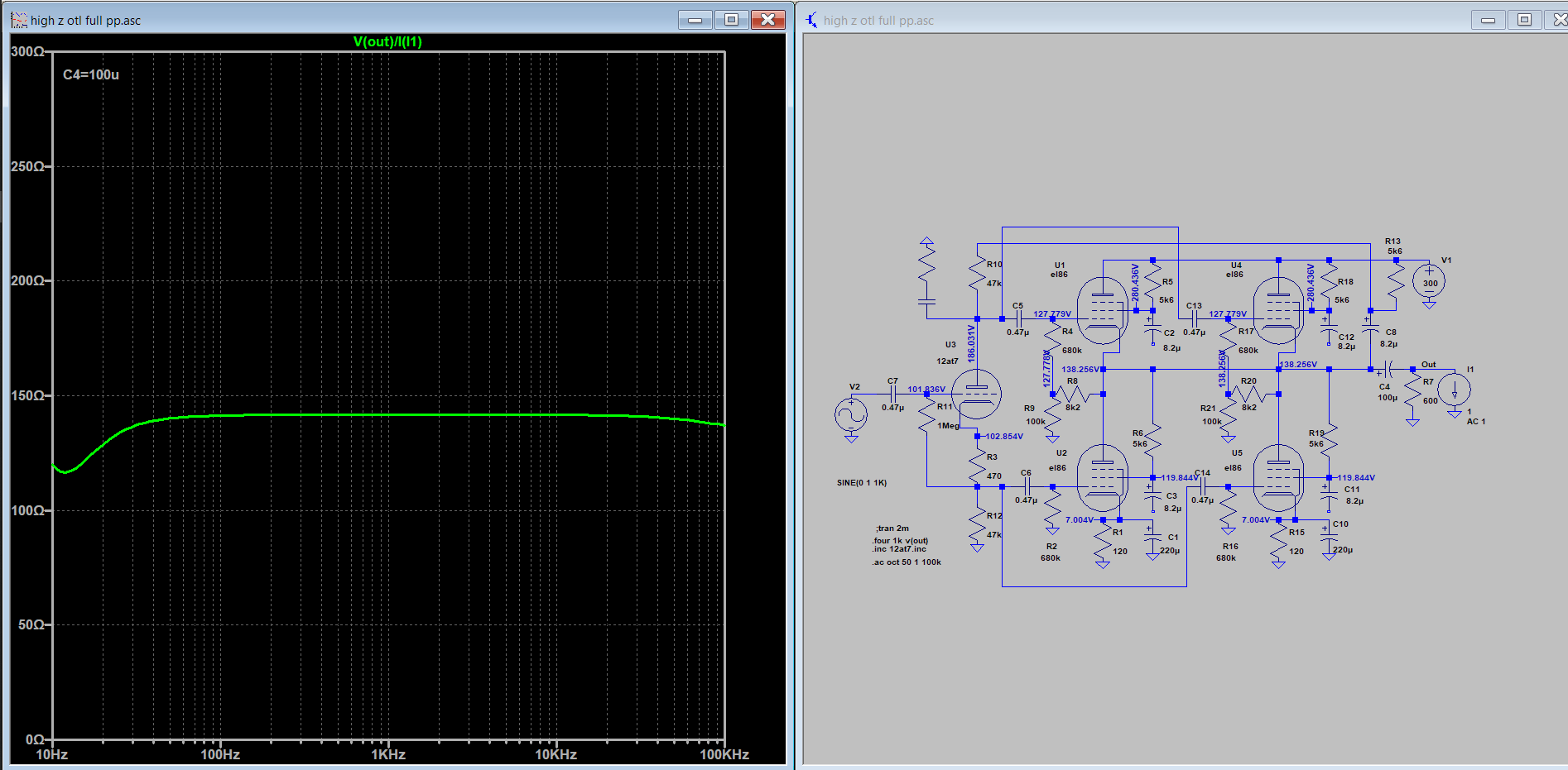

Thanks for the information and references.

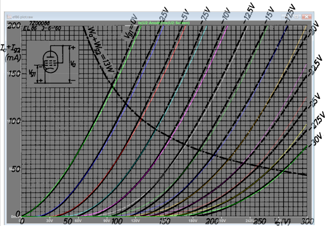

You mention that the the output cap was adjusted to address the bottom end response, but the schematics look the same. Do you know what change was made in the cap?
I have found handbooks and web tutorials which lead me through the selection of load lines and components for resistance coupled, cathode followers, and other standard configurations, but have found nothing for SPP. Can anyone steer me to references that walk me through the selection of the resistors and caps?

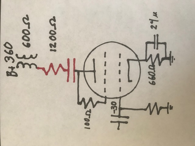

Can I just self-bias the 6L6 almost conventionally if I add a 1200 Ohm resistor to the 600 Ohm speaker load? (with a cap to block DC)
I see this done with guitar amps all the time so that they can be cranked without excessive volume, but never for hi-fi (probably for good reason). In any case I do not mind wasting energy as I can design for 3W so that I can use 1W.
A total load of 2000 Ohms puts the harmonic distortion where I want it (heavy on 2nd and light on 3rd)
Yes, of course you are correct about the cap placement.
but can I apply a 2000 ohm load with the 600 Ohm headphones and a 1200 Ohm resistor in series, and if so, why is this almost never done (other than the waste of power)?
If the OPT has an airgap, you can. Just a waste of power really. If the OPT doesn't have an airgap, you can couple it to a cap, and use the resistor as the load (parafeed). However, the circuit I posted will sound better, use less power, and not require an OPT at all.

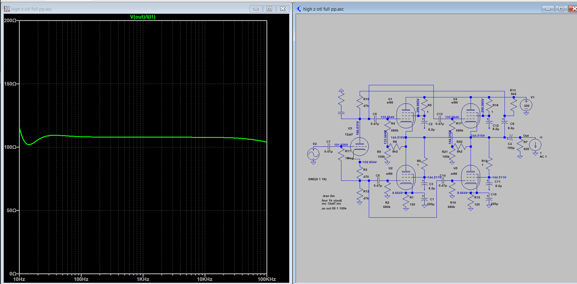

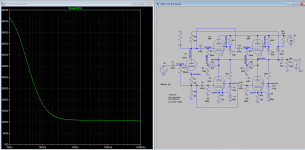

I have some 1950's european tube radio useing srpp mode for speaker output,especially Philips tube radio such as...BD753A...B5X62A...B5X92A...,etc. Philips radio use a very simple srpp circuit as previous discussion for operating in OTL mode, nearly 3~6w output power into 600~1000 ohm speaker with another tweeter speaker. Frequency response is flat but bass control effect seems a little bit weak,due to bass control need a lot of current supply that exceed otl tube plate current can afford . Through capacitor connect to 600 ohm headphone directly, if in medium output power level it still can get a wide frequency response with bass and treble control effect. Its my experence for reference,thanks ..
RC time constant - Wikipedia
Cutoff frequency:
fc in Hz = 159155 / τ in µs
τ in µs = 159155 / fc in Hz
So if coupling cap is 100u and load is 50 ohm, using short equation:
τ in µs=100*50=5000
fc in Hz= 159155/5000=~30
If coupling cap is 8.2u then
τ in µs=8.2*50=410
fc in Hz= 159155/410=~388
Assume that output Z is lower than the load, or you will get error, it is necessary to know Zout first whenever possible.
Cutoff frequency:
τ in µs=100*50=5000
τ in µs=8.2*50=410

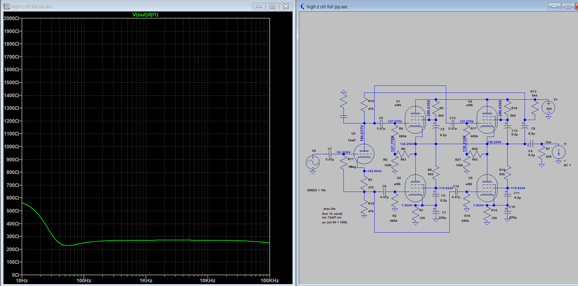

Here is the output Z of SEPPP triode mode after output cap C4 is adjusted from 8.2u to 100u so you can see the diff. The 2nd snapshot show the effect of screen current, Zout decreased as tube current increased

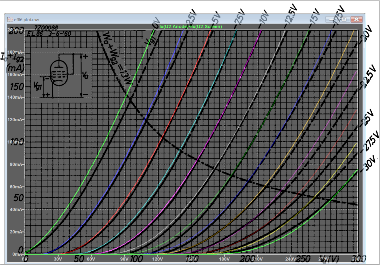

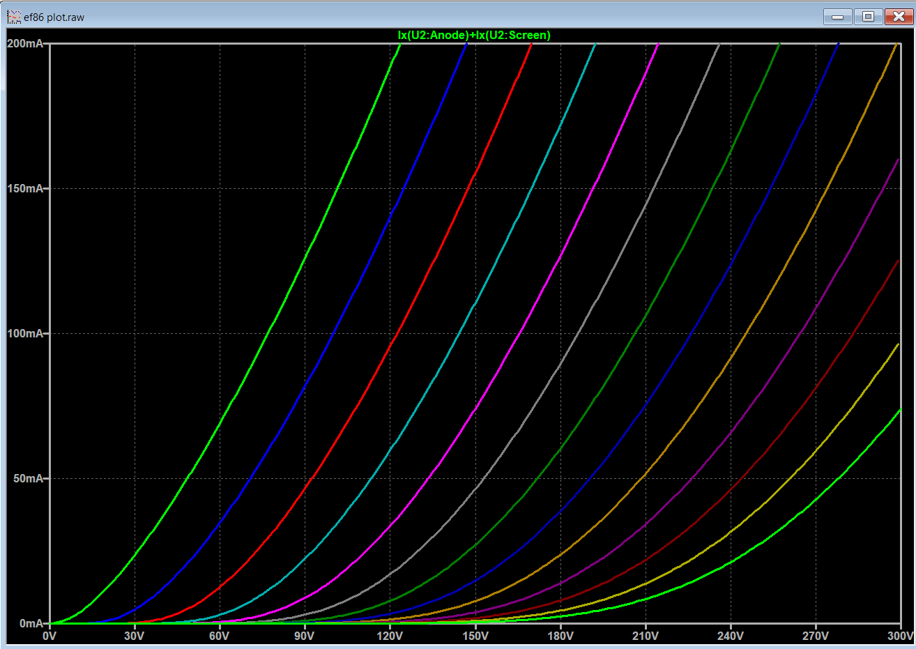

Where did you get these EL86 models for LTSpice from?
Best regards!
I model mine, but found a close one here:
800 Ohm OTL versterkers van Philips. - Pagina 10 - Buizenradioclub

Here is mine:
Code:
**** EL86P ******************************************
* Created on 12/07/2018 04:40 using paint_kip.jar
* [url=http://www.dmitrynizh.com/tubeparams_image.htm]Model Paint Tools: Trace Tube Parameters over Plate Curves, Interactively[/url]
* Plate Curves image file: el86p.png
* Data source link: <plate curves URL>
.SUBCKT EL86P P G2 G K ; LTSpice tetrode.asy pinout
* .SUBCKT EL86P P G K G2 ; Koren Pentode Pspice pinout
+ PARAMS: MU=10.74 KG1=462.84 KP=33.51 KVB=132.38 VCT=0 EX=1.357 KG2=4017.27 KNEE=12.86 KVC=2.498
+ KLAM=3.816E-9 KLAMG=3.967E-4 KNK=-0.044 KNG=0.006 KNPL=50 KNSL=11 KNPR=120 KNSR=29
+ CCG=3P CGP=1.4P CCP=1.9P RGI=2000.0
* Vp_MAX=400 Ip_MAX=350 Vg_step=2.5 Vg_start=0 Vg_count=13
* X_MIN=89 Y_MIN=52 X_SIZE=847 Y_SIZE=738 FSZ_X=1550 FSZ_Y=878 XYGrid=false
* Rp=1400 Vg_ac=20 P_max=12 Vg_qui=-15 Vp_qui=300
* showLoadLine=n showIp=y isDHP=n isPP=n isAsymPP=n isUL=n showDissipLimit=y
* showIg1=n isInputSnapped=y addLocalNFB=n
* XYProjections=n harmonicPlot=y dissipPlot=n
* UL=0.43 EG2=200 gridLevel2=n addKink=y isTanhKnee=n advSigmoid=n
RE1 7 0 1G ; DUMMY SO NODE 7 HAS 2 CONNECTIONS
E1 7 0 VALUE= ; E1 BREAKS UP LONG EQUATION FOR G1.
+{V(G2,K)/KP*LOG(1+EXP((1/MU+(VCT+V(G,K))/SQRT(KVB+V(G2,K)*V(G2,K)))*KP))}
RE2 6 0 1G ; DUMMY SO NODE 6 HAS 2 CONNECTIONS
E2 6 0 VALUE={(PWR(V(7),EX)+PWRS(V(7),EX))} ; Kg1 times KIT current
RE21 21 0 1
E21 21 0 VALUE={V(6)/KG1*ATAN(V(P,K)/KNEE)} ; Ip with knee but no slope and no kink
RE22 22 0 1 ; E22: kink curr deviation for plate
E22 22 0 VALUE={V(21)*LIMIT(KNK-V(G,K)*KNG,0,0.3)*(-ATAN((V(P,K)-KNPL)/KNSL)+ATAN((V(P,K)-KNPR)/KNSR))}
G1 P K VALUE={V(21)*(1+KLAMG*V(P,K))+KLAM*V(P,K) + V(22)}
* Alexander Gurskii screen current, see audioXpress 2/2011, with slope and kink added
RE43 43 K 1G ; Dummy
E43 43 G2 VALUE={0} ; Dummy
G2 43 K VALUE={V(6)/KG2*(KVC-ATAN(V(P,K)/KNEE))/(1+KLAMG*V(P,K))-V(22)}
RCP P K 1G ; FOR CONVERGENCE
C1 K G {CCG} ; CATHODE-GRID 1
C2 G P {CGP} ; GRID 1-PLATE
C3 K P {CCP} ; CATHODE-PLATE
R1 G 5 {RGI} ; FOR GRID CURRENT
D3 5 K DX ; FOR GRID CURRENT }
.MODEL DX D(IS=1N RS=1 CJO=10PF TT=1N)
.ENDS
