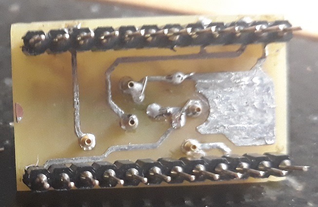

Sorry folks I know this sort of thing has been covered here but I cant find anything this specific, I purchased this little drop in replacement for the filter chip but I would love to know what it does exactly, I asked the vender and I didnt get a very good response, "it reclocks and buffers the signal and sounds amazing" So I took it apart and drew the connections, I know its a Flip Flop and an Inverter/Buffer but can anyone with experience here say if its actually doing any good? Ive been reading about DEM reclocking and the mighty NOS thread for a while but my head is spinning. :scratch1: When I started the thread title one other thread popped up about the 74hc175N but had never got answered.

Would this circuit merely sit as a satellite board on top of the main board, and be inserted, leaving the SAA7220 and TDA1541 in place?
From what I understand it's a way of using the additional IC's flip-flop and resynching the crystal oscillator to give a much stronger connection.
It's a reclock without having an addditional 11MHz added like some suggest, and also NOT have the NOS modifications done.
Basically just to synch things up and reduce the jitter, from what I see?

I thought of buying one of those but they don't appear to be on sale on Ebay any more, as I want to try NOS out on an unmodified player before deciding whether to go that way in any of my modified ones. I thought I had figured out the connections but looking at the Ebay photo which is still accessible the connections from pins 9 to 12 of the 7220 don't seem to make sense, it may be that there appears to be connections in the photo when there are not.
I have one of those Reclock chips...works great until it eventually starts making noises in both channels...went back to just NOS jumpers for now. May need to re-solder all the connections maybe

I re-soldered all connections on mine, but still has problem after DAC is warmed up. I noticed if I put my finger close to the Left side of pcb (Pins 1-12) i can get sound to distort without touching any pins...all connections seem solid...
Thinking of putting a blob of hot wax on left side, and then attaching a copper tape on the left edge to act as a shield?
