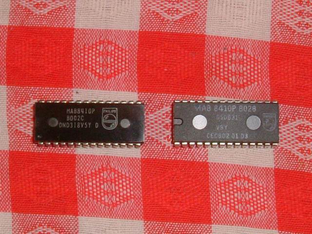

Here is the pictures of this chips. The left one ,which is from my cdplayer, very hot and 4.4334MHz clock not working .
Replaced with one on the right side in the picture. The clock is working now but I am not sure if it is right version that you mationed above.
The eye pattern is ok but the mute control bit of mab8420 not relaesed .
The player can't read TOC of the disc and tracking its way to the end of disc and starting from begining again,no data to saa7030.
Should both MAB8410 and MAB8420 be same version? Waht is the version mark on the top of the chips ?
It seems that only if same version can save this cdplayer .
Any suggestions?

From what I remember, it was about 15 years ago, the type number is something like;-
MAB8410-162
The "162" is the version number. I think they may be mask -programmed devices, ie programmed during manufacture. They are crude compared to modern PIC or AVR chips.
It is important to seperate devices by function. Controllers that control the laser pickup may be interchangeable, I successfully replaced one with a different number and it worked ok. Manufacturers add new features to their latest products, but the essential features remain the same. A controller from the keypad/display section will not work in the laser pickup section. Philips used several of these in one player, each controlling a different function. You need to replace the damaged chip with one that has at least the same function, even if the program number is different.
Hope this is even more helpful.:)

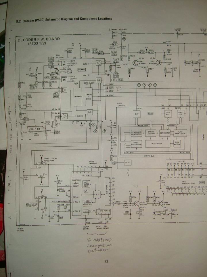

In the schematics this MAB8410 is for subcode decoding,audio output relay control and data to MAB8420(laser pickup control).
If someone knows the chip's version or old cd-players ,working same function as this one. I will try to find the chips or old cdplayer with the chips.
