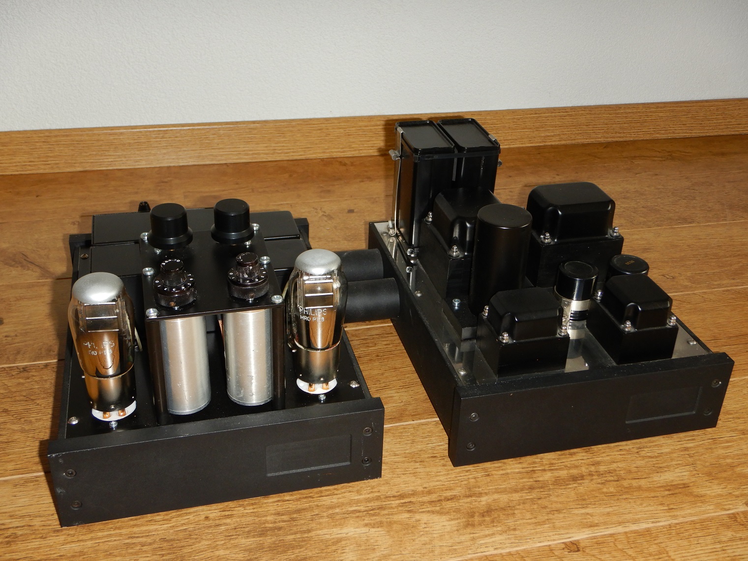

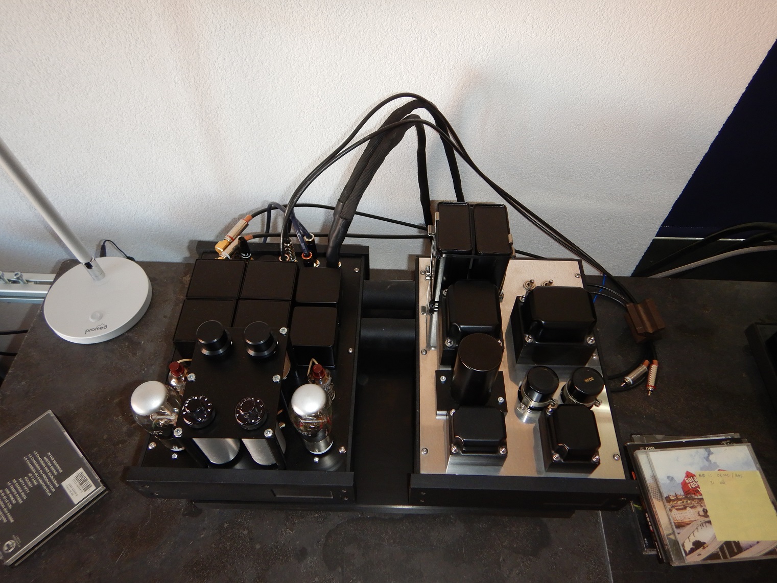

my new preamp is just finished and i'm really happy with the results.

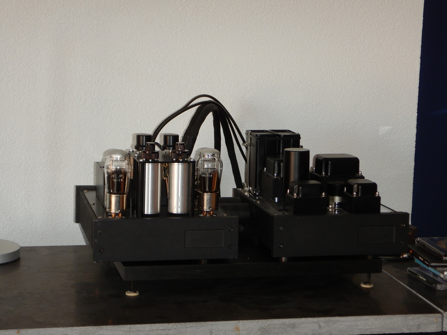

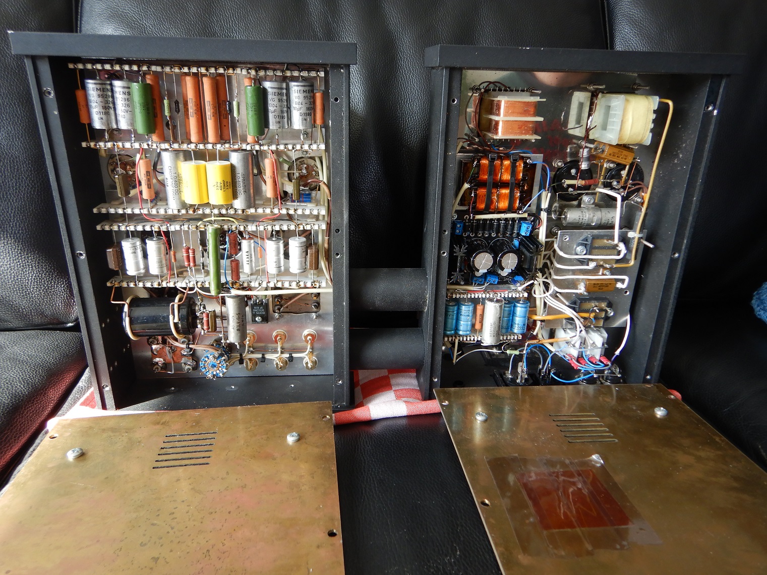

Some years ago i had 2x EL82 poweramp monoblocks but although good sounding they were not to remain. One of the monoblocks was rebuild to a 6C45PP SPUD-amp and the remaining chassis/monoblock was the basis for the new preamp.

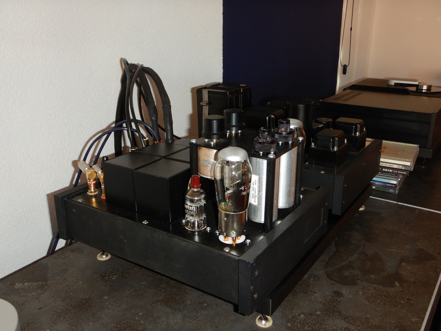

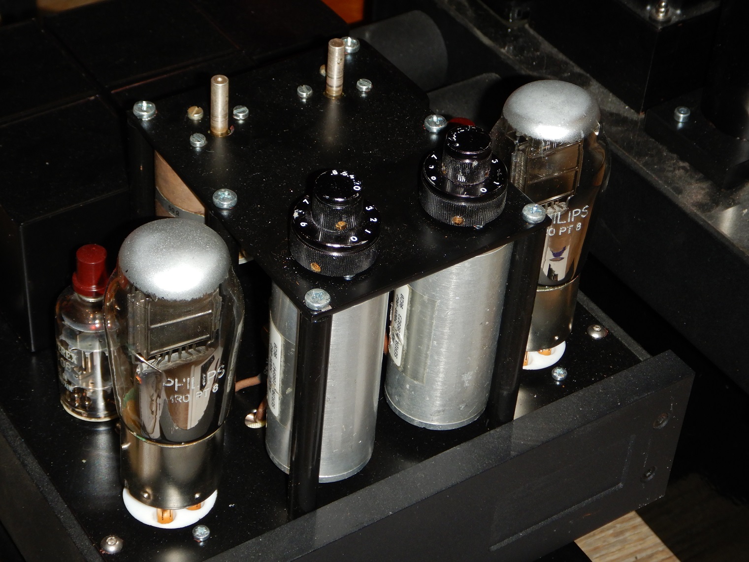

This new preamp is in essence a Kimmel-/Mu-stage preamp with a Philips MRO PT8 as "bottom tube" (voltage amplifier) and a Amperex 8608 penthode as "upper tube".
The volume control are a couple of step attenuators from scrapped (Rohde & Schwarz) measuring equipment. Each channel has 2 attenuators:
- one of the attenuators has 6 steps of 10 dB;
- the other attenuator has 9 steps of 1 dB and 5 steps of 0,2 dB.
More than enough options.
The power supply is completely in a separate housing but fixed to the audio-housing. One of the connecting tubes is hollow; here is the cabling between power supply and audio part of the chassis.
In one of the pictures you can see the PT8 preamp next to the 6C45PP SPUD-amp. Same chassis but the one with the bigger tubes is the preamp…..fun.
You don't see MRO PT8's in abundance but many manufacturers produced equivalents as these repeater triodes were quite common decades ago. The 4 volt 0,25 filament already indicates that it will take some time to heat up. Correct ! It functions within half an hour; it performs in a hour.
STC 3A/107A, Standard Electric 4019A, WE 101L and Philips 4609 are equivalents.
What does this preamp bring: amazing soundstage ! My trusty 20 years old Gryphon XT-MC has seen many competition last years but always came out as the better performer. Till now.
From sweetspot to sweetroom ?!
Although i have some PT8's in store it's time to look for 4019A's, 3A/107A's, WE101L's......so if you have those i'm interested.
Keep showing all your interesting projects on this forum. So many interesting items to see.

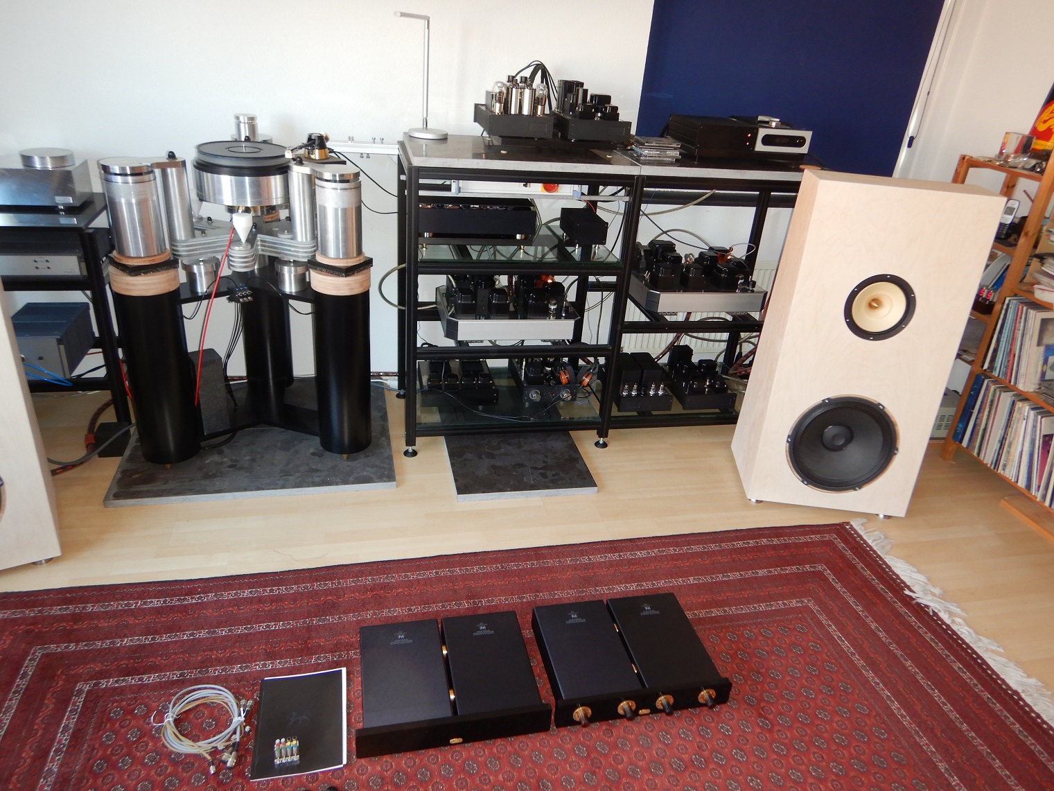

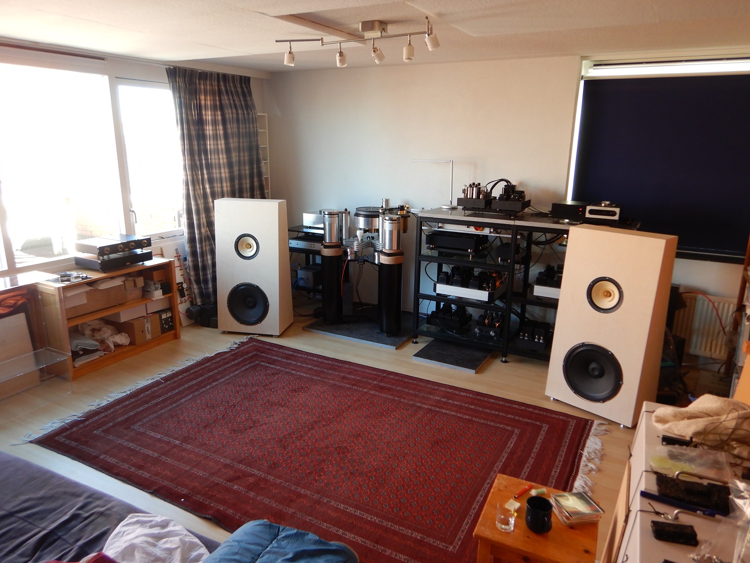

Good afternoon Esteban,
The mid/high is done by a Feastrex-unit: the D9NF.
The low is done by a Fertin unit: 38EX (field coil)
Description of the speaker-project is to be found here: FAST / WAW with Feastrex D9NF and Fertin 38EX
Very happy with the result. Currently i ran these with my 35TG amplifier as the really big amplifiers were swapped for an interesting turntable. The 35TG pushes out 10 watt which is more then enough.
Regards, Reinout

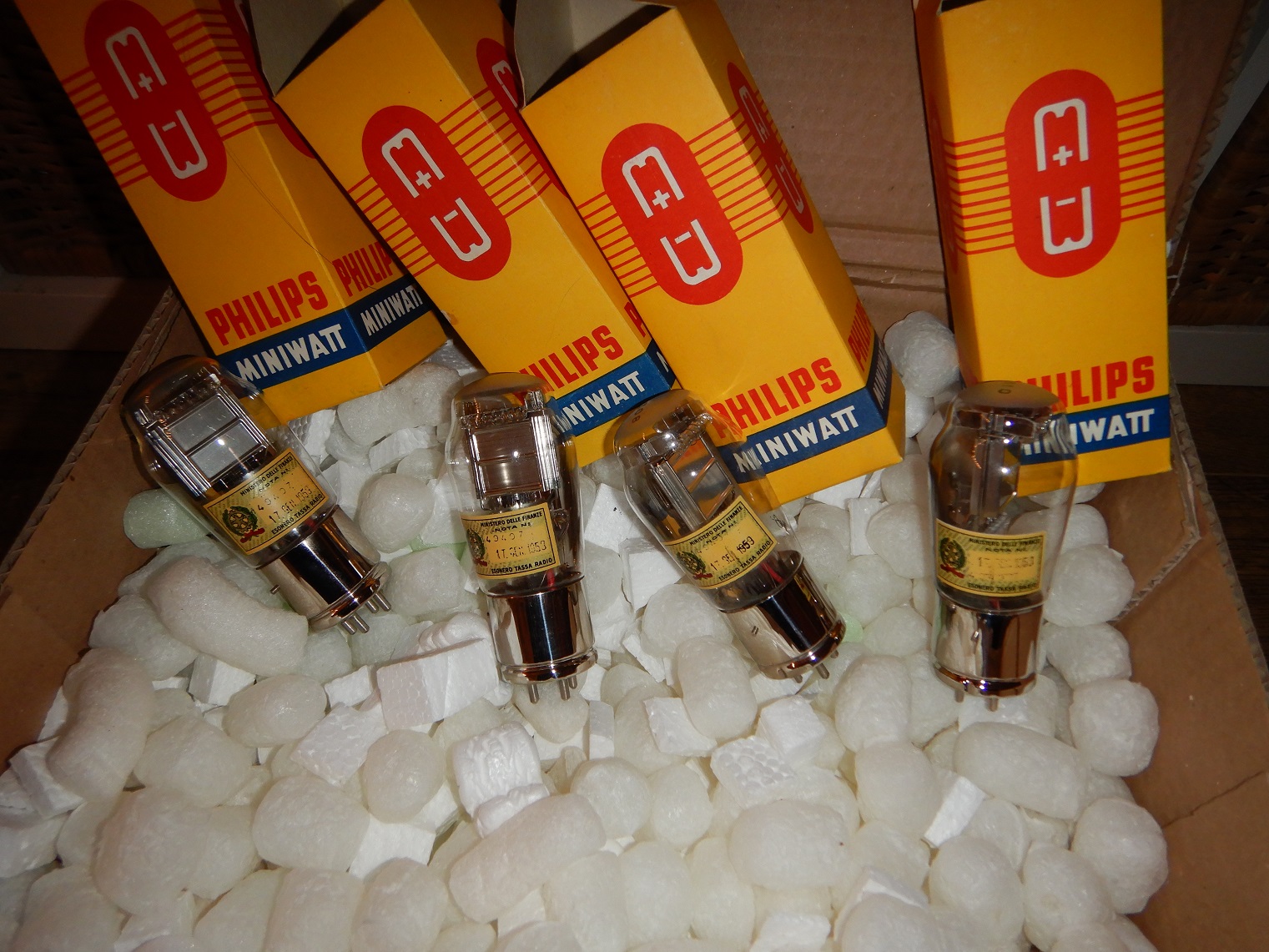

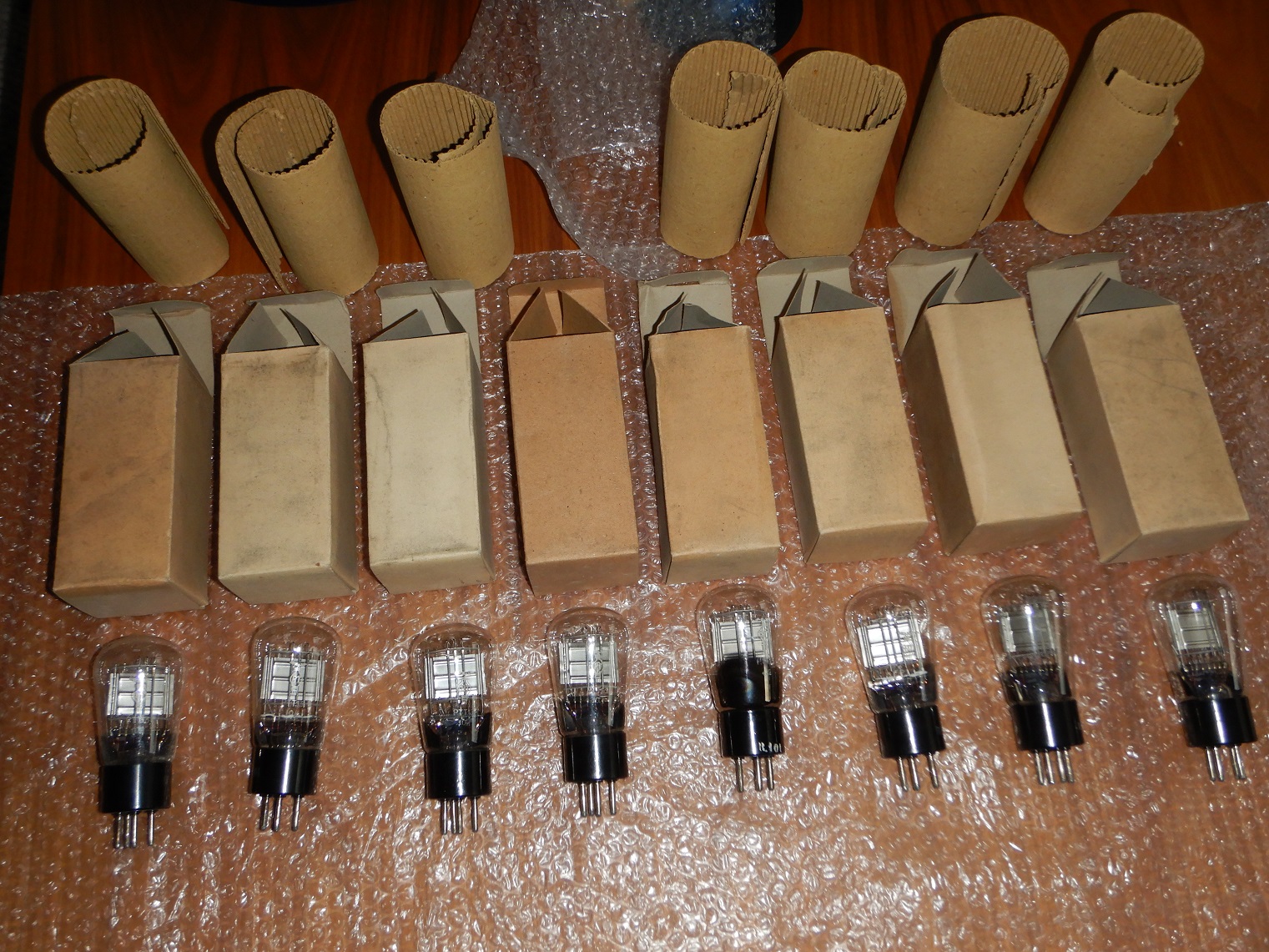

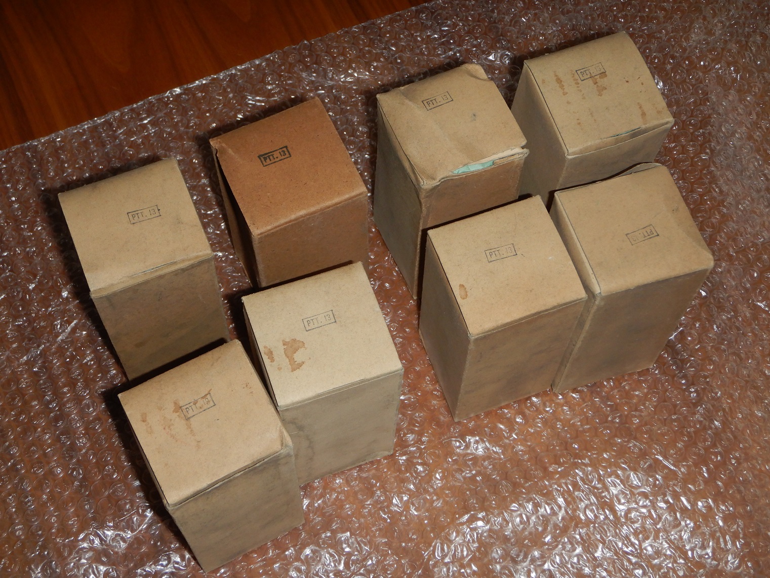

Christmas present !
Today the postal services handed over a package from Vint'Elec ( Vint'Elec ). No experience with that firm but at their website i found the PTT13 which is a direct replacement in my PT8/4019A/PTT13 preamp.
They had 8....currently zero as i bought them all....sorry.
The package arrives; all tubes were serious well packed so the first impression of Vint'Elec is a good one. Not for free; but quality ! I like that as these tubes are almost 100 years old so they simply need correct handling.
These triodes are 10.000+ hours tubes so with this stash i have my life stash covered.....
Christmas arrived early this year ?! 8 pieces of PTT13 in perfect condition; fantastic !
Merry Christmas and a wonderful/healthy 2021.
Reinout
