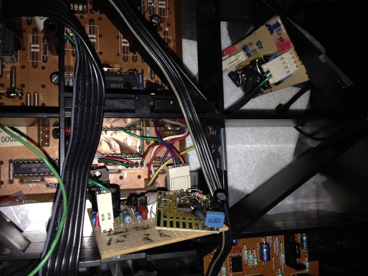

It's here (you'll have to go thru it):
Help identify diode! - Page 1
I still can't believe you ate up all this bandwidth and time of the generous experts here and never mentioned you had DIY perf board circuit mods, hanging by their wires, that took a ride through the fall.
Hey, bellz... I'll let you reply to that:
"Conspiracy theory" ... yeah, that's it. You betcha, toots.
Have to agree. We were short-changed on information that was relevant.
Those modules were unrelated to the spinning issue. Introducing them into the conversation would've complicated things: introduced wild, pointless tangents. Not that you folks didn't come up with many.Did you post this pic on this thread? Have quickly scanned all 8-9 pages and don't think you did.
Might have helped us if you had.

Nota Bene: the guy at the eevblog nailed the noise issue BEFORE that image was posted. See the eevblog thread 😉
IAC, the CD60 experienced multiple issues after it fell. The main one being the subject of this thread.
