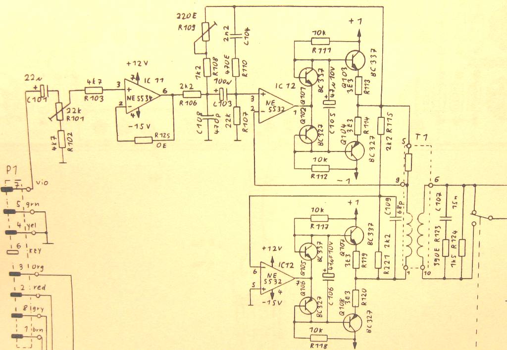

You are correct, the board I have is from a Studer A725, schematic is very similar to the output of the Philips LHH2000. I'll take a photo of the board and post it in a day or so.

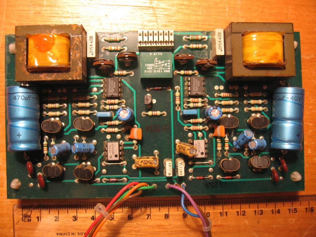

Here is a pic of the output baord from a Studer A725, this player used the tda1540

I would say, remove the opamp, put in a socket, solder on a socket a THS4032, cool it with a small aluminium sink (with cyanoacrylate glued on) put this smd opamp in the socket, and enjoy your 14 bit downsampling machine. The THS can run on +/- 15V max prepare on that. But you will be astonisched. For coupling cap remove the lytic and wire from the on pcb tracks a motor starter cap from around 5.5 uF.
