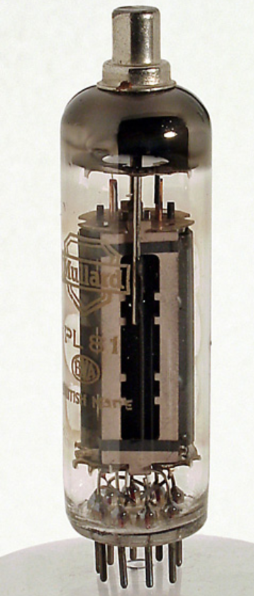

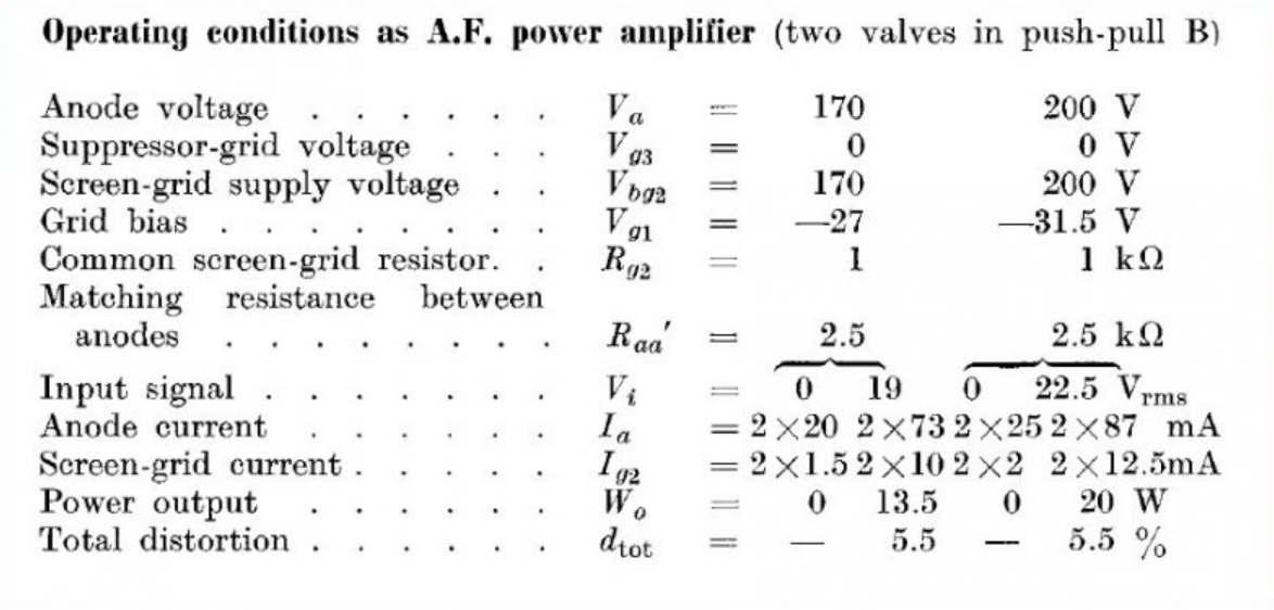

Merits of the EL81/PL81
What is the view on the EL81 as an output tube? This is just about the only application I have seen, and they are common and cheap. Is it the top cap that puts people off?
They have that strange ceramic plate on the side, presumably for cooling, and ex-TV ones can look a bit unappealing, with brown stains from being used. Is it a cosmetic thing that makes them not popular?
The "ceramic" is glass insulation I think so that it can withstand upto 7kV of kickback on the anode.
Its optimized as a line output for TVs, ie drving a flyback transformer.
Yes, and as with almost any sweep tube, they aren't really suitable for AF SE applications.

they are performing quite well in this phillips amplifier... like most PA the sound is not perfect but I think it is more due to the design tradeoffs than the tubes themselves
and at nearly 40 watts for two pairs this is not that bad
I think the sound quality is due to the OT, which is mediocre, at it's best. Don't forget that Philips never intended this device for home entertainment, not to speak of HiFi. Same with EL6425, the »typewriter«.
