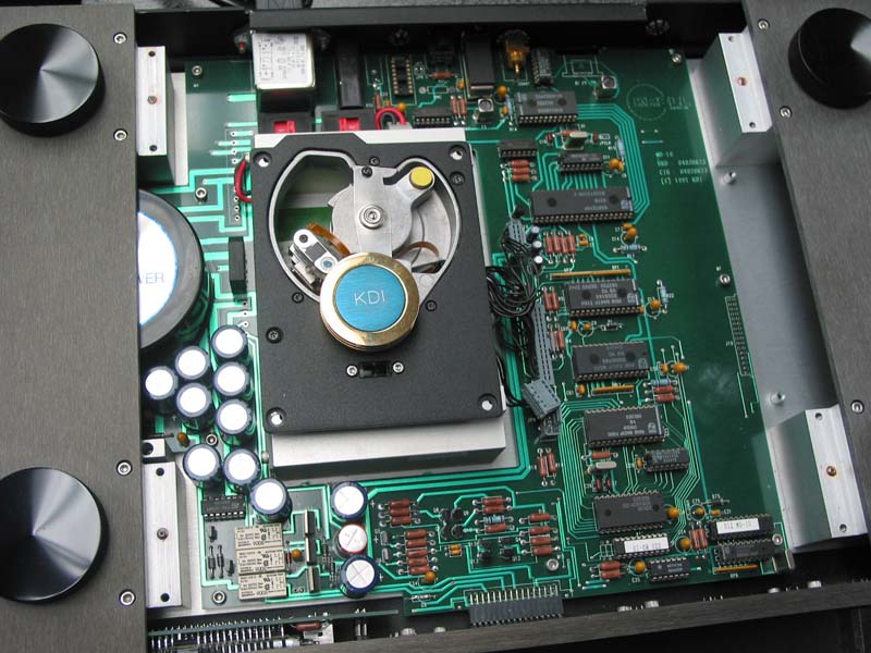

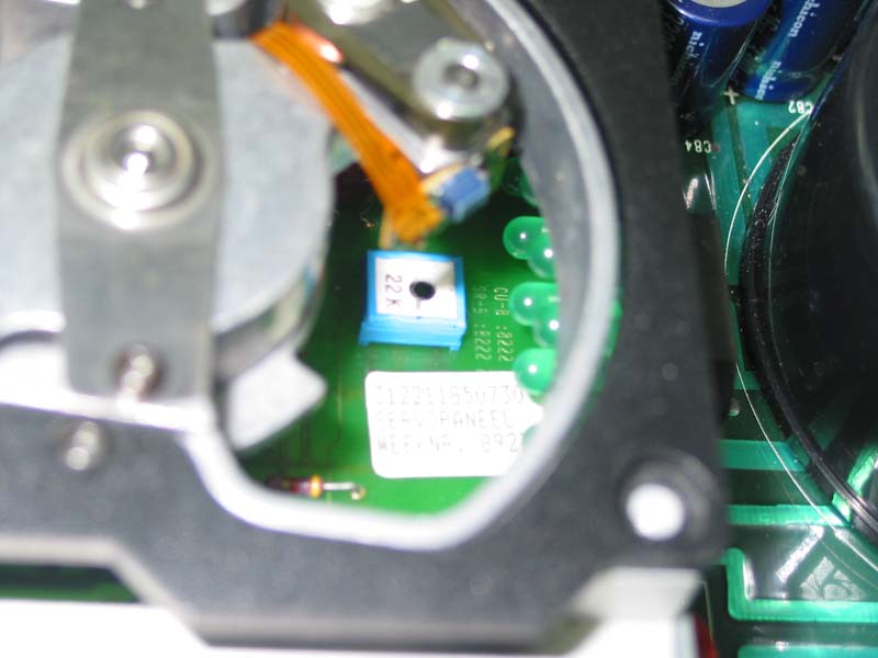

I have a Krell MD-10 wich I bought in 1994. The unit could no longer read disc's so I contacted Krell for service. I was informed that parts were no longer availible and they could not help me. I then brought the unit to a local technician who found that the laser had no output. Thanks to a DIY member I had the laser replaced. The technician said the laser now has output but the unit does not work. He says there are 4 adjustment pots on the board. He has contacted Krell for information but they say it is against company policy to give any information. I would like to ask for help if someone can give electrical specs for this unit. I have some numbers from the drive. I will try to attach photos.
These are off of the CDM3:
4322 010 7911
W01 925
31211850 960
7543
A00 8931
This number is from the board:
312211850730
servopaneel
weeknr. 8927
