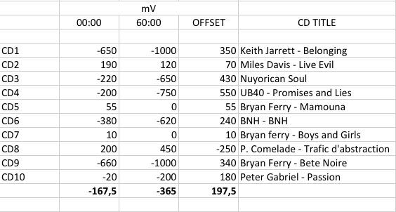

How many different CDs did you use to align the swing arm? The reason I am asking is that there are large differences among different compact discs, not only in offset amount, but also in direction it goes - from plus to minus voltage and vice versa. Therefore, using only one compact disc is not enough. Attached is the screenshot of the table in which I measured and recorded offset data of randomly picked pressed discs from my shelf.
My description of the entire procedure, why you should use more different discs and how to calculate the mean value is described here:
http://www.diyaudio.com/forums/digi...ps-cdm-1-swing-arm-alignment.html#post4010679

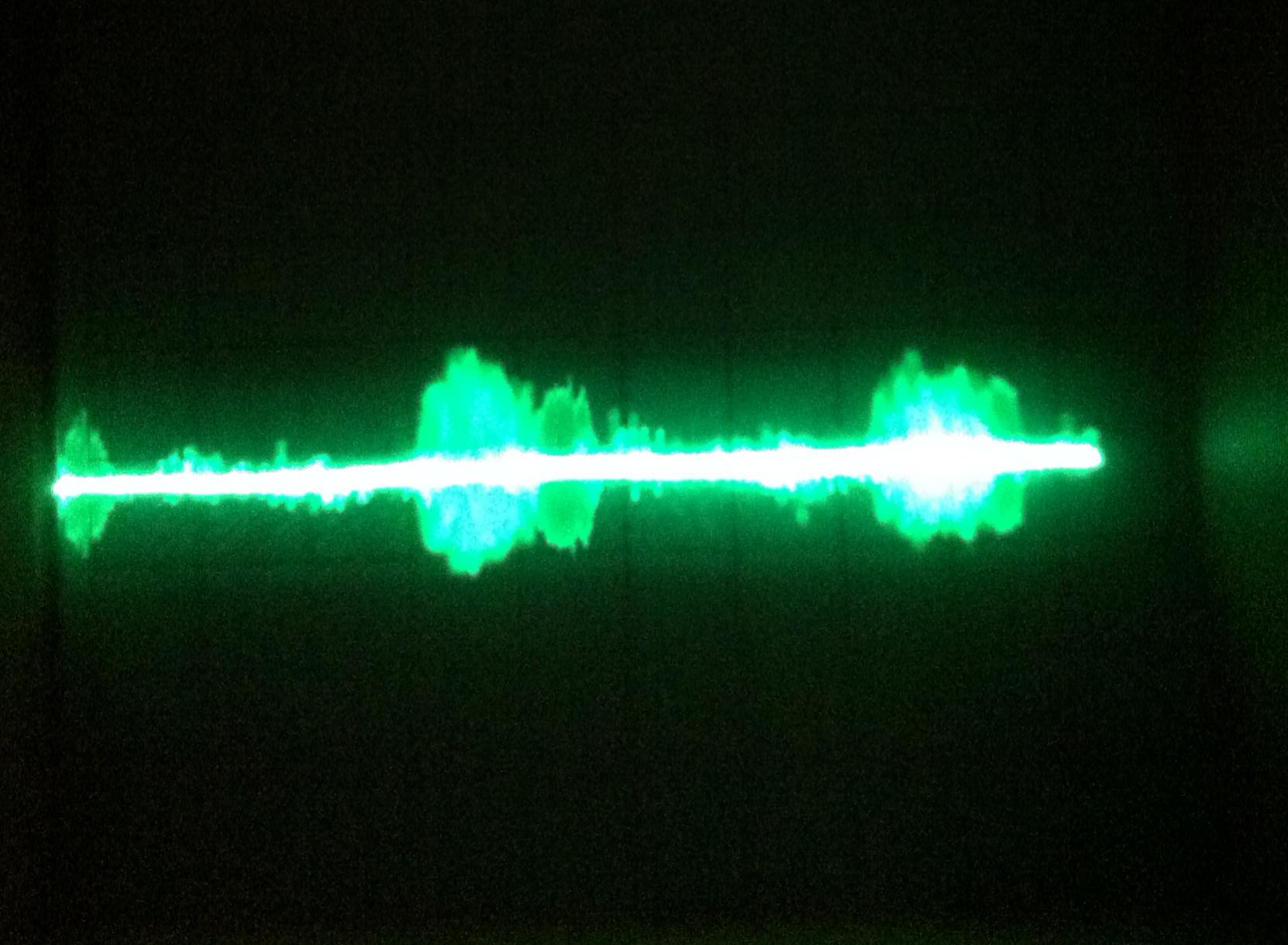

Managed to attach a scope:
No change in the amplitude of the eyepattern thus I assume focus and laser are working.
But the eyepattern is very blurry. Disc Motor is strong an cannot be easily stopped with the finger

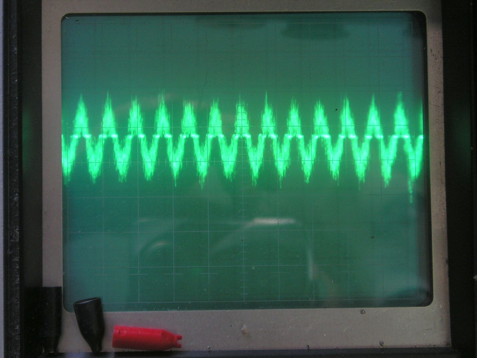

Made further checks today:
A fine tracking signal for the radial servo seems to miss or is distorted.
It can be measured @ point 30, pin2 of IC6218.
In the service manual, this signal is not mentioned, a participant in a german forum pointed this out, the left picture shows how it
should look like, X = 2ms/div ; Y = 50mV/div.
What I see on my scope is shown in the right photo.
I also replaced the CDM-1 of the CD 304 with another CDM-1.
The problem persists, thus the fault should be on the servo board; parts of the DAC board process the servo signals as well.
