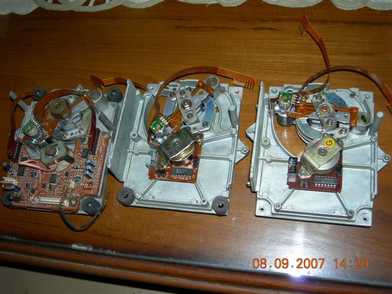

CDM-1 manual adjustment
CDM-1 adjustment is very complicated especially when the 3 trimpot has been moved from its original position and the more worst case when the optic has been unscrewed or moved from its housing - because it was set with special precise tool at factory. However I was able to manualy fixed it again after long .. long time in my two units CDM-1, by trying to move it in its position with a very very small fraction. The Philips CD304 and CD304 MKII now well working. Herewith attached my 3 units CDM-0, and CDM-1.
