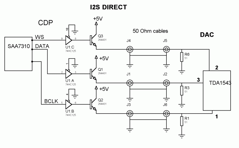

Re: I2S Direct
Hhere is the schematic I am currently using.
Three 50 Ohm coax cables are used between the CD-player and the DAC. Connectors should be 50 Ohm too. 0.1 µF Bypass caps on the logic IC and on all the transistors are not shown for clarity as well as ground and supply connection on the 74HC125.
The 51 Ohm resistors double as emittorresistors for the transistors as well as proper termination of the coax cable.
Scope shows clean waveforms for all three signals which can not be said for direct logic drive of simple unshielded leads.😎

I2S Direct
Hi Andrea,
Great you got these players!
Of course 75 Ohm coax cables can also be used. In this case use 75 Ohm connectors and chassis parts like BNC-75 Ohm or F-type connectors and use 75 Ohm resistors.
I was planning to use the Lemo Camac sytem with the 50 Ohm cables Mark Levinson was using in the eighties. It are nice thin cables that be easily bundled to one, and I have a large bunch of them. Still waiting for the parts!😉
[Lemo series 00 (NIM-CAMAC) can be used with RG58C/U, RG174 A/U, RG178 B/U. I guess the Levinson cable is the RG174.]
The signals WS, BCLK and DATA are best taken off at the digital output IC PCF2705P at the component side of the PCB. For the latter:
Pin 1 = WS
Pin 2 = BCLK
Pin 3 = DATA.

Re: Re: I2S Direct
Hi ELSO,
The capacitors are "between" the SAA7310 and the logic IC and,
"between" the logic IC and the BJT ?
Elso Kwak said:0.1 µF Bypass caps on the logic IC and on all the transistors are not shown for clarity 😎
Hi ELSO,
Re: Re: Re: I2S Direct
Hi Stefanobilliani,
No, no, no...... I meant powersupply bypass caps. 0.1µF from the +5V supply line to ground as close as posible at the logic IC and the transistors.

stefanobilliani said:
Hi ELSO,
Hi Stefanobilliani,
The whole scheme is direct coupled.
