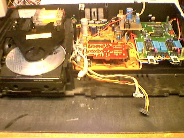

Another 650 pro: the front is easily removed for better access.
You need to do this anyway to slide the main pcb out.
Picture with mainpcb with processor pcb on the left, my dac on the right with the display PS above on the small pcb.
GuidoB
