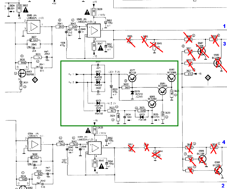

Ok, I've got the service manual and I remove the pcb (the cd473 has one big pcb, everything on it).
It looks like Philips changed its mind a few times when designing it. The service manual doesn't match the player on several details :
The service manual shows a fixed output, there is none on the cdp, only a variable one.
The volume control circuit is different.
They brought one of the output of the TDA1541 to the I/V stage by a wire and manually destroyed the corresponding pcb track (factory made, the wire used is clearly the same).

hembrow : out of curiosity, how was your volume control board ? Did it use a NE5532, a pair of MC14051BCP and 4 muse caps ?
I've not taken the board out of the player to look, but 4051s and a 5532 definitely sound right. The board was mounted on two plastic pillars upside down above the main PCB, and as a result, the back panel left and right outputs were upside down too (right at the top instead of more conventionally at the bottom).
The 4051s are used with a load of resistors to provide 8 levels of attenuation.
I didn't much like the idea of the sound going through the 4051s. The TI CD4051 datasheet says they add 0.12% - 0.3% distortion all on their own. The onsemi MC14051 datasheet just says 0.07% of 2nd harmonic (not mentioning what other harmonics might be doing). Either way, this seems not really quite like hifi to me. We really don't need the extra NE5532 opamp, either. It's only there to put some oomph behind the output of the 4051s.
Something I forgot to mention about removing the volume control board is that you also automatically lose the muting transistors as that's where they are in this player. The presence of the board makes tweaking this player much easier than most, as it's so easy to remove all this dodgy stuff. You just pull a connector off.
I took my output from the pads on the main board near the connector for the volume control board. This means you can choose your own output impedance. Rather than 0ohm (I was concerned that my opamps might not like that if the output was shorted), I put 20ohm resistors in series with my DC blocking caps. Quite a bit lower that on the output of the volume control board so it should make the signal more immune to what follows.

Yes, I noticed the muting transistors were there; I suppose I can now remove also the whole muting circuitry which isn't on the volume board. It is shown on the pic below. In the green rectangle what is on the main board, crossed in red, what should have been there for the fixed output and never was installed. Pads and holes are there on the pcb though. I will remove this circuitry to get access to +/-19VAC, to power a discrete I/V and buffer stage instead of the opamps. The opamp +/-15VDC supply will be used for the TDA1541, to reduce interaction with the digital supply.
