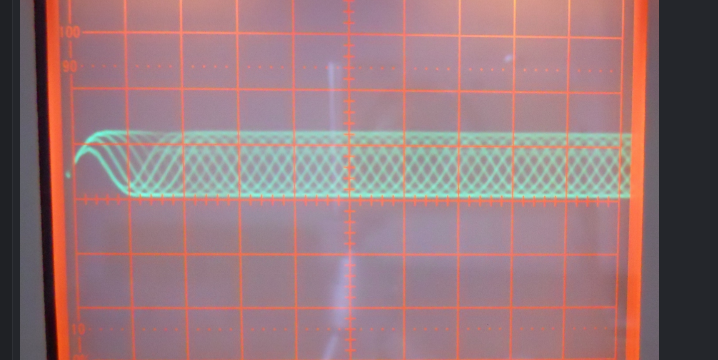

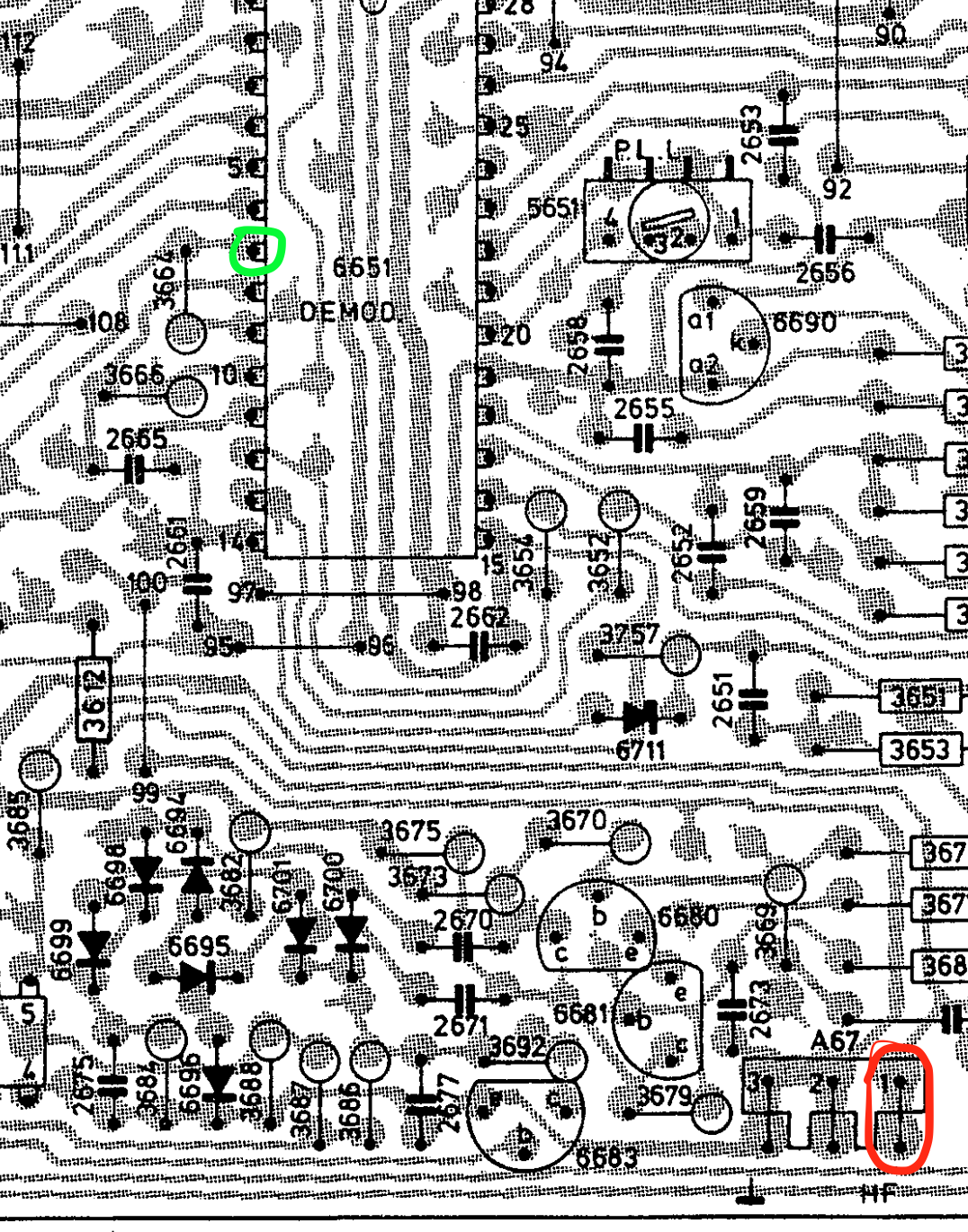

Already fed up with the situation, I took a plastic probe and, while the player was running (after readjusting the focus), I started gently touching all the components one by one, slightly moving them to see if anything happened (I'm talking about the components on the CDM0 board). Then, as soon as I brushed against a specific component, the player instantly stopped working. I didn’t even move it—just touched it!
Looking closer, I realized that it was a capacitor at the very beginning of the HF signal circuit.
Here is a schematic picture:
The capacitor in question was 2110. One of its legs (marked in yellow) was barely touching the leg of capacitor 2111 (marked in red), which seemingly caused a short circuit (indicated in green). This short affected the base of the first transistor in the entire HF signal circuit.
My assumption is that the capacitor legs were close enough to create a random short circuit depending on conditions like ambient temperature or slight vibrations.
The key question is: Do you think a short circuit like this could alter the behavior of the focus correction circuit?

I simply corrected the capacitor because it was bent too much towards the other capacitor. I just pushed it slightly to put it back in the correct position. I had to readjust the focus, and now it’s working fine again. For how long? Haha.Well done, a nice fault 👍
The cap and the two resistors bias the photo diode array so focus would be totally out of whack as the biasing would be altered.

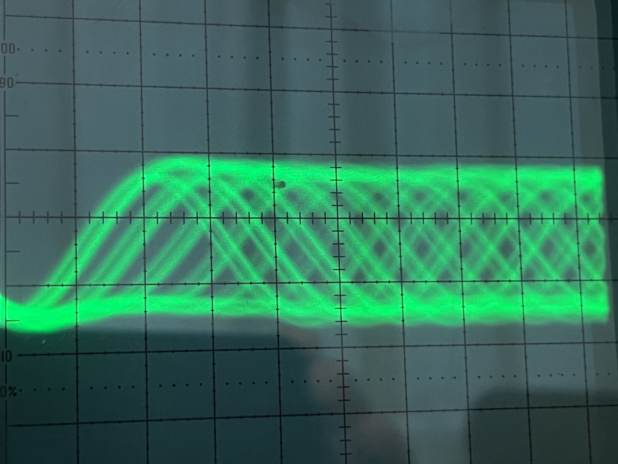

If it fails again, I’ll consider replacing the gain and offset potentiometers, as I can see changes in the HF signal just by touching them.
If you mean physically touching what might be 'open' pots then stray noise pickup would certainly effect things.
Finally, after spending a long time thinking about the issue and getting tired of not finding a definitive solution, I did what everyone recommends: reflowing the solder joints. That was the cure.
