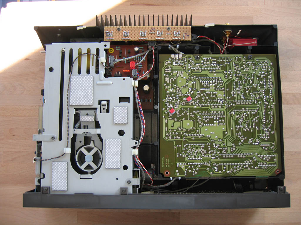

Hello tubee,
Not all voltages a regulated - between 45-1 and 45-2 you have got 2,3VAC for the display. On both of my CD204 I have measured 2,7VAC, while my CD304 MKII even has 5,4VAC (although the manual says it should also have only 2,3VAC). These voltages are directly proportional to the mains voltage.
But the main problem is with the regulators – their input voltage is over 8% higher while their output voltage remains the same. Therefore the regulator for -6V (6457) has to deal with a voltage drop of about 6V instead of 4,5V. And this is an increase by 1/3, resulting in higher thermal stress for the regulator and reducing its servicing life.
Best regards,
StefanAC
Best regards,
StefanAC

Hello tubee,
Best regards,
StefanAC

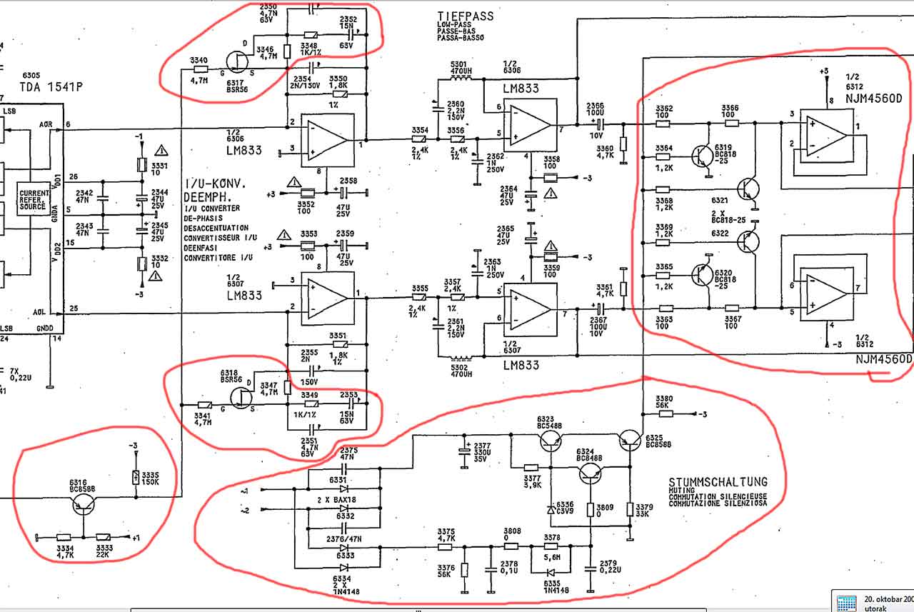

The caps should go to the MIB so I solder them in place of the last smd in each row. I don't count them and did not notice that on the mk2 in one row the last is 1cm out of place
The one down the MIB get the desoldered 220nF on top to double. The black at the MIB are 1µ Tantalums with the + to the ground as we expect -15V here.
For what do you think is the red marked smd's under the filter. I can't found them in the manual and i have them only on 1 from 3 mk2 boards. On the top they were connect with 1µF to the +5 at 7210. The otherside goes to the 7220 clock sys to 7210. There are still few further deviations.
That was surely not what I wanted. A 6db cut at something over 10k... First it increases the signal by 6 dB/oct at 3180Hz (50us) and than it decreases the signal by 6 dB/oct at 10610Hz (15us). By removing R3562 and R3563 ... creates a 6dB/oct low pass filter with a 10610Hz cut-off frequency.
I had a look at the manual and read that this circuit must be switching from 15µs to 50µs. I thougt the 15µ is given and the 50µs were switching by with the BSR56. That shows that I am not an expert in compute a filter. Rather in out-solder the filter
How do you think is it makeable to switch the De-em on and off with this given.
The red is the position of the socket for the switch.

After soldering back the R3562 and R3563 in de-em the first impression was that there a lot of "nos-sound" is gone. That is confirmed also while switching between OS and NOS the difference is much smaller. With switched de-em now from the blanket a towel became and the difference between OS and NOS is more less. That brings me back to my second idea.
With switched off de-em a 100% cut from the original de-emphasis for maximal NOS sound.
With switched on the original estate for less listen fartigue.
Now i agree 100% with that. The task is a compromise to find between maximally NOS sound and minimum listen fatigue. The possibility this filter switching by or not pleases me much.

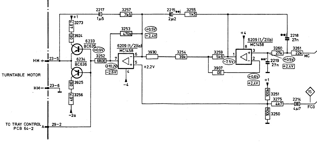

I still need help to get my CD204 MKII hybrid, a CD304 MKII with CD204 display, working. While I thought that the wrong value of C2219, which I changed from 27nF to 100nF by misjudgment, caused the problem, the exchange of the caps showed that that was not the case. The turntable motor still starts to spin directly after powering on the player and can not be stopped by any command.
Following that, I exchanged the servo board with the one from my other CD204. Both boards have the same MAB 8440P D041 installed and should function the same. The only difference is in the turntable motor control circuit – the CD304 MKII circuit looks like a cost cutting of the CD204 (or CD304) circuit. But the input and output currents seem to be the same.
When I switched on the CD204 MKII hybrid with the CD204 servo board, the problem of the constantly spinning turntable motor was solved. But I still could not make it play music. The hybrid reads an inserted CD and you can select a track, but on pressing start nothing happens. The CD instantly stops spinning. When you than select another track, the same happens. Any ideas would be appreciated!

That's what i try by removing the 3562 and 3563. But a switchable fs10k 6db must be changed naturally....the de-emphasis circuit ... it should be cut off from the feedback loop completely.
I measure at BSR between D and S switched 16,6Ω and unswitched ∞Ω. For the moment i leave only the 1k8 and 2n for I/U. The 3.order between first and second half of OP has gone also. Maybe i will try for that a switchable 6db low pass with 1k8 and 4n7 than after the BSR later....BSR56 must be closed, indicating an appropriate voltage on the gate
Offset correction was the first seen different between 304 and mk2 (471 don't have them) but it was not the cause. By solder them out did the distortions increase The only larger different remained was the 470µH in mk2 and 471 ... but not the cause. Building back till original estate brought no improvement at mk2Concerning the Bursons: Has the CD471 the same partial offset correction which the CD304 MKII has and the 14 bit player are missing? Or are there differences in the feedback loops between the 14 bit and the16 bit machines?
Than i test a 50Ω between DAC Out and ground and all distortions gone. It was a problem in I/U! But first the I/U and than a voltage follower was the reason to take an double Burson! I will try to variate the 1k8 in 3567 But after mounting them on sockets for crossover testing i notized that one of them ever more distorts. The I/U resistors are absolut identically. They do not seem to be so outstanding selected thus nevertheles. After a closer i noticed that the assembly with transistor types on both is different. I don't know whether like that be a mustI am not sure, but I think I read in a thread somewhere here on diyAudio that the Bursons are fine as a buffer but there seemed to be problems in I/U conversion.?

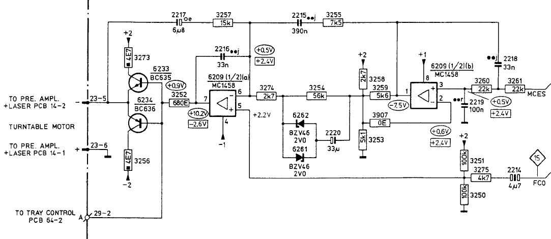

A view days ago i had similar problems and search me a wolf on servo and display board. The error lay then somewhere on the decoder board around the 7210. Maybe on the 204 decoder is something different to the mk2 wich cause the problem. Have a look at 33-1 till 34-4 there.

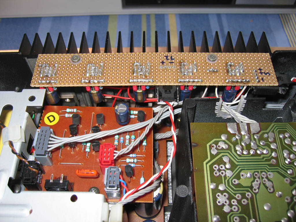

Hello Andreas,
Space is no problem for me as I only take a small scale approach – I don’t rectify the raw AC and use dedicated smoothing caps .
I take the DC right after the main caps (C2452, C2458, C2469 and C2476), use a 100nF Wima MKS in front of the LM317/337 and a combination of 100nF Wima MKS and 100uF Panasonic FC afterwards. With careful placing of the two resistors and the safety diode, I only need 6 by 6 holes on a standard PCB for each regulator. There is still enough space for some chokes though, which I should try to get some time in the future.
I know it is not perfect that way, but I get a worthwhile improvement just by separating the supplies while I still maintain a neat layout .
