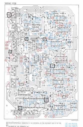

Q: I took a look at the servo board. In addition to 2 obvious solder hills covering griplets, I noticed that a couple of the axial caps and at least two wire links had large solder mounds at one end. Do these also cover griplets and should these also receive the treatment ?
See attachment. I think I have marked all the gripleta and through holes.
Andy
Thanks poynton, yep - those look like the ones at the ends of wirelinks and axial caps.poynton said:
Andy
There are also many on the decoder pcb. Have you done those as well?
Andy
Andy
Not done any yet, but earmarked for this weekend. Replace all on both boards.

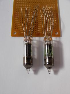

Is anybody interested to put tubes in the CD 104 analog output?
ampere said:Many thanks to Jonathan I. for the documents.

JeroenR said:email should be enaled now.
And... Tube output? Where? There's not a lot of room inside. 🙂

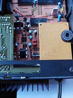

Yep , it is tight for space !!!
I will make a mock-up tomorrow and post the photos.
Andy

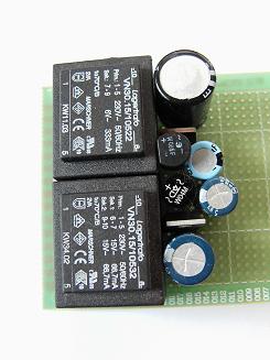

OK - I have cheated a little but it is possible ! ( for one thing, I did not build it!)
Using circuit similar to :-
http://myweb.tiscali.co.uk/nuukspot/decdun/cd723vosdiagrams.html
Or the web page above,
The board will fit under the Decoder PCB - over 1cm of room - on stand offs fixed to the ground plane. The largest component is the output cap but that depends on your choice.
If the opamps and associated components are removed, you get more space. As the output muting is by relay, I am in 2 minds as to whether they should be removed or not!
Obviously, the existing output cable will be removed and replaced with Quality sockets.
Tube Output for CD104
The power supply will have to sit outside at the rear in a platic box. It may be possible to fit the regulators on a small board inside.
