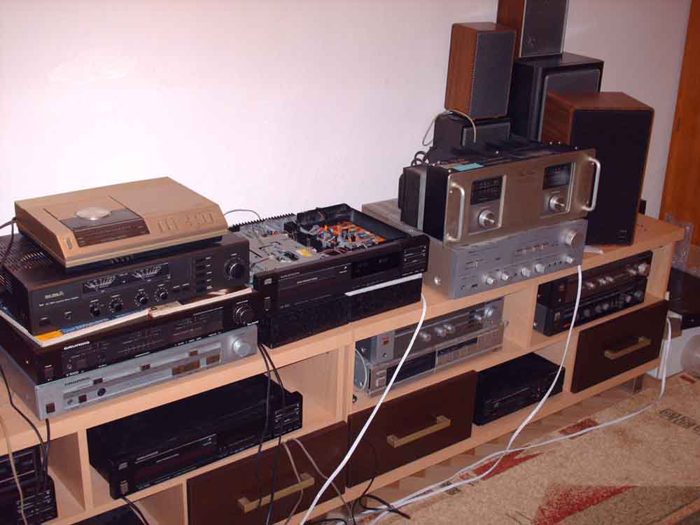

I compared all models of Philips. Model is to five versions 104. Model plays 304 three versions. Model plays 100,200,202,204,300,303,304, 150,350,.Marantz cd63, 73,74,84. Grundig cd7500.7550, cd35. Revox 225,B&O CDX. All 14 bits. It plays best 7550 Grundig. It plays natural sound. Most beautiful paint of instrument from mentioned models,.
