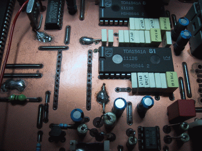

CD104 mod with 2 TDA1541a's
I modified my 3rd CD104 with NOS and 2 TDA1541A's
This time the decoupler caps etc are on the upper side of the
PCB. see attached photo.
(MSB=1mf)
On the saa7000 every decoupler cap (0,022mf) is parallelled with a 0,1 mf mkt cap
The data and clock lines go directly from the SAA7000
to the TDA1541A's with thick copper wires ( Including the groudline, I cut the lines on the PCB.)
In a former post I mentioned that I have replaced the output caps
with tantaliums. That was a big mistake !!
Now there are two 3.3 mf (MKT) parallel, and that differs a lot !!
(6.8 mf MKT were not available)
Again I compared this mod with a NOS mod and 2 tda 1540P.
And the difference is clear. The 2 TDA1541A sound nicer !
Is there actually somebody who has done this mod too ???
Regards to all
Onno
