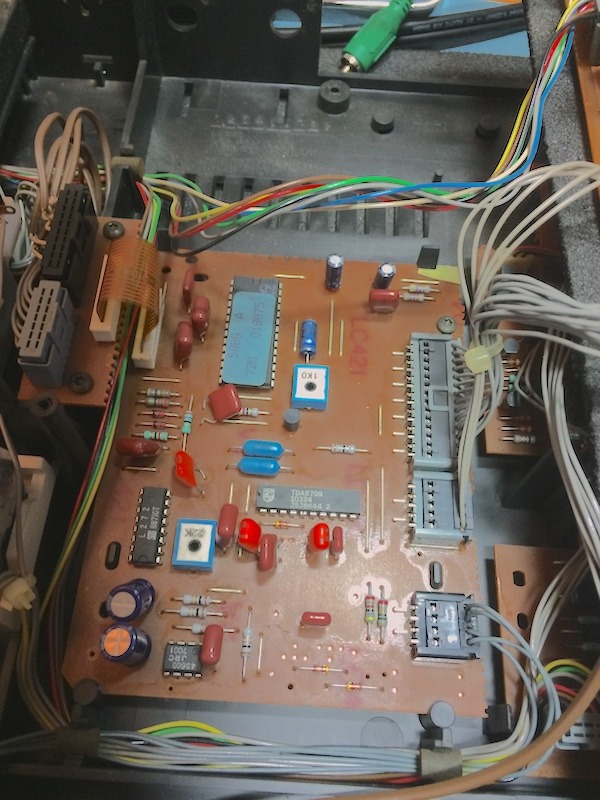

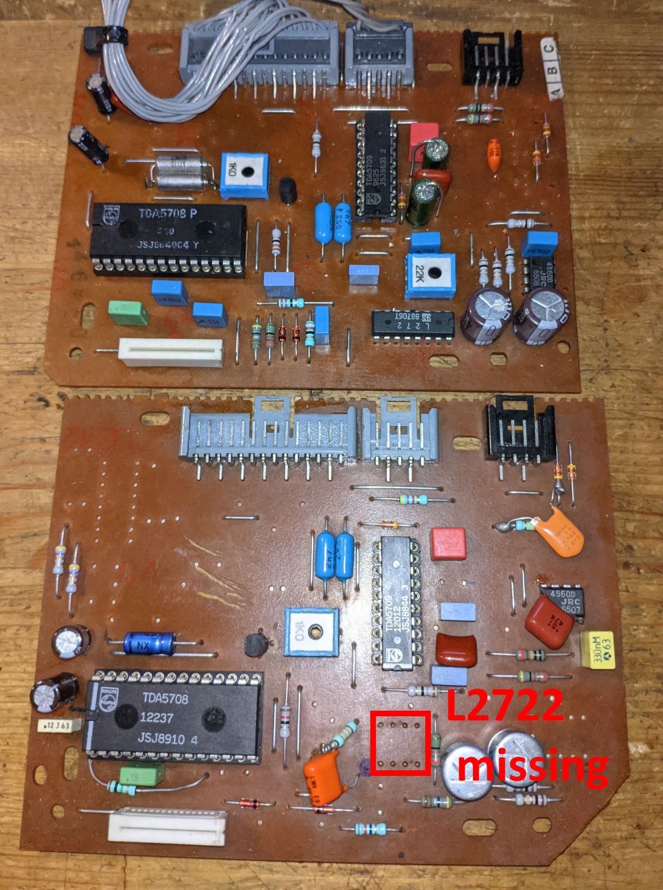

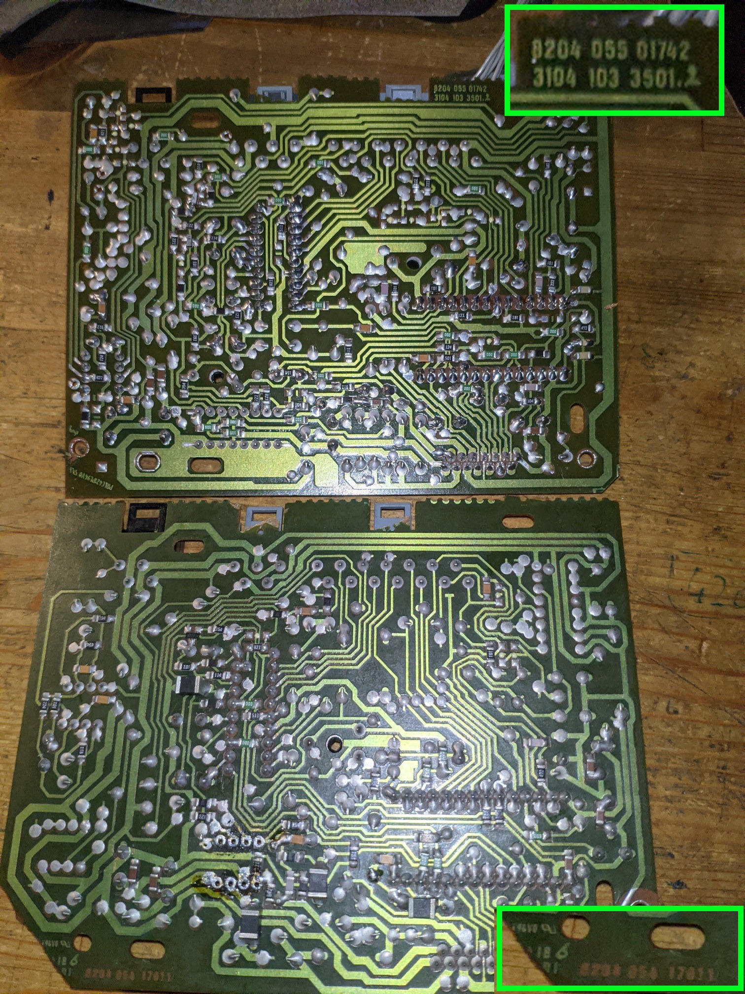

Philips CD Servo PCB "3104 103 3501.2 / 8204 055 01742" in which Models in use ??
I am looking for CD player models from Philips/Marantz, where the above mentioned servo unit is in use.
The only model, that I have found from Philips is the CD-670 - go to
http://egirland.blogspot.com/2013/03/again-on-philips-cd670-and-cdm2-cd.html
In the meantime I have find out, that this PSB's can be only recognized by the 4-digit number on the attached sticker mostly glued on the surface of TDA5708 and not by the above mentioned PCB numbers - check out the attachments in post #29 under
https://www.diyaudio.com/community/...that-use-cdm-2-cdm-4-transports.372412/page-2
Unfortunately from several PCB's sticker with this number isn't longer to find.
Thank you in advance.

Yes, exact this boards.
I want to have a Philips CD player equipped with this boards for replace my faulty device from my Micromega "SOLO" in a Philips CD Player for repair and maintenance (focus servo and laser power adjust). This isn't possible on the "SOLO" itself.
Philips CD640 is a good advice. Most models with CDM1-4 have the same circuit, but integrated on a main board,. i. e. no extra PCB therefore
Well, I have these two boards as spare, if you're interested => PM me.
