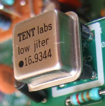

Hi Guido, finally see you but everything were done already. The SPDIF stream was extract from Pin 13 of PCF2705.
Just one more thing, can you check the XO in this photo is genuine or not, as the wording on it a bit difference from the photo on website
"jiter" instead of "jitter"
"TENT Eng" instead of "TENT ENG"
but I still can found 3 blue dot at the bottom of the XO can.

nice work, good to see all is OK. You may want to rotate the board over 180 degrees to shorten all wiring
The text on the oscillaters is a misprint from my Asian manufacturer, and Tent Eng(ineering) was my earlier company when I started this all. The XO's are in production for nearly 10 years now, unchanged that is.
