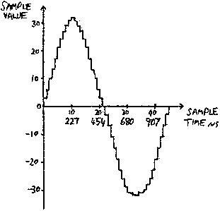

Figure 1: 1 KHz Sine Wave, -60db, 16 bit, 44,100 samples/sec
The output of the DAC (Digital to Analog Converter) in a CD player is not a continuous waveform. It has distinct steps which occur at the conversion frequency. A 1 Khz sine wave reproduced at a level of about -60 db uses 6 bits, and appears at the output of a DAC without over-sampling as shown in figure 1. Incidentally, the same wave at the same level coming off a Vinyl LP would be almost totally masked by surface noise. The Fourier analysis of figure 1 reveals a large number of extraneous high frequency components, which are sum and difference products of harmonics of the 1 Khz sine wave and a square wave at the sampling frequency.
Figure 2: DAC Output Spectrum, No Over-sampling
A signal with components covering the entire audio range (music) produces the DAC output spectrum in figure 2. It is fairly obvious that we only wish to pass frequency components out of the CD player which were originally encoded on the CD. Also, if any of the high frequency garbage gets into later audio stages, lots of problems will occur, such as instability, intermodulation distortion, overheating and damage to wide-band power amplifiers and tweeters. The solution is to use a low pass filter to eliminate all the out-of-band components, leaving the audio signal perfectly intact.
