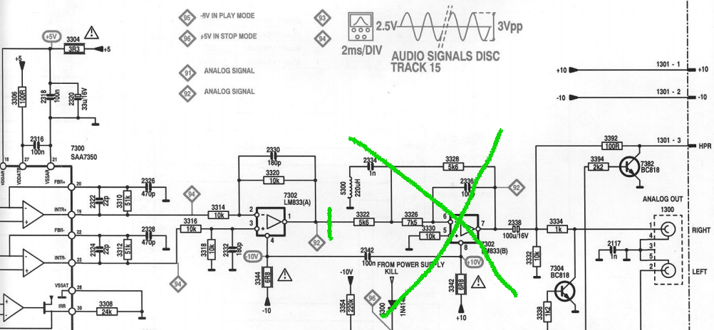

Right now I've made the output straight to RCA after the first differential OPAMP (half of LM833-N) - where the green line is - and the sound it's very very good. I guess the second half of the LM833-N is a LPF filter or buffer.

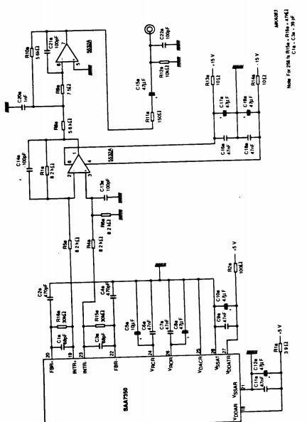

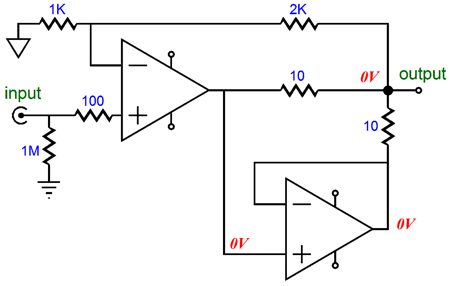

I'm a big fan of LME49720HA and I have a couple on the way so the next stage is to build an output stage around those. Should I just swap them instead of the existing LM833-N and use only half of each OPAMP per channel or try to use the second half in slave mode like in the second picture attached? The distortion should go down by a significant margin, what do you think?
The DAC is SAA7350AGP if I didn't mention. What does the 3318 resistor and 2332 capacitor does in the below schematic? It's a filter at the OPAMP input I guess, can I remove them? The 10K resistors (3314 and 3316) must be for level attenuation at the OPAMP input and should be left in place. Am I right?

Salut Matei!
I would suggest that you search for a direct replacement op-amp so that you keep the modifications to a minimum. There is no need to fit the second op-amp as slave as you call it. This topology only helps reduce distortion while the op-amp is driving really low impedance loads. That is not the case here and will only cause more harm than good in my view.
After you have swapped the op-amps and have checked that they do no oscillate ( you will need a scope for this ) you can try to remove what appears to be a mutting transistor ( 7304 and 7382 BC818 type ). Ther eis a possibility that without these in the circuit you will hear some pops while changing tracks, stopping, pressing play etc. See how that goes.
Another step would be to change resistors to thin film type 0.1% and film caps.
Best of luck.
Yes, it is a modified Sallen-Key second-order low pass filter. I'm sure they only included it to avoid wasting a spare opamp. The passive components around it must have been going spare in their Stores Department at the time.
Maybe these too were going spare? Or perhaps the designer intended a low pass filter to prevent digital edges from causing slew rate limiting and hence distortion in the opamp?
I am puzzled how you can think it possible to improve a circuit which you clearly don't understand.
There's always room to improve and simplicity is the way to go. Thanks for the input but nobody was born a doctor in electronics, so we must learn 🙂
So I can get away with half of OPAMP per channel, the question is if I will get a better sound by not using the second half at all or should I use one OPAMP for both channels?
If I understand correctly the 3318, 2332, 3314 and 3316 can go? 🙂
All the components around the first opamp are needed if you wish to retain its functions, which are:
1. low pass filter
2. differential mode buffer
3. common mode rejector
Which of these functions do you feel you can discard?

It is reasonable to assume that the chip manufacturer's application engineers know how to get the best out of their chips, unless there is clear evidence to the contrary. I would start by fully understanding and analysing their circuit (and the similar Philips one). Only after that are you in a position to offer constructive criticism of it and suggest genuine improvements of it. That is my opinion.
I have given you a start by telling you in outline what each opamp does. You can continue by calculating corner frequencies; Q for the Sallen-Key; the effect of the added inductor in the Sallen-Key.
Alternatively, you can degrade the sound by cutting bits out or following the latest fashions in CD-player circuit abuse.
I don't really understand the practical need for a LPF filter at a Q of 85-90kHz (usual values) when nobody can hear above 18-20kHz. I see just added stages and more components in the sound path 🙂
