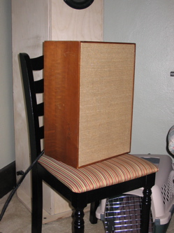

I found a nice pair of boxes at the thrift store yesterday, and I was happy to discover they have a pair of Philips AD3800AM 8" Alnico fullrangers in them. Luckily they are 8 ohm. It appears a bunch of these were 800 ohm. The cabs are really well made: 3/4 inch ply all the way around, except for a thin back, nice veneer, ultra cool grill cloth, fiberglass on the back and top. There is a big rectangular port in the front, also built from the ply.
They have no identifying marks anywhere. Were these packaged with some amp/receiver?
I've got 'em playing now, and they sound allright. You'll think I'm silly, but they have great PRAT. They have more HF than I'd expect, with perhaps a peak around 10 or 11K, as they are kind of sibilant. I think they extend quite high, though I've yet to test it. My guess is at least 15K, but they could be fooling me. I think they are done below 80hz or so. Midrange is fine, just not as pretty as I'm used to. They seem quite efficient. I bet they'd be perfect up against a wall with a little tube amp. I'm guessing the underdamped bass and very present HF make sense with whatever the intend amp was. If I get bored, I'll try some ultra thin speaker wire.

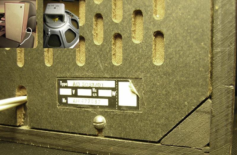

Hi PJ,
I have some readymade enclosures for these speakers.
It says AD5053 on the back.
The enclosures measure 40x20x15 cm inside. They were made in the early sixties.
Inside is an AD3800AM, the -A suffix means that this is an 800 Ohms unit, suffix -M means whizzercone
There is a 7 Ohms unit as well, it can be coded as AD3800M or maybe AD3800M7
I mate them with a 1959 Philips AG9015 stereo OTL Amplifier
Alltogether it gives a sweet and mellow sound, no bass to speak of but very enjoyable to my ears.

That is indeed the same driver. Those enclosures look aperiodic, which would make sense given my guess about the Q of the driver. Yours must be 800ohm versions huh?
The boxes I have are proper BR's, with a big rectangular port. When I open 'em up, I'll measure it. My guess (based on exterior dims and my quick view of the length) is that these are tuned around 80-90hz. I'm not sure if that is ideal or not. I've seen the Fs of these drivers listed as 72. I'm guessing the Qts is high, but I don't know if that means .7 or higher. I haven't any idea what the VAS is. I'm trying to figure out how optimal the enclosures are, thus why I'm wondering if anyone knows anything about them.
What do you think of the drivers?
pj
These units were also sold for diy purpose. Philips published several books on speakerbuilding. One of them is here:
http://mfbfreaks.nl/artikel/passief/2/imagepages/image1.html
When you go to image 12, the AD3800 is mentioned as well
That's all I can find atm.
I'm glad I kept these units, It is fun to play with them.
They work well on OB
edit: I just spotted an fr-plot on image 19 and a BR proposal on image 34
I had my speakers near the corners of the room for some usefull basslift, that was common practice those days anyway...

Wow, this is a blast from the past. I know the question wasn't for me, but the original box is NOT a good starting point: giant midbass hump, no lower bass. Truly Terrible. Besides, it's quite likely that the suspension is a little stiff and the magnet has lost some flux. Were I you, I'd either put it in an open baffle, or build a 50ish liter sealed box and stuff to suit. I've still got the boxes. If you really want to know, I can pull the back off of one and measure the port. I can't overstate how strongly I suggest trying something else though.
Paul
www.wildburroaudio.com
