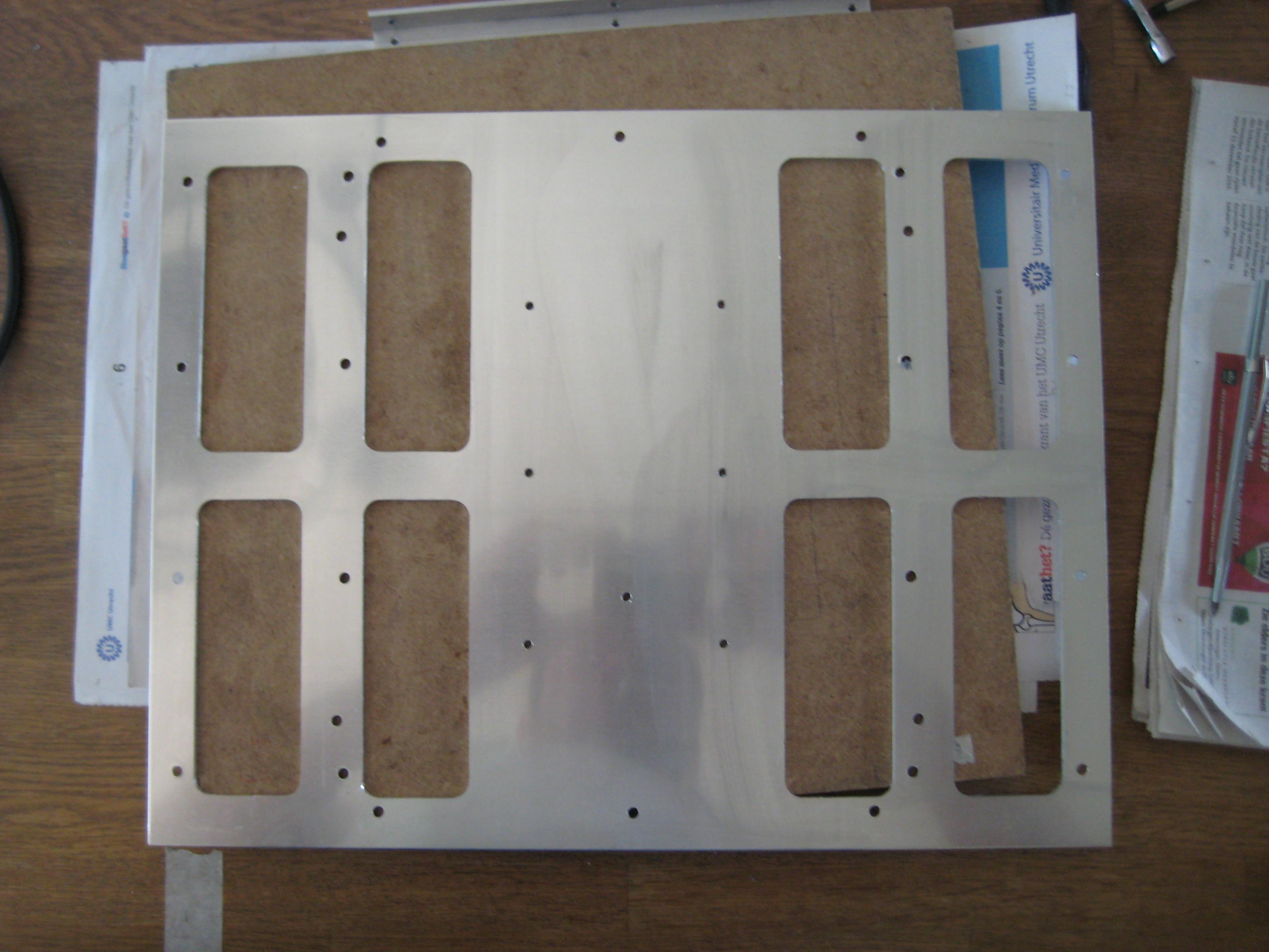

How do you get the alu ring? The colour looks (and feet) is great.

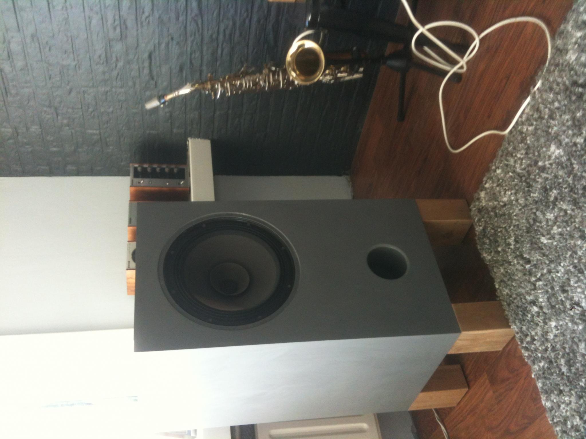

Like the cabs from what I can gather from the pics.
If you like the Philips drivers go with them (or similar) again. Better 12 drivers has not been made. Put a super tweeter on the back or front.
The drivers you have now might have been misused or been stored poorly.

I make the aluminium ring myself I use a simple (wood)router and the lowest speed and WD40 and some patience. The technique is the same as a wooden circle.

The amp I am using is the First One Module from Lazy Cat 230Watts into 4 Ohm. And yes I am using the 110mm tube with a length of 15.5cm and 1cm flare on the outside end.
As mentioned I loved my old drivers (in their Open Baffle setup). But that was to dusty and had an impossible small sweetspot also I wanted t build something. During that proces I killed my old units and bought other ones. They sound still great but very different. In this cabinet however the sound is bad. I learnt from someone who has ten pair of these that the all sound different.
I tried the tweeter but then it gets even more harsh.
To give you an idea of the sound...the sound high very high, a bit hollow and chilly/harsh . The whole midrange seems to be lost. When driven a bit louder there is Bass and lost of it! The sound does not comes loose from the speakers, worse is seems to be on the backside of the speaker.
Another problem is that the sweetspot is even smaller if you can find it and due to the height of the cabinet the sound stays low to the ground.
I due think that the damping could be a problem, earlier I mentioned my doubts about damping.
Off course I wished that I never took this turn and kept my open baffles but that is a bit to late...
To give an idea on using a router on aluminium I attached a picture of the bottom of my amplifier

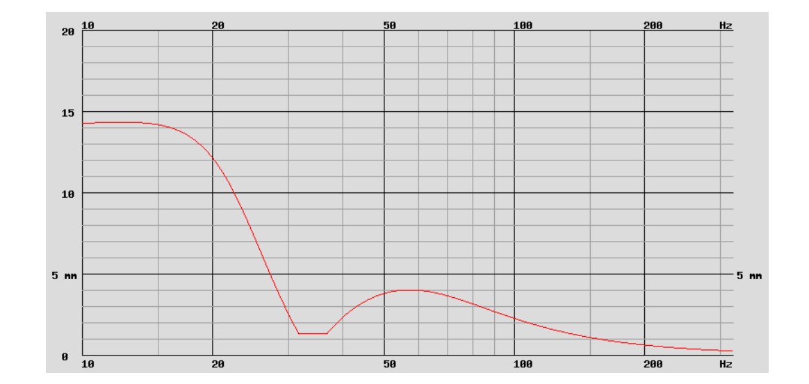

Can you describe better what is the problem with the sound?! (What frequencies and strengths/hot sound or other.)
I find that you have a (data from database of Philips AD12202M8, I can test with data from this thread in a second test/simulation) 104 L/BR@34Hz alignment, a little to squeezed for the driver to come alive (in bigger cabinet). Port 11cm/15.5cm. Port resonance 1115 Hz.
LF extension F6=38.5 Hz
Note: You need protection for the driver at LF under 25Hz (30Hz?) if using max power. Picture below for 28V (~100W, 7.8 Ohms@34.0 Hz). This can be one reason for problems.

Inductor... I can't measure anything so no more data. I find my self in your remark off more breathing room.. The only thing more I can say about the sound is that it seems to be all there but it is "inside" the box..
The measument on the data sheet are taken with the driver in a 90litre closed box..

Unfortunately I went for the looks while waiting for my second pair af driver and glued them in place. Of course I prefer not to mess with them but if the answer lies there I will break them out.

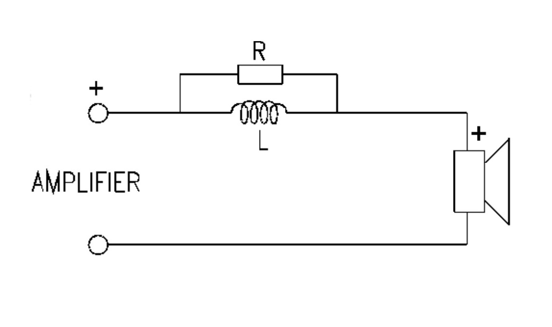

Conjugate network for attenuation in HF from 500Hz and up...
To attenuate the loudspeaker in HF only, +/-6 or 7dBs, use 1.5mH inductor and 15 Ohms resistor network.
To attenuate the loudspeaker in HF only a little use less (i.e. +/-4dBs use 0.82mH inductor and 6.8 Ohms resistor network.)

Inductor.. Thans for your suggestion. This mite be a bit of a dumb question but why would I attenuate HF when they are already dominant?
R.
R.
Let's see the other way around;Inductor.. Thans for your suggestion. This mite be a bit of a dumb question but why would I attenuate HF when they are already dominant?
R.
If you attenuate the HF the mids that you say is lacking will come to life. So will the LF, a little, as you will level or attenuate the mids and high frequencies even more, LF will become a little stronger. That's acoustics nature I guess. Have fun.
