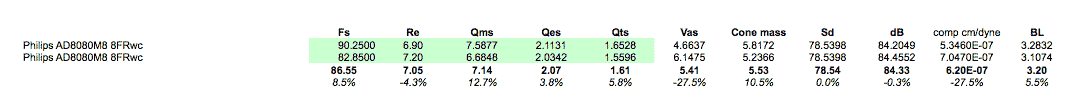

I think I found the model. I don't know how correct this information is but I did a google search and there was some German information on a website. I think what he means here was that he removed them from the same speaker box as mine "LFD 8022" and the speakers are
"Philips AD80800/M8"
I don't know if it's supposed to be Philips AD8080/M8
information that was written in German language. Maybe someone who knows german can help me to understand what it says there.
" Verkaufe zwei Philips Tieftöner Typ AD 80800/M8
wurden aus Philips LFD 8022 Lautsprechern ausgebaut
Außen-Durchmesser ca 20,5 cm. ( Tieftöner )
Durchmesser innen ca.18,5 cm
Ausführung 8 Ohm
Magnet ca 5,2 cm
Bei einen Tieftöner ist der Hochtonkegel etwas Beschädigt ( Siehe Bild 4)
Membranfläche ist Sauber .
Technische Daten
Nennleistung 15 Watt
Musikleistung 27 Watt
Impedance 8 Ohm
2 Stück
Die Tieftöner funktionieren einwandfrei,und sind im guten Zustand."

Yes, they are good drivers. I have one set of it’s very close cousins, and have only read good things about this exact model.
It could be any reason until you have them out of the cabinet and have new cables on them.
One thing: Are you listening straight on? These are really best (as opposed to the other well known Phillips 8 driver, just about 10 degrees off axis.
You might also find that they need to be played in a bit.
They might have been a long time in storage, or they could be from a certain type of previous owner, who like very soft music?
There is of course also the possibility that you have a pair of damaged drivers, though I find that pretty rare with vintage Phillips, for some reason.
