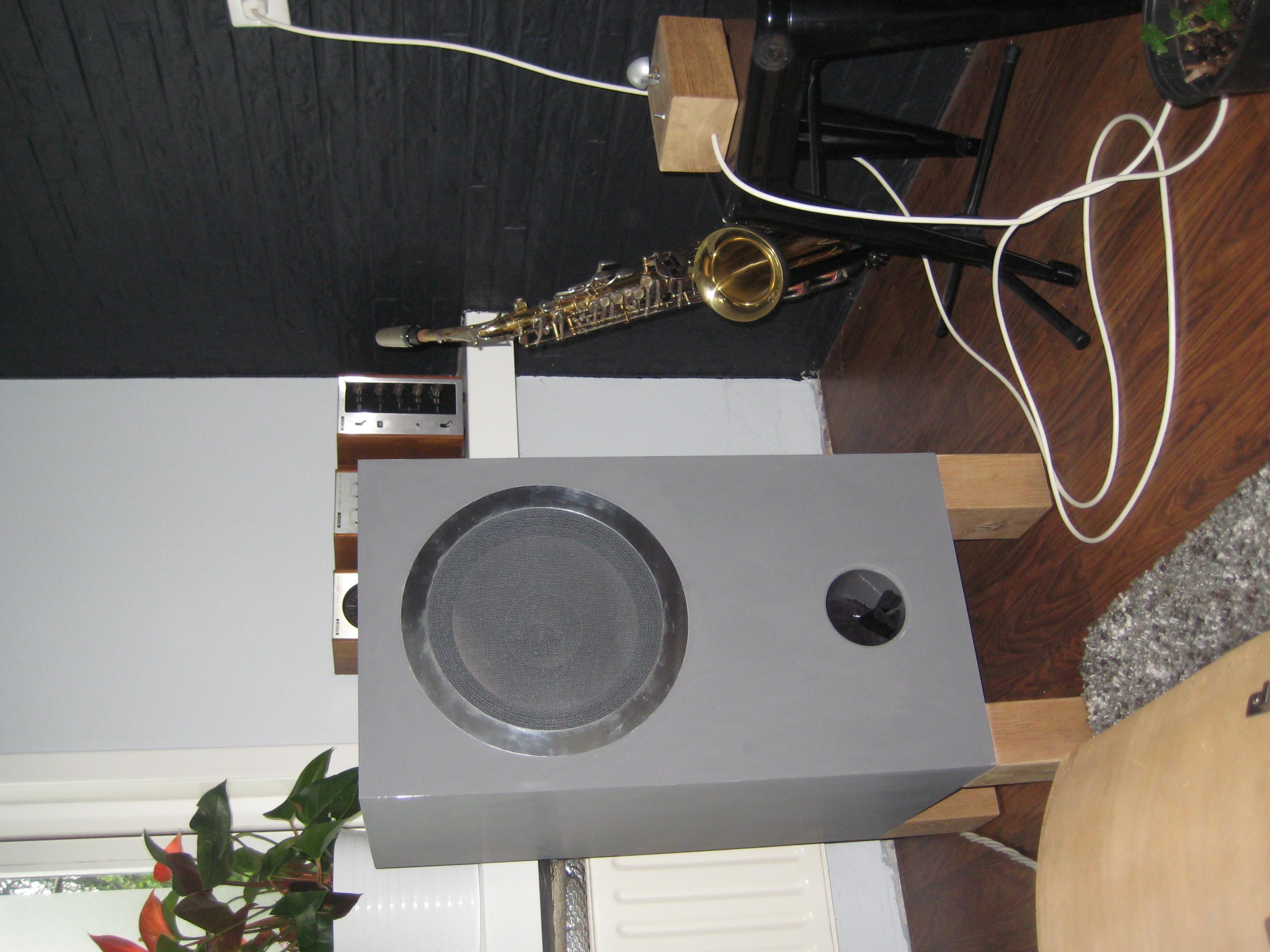

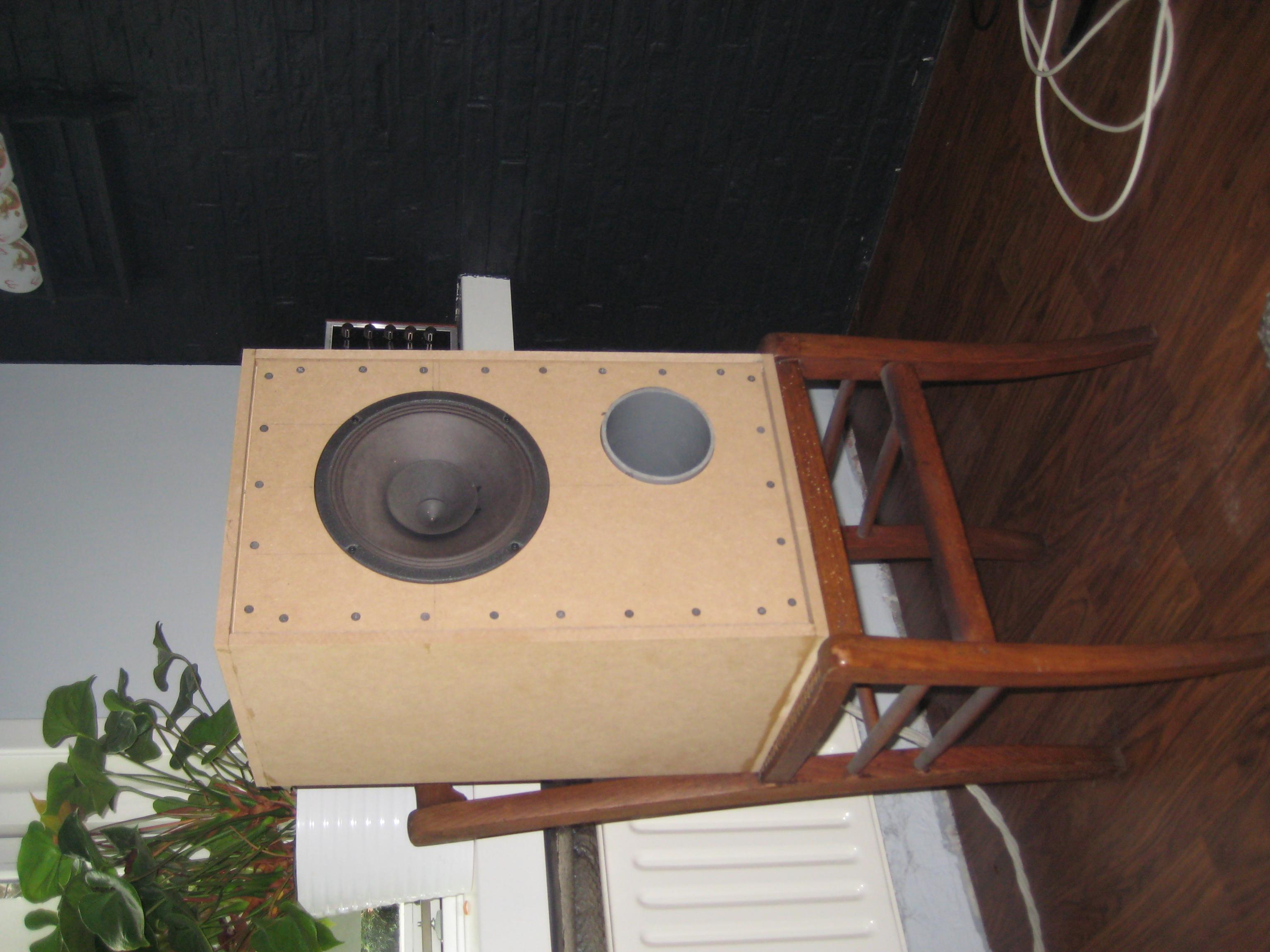

Meeting an old "friend"
Sorry Subaru for the late reaction. No I have not tried that, Do you have specific design in mind?
The reason for my late reaction is that I was meeting an old friend.. I had the design mentioned earlier laying around for two years and because of this thread I decided to build it!
The enclosure leaks a bit and I don't have the right dampening yet but as soon as I connected them I knew I had missed this old friend!
For now the TQWT sounds better but I love the looks of a monitor speaker..
R.

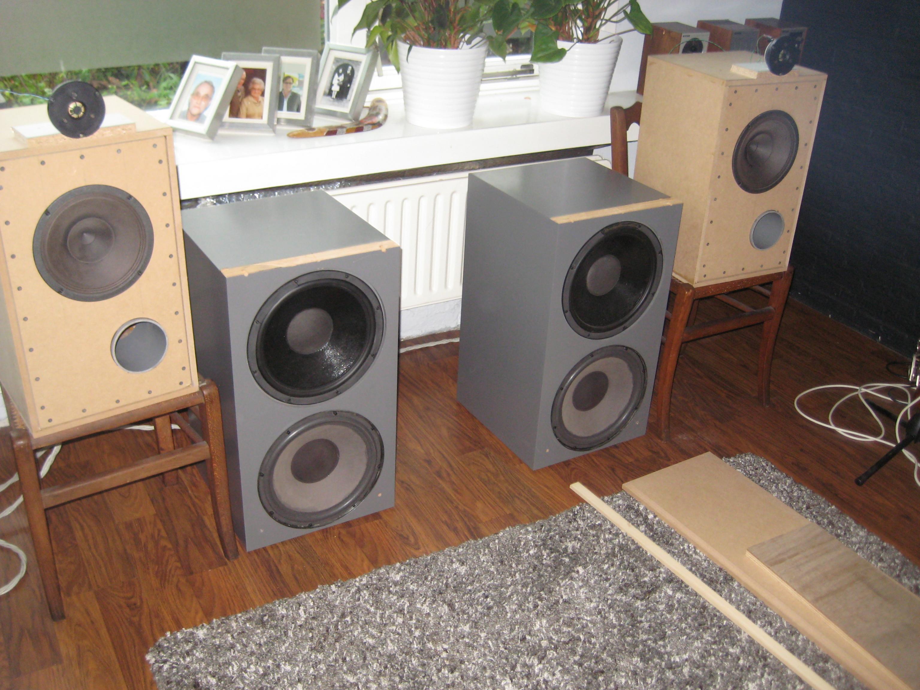

combining two projects
This 9710 thing crosses another Philips project of mine. I have two AD12202M in a 104 litres BR. Unfortunately it is a bit disappointing, so I added a RT8 Philips tweeter an added pair of AD12200W with Passive radiators in an old enclosure.
This sounds way better but although I have some space available, four very large cabinets is a bit to much.
But I could not help myself so I added an AD0163 Philips tweeter and plugged in the bass cabinets.... again it is not practical but it sounds very nice...
I am thinking of building a smaller Bass units with the Philips AD8000W and Passive radiators... It keeps you busy...haha.

Hi! I also had a pair of ad12100. The 12202 is quite different (better?). The problem I found out is that the sound differs enormously from pair to pair. My first pair was simply beautiful (in OB and BR) but died on me... The pair I have now misses the magic...
I love working with these full range speakers (without filters) in simple enclosures this makes it affordable to try different setups..
R.

Xerxes,that 104l BR box is with 12100 or 12202.Is it the same as studio12 BR box for 12100.Did you try 12100 in that 104l cab.Thanks
I myself can't calculate speaker designs. The design was a bit of a gamble using bits and pieces of data found in the Dutch forum. So it is not the design you mentioned.
I also must be honest that I went for the looks. For some it is a large grey box but I love its shape.
No I did not tried the 12100 in the enclosure. When I owned the 12100 I had it in a semi open baffle, which was very nice!
Also I tried a MLTL for the 12100, it seemed to compliment the mids so much that you want more bass to go with it what eventually resulted in way to much sound...
R.
