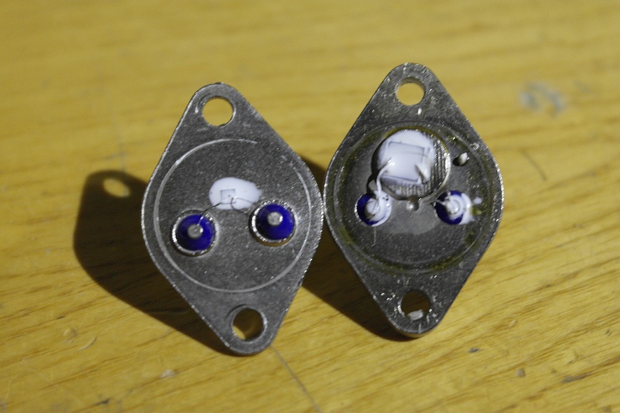

Here I got more info for a 578 amplifier about Fake MJ15024 company ON ( not Motorola) from China. I have blowing up my amplifier with fake MJ15025. I have opened one fake and good one. Its a big difference between them. I have now ordered some good ones in a local store. I think its al money worth. I have also some good equivalents for IC201 Opamp. I have seen guys who are using the OPA627 from Burr and Brown.

I have found that MJ15024 gives a big problem sell on Ebay. Especially from China. My 578 was blowing up by only replace 2 MJ15024. I found out to open it to see some a mayor difference between a original. See pictures.
I now have place a order in a local store for good ones.
For IC201 I have found out on another forum that OPA627 is a good replacement. Same pin and same voltage.

I have deleted the duplicates.
Thanks for placing my picture.
The right one is the real one from Toshiba.
Left is a fake one from China call MJ15024 from ON.
Wim
Wim
