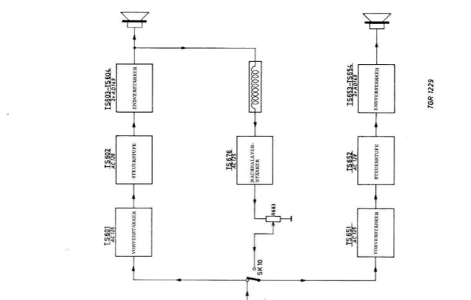

The tank is driven directly from the loudspeaker output on this model, through a matching transformer.
That sounded most odd, so I looked up http://modularstudio.nl/docs/PhilicordaGM751.pdf and its true - one speaker amp drives the tank, its output is routed to a different speaker + amp!
If you select a tank with a medium input impedance, say 800R, that should work fine.

The layout is as per the attached, for clarification.

I see in the schematic of the 22GM751 that the tank is driven from the output through a step up autotransformer. This to me is an indication that the tank has a relative large input impedance.
In the Philips radio's with reverb and 800 Ohm speakers and in the AG7600 the tank is driven from the 800 ohm secondary of the output transformer.

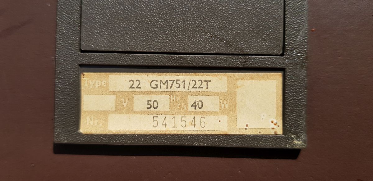

is your Philicorda this model?

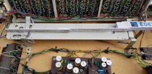

Today in the afternoon I've dismantled mine to get some pics for you. I saw that my memory really didn't serve me well as the reverberation tank is more huge than I've been remembering. It is about 44 cm long!
I also measured the resistances, but without disconnecting the unit. I don't know the schematics, so the values of the disconnected unit might be others. The driver measures 4 ohms, the receiver 180 ohms.
Btw, dismantling and reassembling a Philicorda is a real PITA! One doesn't want to do it more often than necessary 😎!
