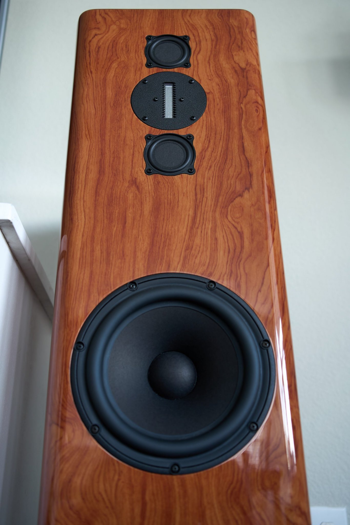

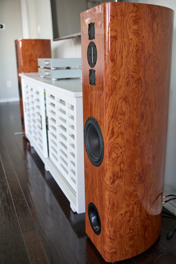

I think a rough clone of the Philharmonic Audio BMR Towers would be okay.
I've never seen a speaker or can't recall, with one of the most expensive tweeter and woofers and then cheapest mids, so I figure the BMR's must be okay. And the build quality is acceptable to me on the BMR's, from what I see in the pics. I also require a really good horizontal dispersion pattern. But I need the drivers to "sum" at a close distance also. Around 2 meters.
