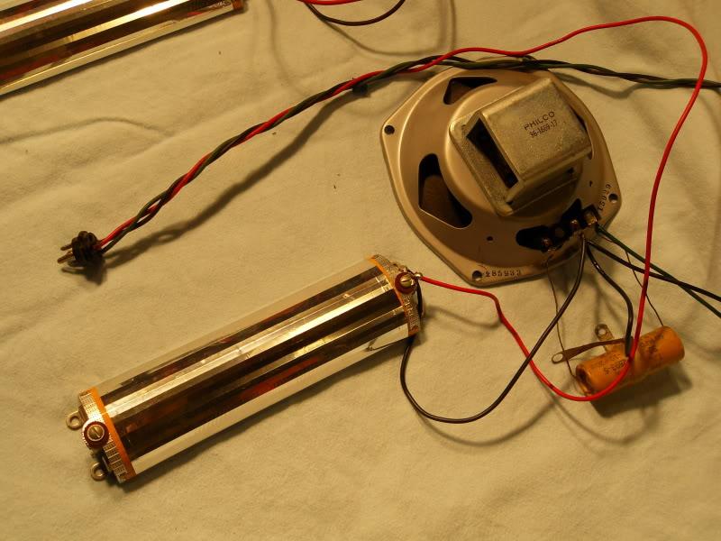

anyone ever heard these. how do you use this plug. any adapters or can i cut it off and add my own plug
My guess is you are asking about Philco Electrostatic Units that came with several different stereo console models (H-1714, H-1814, H-1816).
Currently there is a pair listed on ebay which appears to be where your plug picture came from.
Vintage Pair Mid Century Philco Stereo Phone Electrostatic High Freq Speakers | eBay
In any case, to work properly the unit needs audio signal fed to pins 2 and 3, and a high voltage bias supply connected to pins 1 and 5.(about 1kV). With audio signal hooked up, you should hear sound from the midwoofer whether or not you have a high voltage bias supply connected. You will only hear the high frequencies from the electrostatic tweeter once you connect the 1kV bias supply.
The print shows the Bias to be about -580v as I had expected.
Typically the ESL's of this era were driven directly off the plates of the tube amplifier.
They won't perform anywhere near as well as a DIY ESL using today's materials would.
But, I am sure they would be fun to listen to though.
The diaphragm is connected to a -580V supply.
But notice that the transformer center tap is connected to +370V.
So, the total bias voltage would be -950V.
