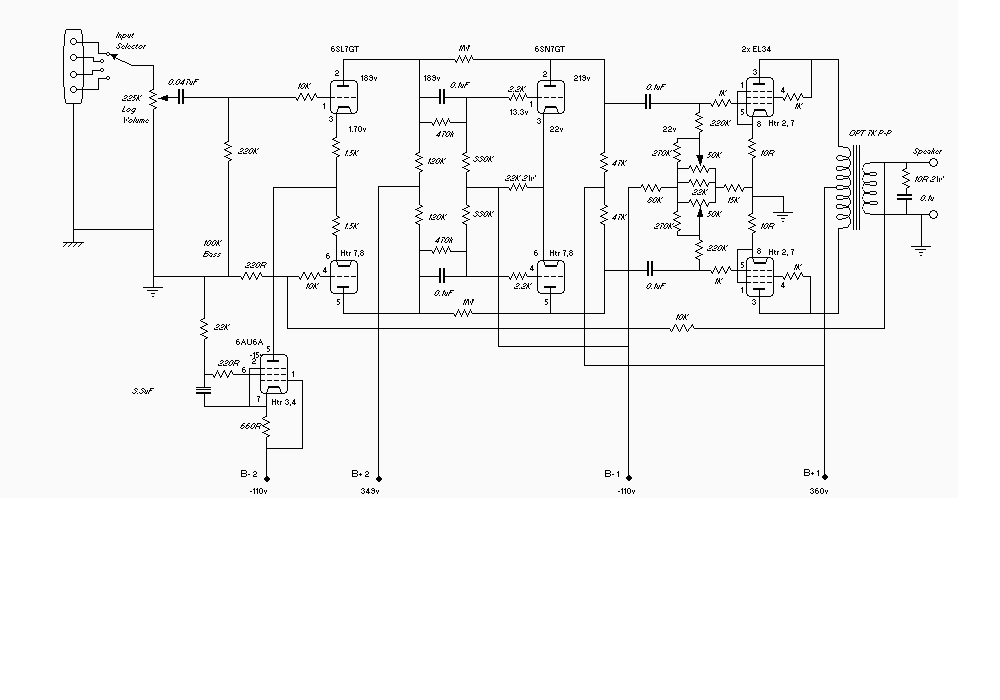

I'm looking for an input split transformer to do some test with differential topology. I've read about some projects with Lundhal and Sowter input transformers but I've never read reports about Cinemag products. After I've looked at cinemag homepage I have to say that they seem good products indeed. But how much do they cost? Have you purchased them directly from cinemag?
And which model have you used?

I tried to play a little bit with a very rough SPICE model of a 1+1:1+1 Interstage Transformer as phase splitter.
I "discovered" two things:
1. I could not push the output tube in A2 class: I hope this is a "feature" of the model
2. the swing required to the (only) driver tube is twice the swing required to each driver tube in a RC configuration: if the output tube is a 2A3 (FB= -50) it is not easy to get a swing of 2x(2x50)V=200V.
So, what I fear that what we get (in positive) from the Interstage Transformer is balanced (in negative) by the need of having a so huge swing (higher distortion, higher output impedance, both, ...).
