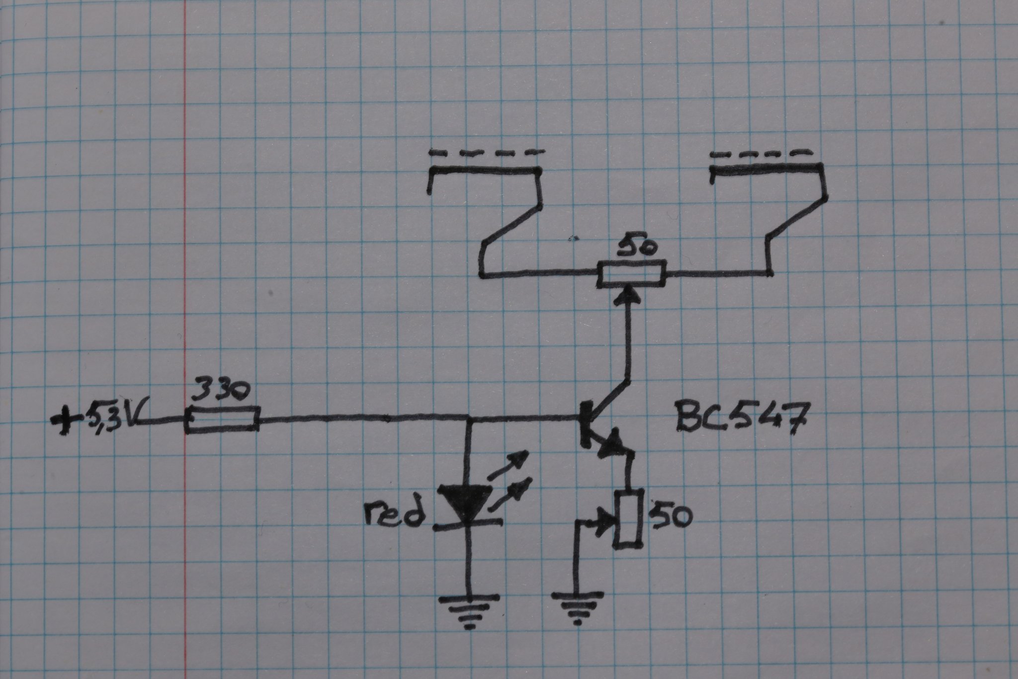

What kind of current source are you using for the input tubes?
Schematic of the CCS circuit, please.
You have checked everything else; try checking the CCS.
Why does the current source need +5V.
Most current sources start with a Negative voltage at the bottom, then the top of the current source goes to the cathodes.
That way, with the cathodes at perhaps +3V for example, the current source has -5V to +3V across it (8V), plenty of voltage to meet the burden voltage of most current sources.
Check that both supplies are equal, either +5V and +5V; or -5V and -5V.
Then swap the current sources.

You have labelled the voltages on the rectified supply for the CCS as +5.5V and 0V, but it seems like that is not what they'd actually be, because of those 100ohm resistors that are tying the midpoint of the 6.3Vac heater supply to ground. Wouldn't the two recified supply outputs be at something like +2.25V and -2.25V? Maybe this is OK, but without seeing the schematic for the CCS it is difficult to tell.The +5.5V supply is for the CCS. And yes, it is PLUS 5.5V.

it needs a negative supply, cause transistor may be underbiased, with some tubes it may work but in most cases the tube will only droping a couple of volts, then if the tubes are unmatched the available voltage for the ccs will be less, the red led bias at the transistor is 1.8V so the cathode available voltage will be less cause it would need to be higher than the base to conduct, when driving signal, it will become negative and abrupt cut or plain oscilateHere's the CCS. Be gentle, it was the first CCS I ever designed with trasistors. And without a negative rail.
I'm inclined to drop it, and install a negative supply and just use a really big resistor in the tail. I've got a 50V bias tap left on my PT.
It's a NPN and the bias is fine. In case of overload it will be bad but so is without.it needs a negative supply, cause transistor may be underbiased
An issue with CCSs is called voltage overhead (among other names), meaning how little voltage can it have across itself and still be a CCS. The voltage at the "top" of your CCS is the DC common cathode voltage, at idle (no signal) plus and minus 1/2 of the input signal voltage to the amp, with signal. First thing is to measure that DCV. Then figure the signal voltage added to that. Let's pretend signal voltage at the input jack is 1.0 VRMS, so signal voltage at common cathodes is half of that: 0.707 VPeak positive and negative.
The CCS needs to operate properly down to DC common cathode voltage minus 0.707 Volts. Does yours do that? Let's assume that yours works well enough down to a voltage (at it's CCS output) of the voltage across a red LED plus a few tens of a Volt, with zero margin for error.
If one were to measure the DC common cathode voltage and the DCV across the red LED, one would resolve this issue. Or converting to a negative DCV supply, which would give plenty of headroom.
Don't know if this will solve your issue, but needs to be explored. And painless enough to do.

So the idea works fine just the implementation of the second amp differs. Now it can be still the CCS on that one so try another BC547.Worked fine on one amp, couldn’t get near it on the other one.
