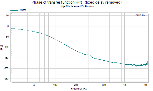

attachment.php
That's a typical phase transfer function of a speaker. Below resonance frequency it approaches zero. At resonance it's -90°, at higher frequencies it approaches -180°.
So my problem doesn't seem to have an easy solution. I would need to choose a speaker with a higher resonance frequency. But I want the speaker to work at low frequencies. That's a contradiction.

Nice software, but I'm not sure I understand the graph. If we take for example the white curve, where is the resonance frequency located? At 63Hz?
Also, I don't think I understand how the phase can change from positive through zero towards negative.
Just to make sure, I'm talking about the phase of input voltage vs cone movement. It should start at zero at very low frequencies and then a delay should be added towards higher frequencies.
The delay would depend on voice coil inductance and cone mass.
Can you explain the graph? If the phase shift goes through zero it would seem that at one part of the curves the cone movement would advance the input signal.
I don't recall the Fs of the 5" driver, perhaps 80-100 Hz. In box, the resonant frequency shifts up, the response is -3dB at 120 Hz and -16 at 60 Hz. The narrow peak at 63 Hz may have been caused by a wind gust.
Phase is relative, whether the measurement starts at +180 and goes to 0, or starts at 0 and goes to -180, the same amount of "rotation" has occurred.
The input signal phase would have no rotation (it would be flat, "0") , but all speakers will show some rotation, and the rotation follows the low frequency roll off.
