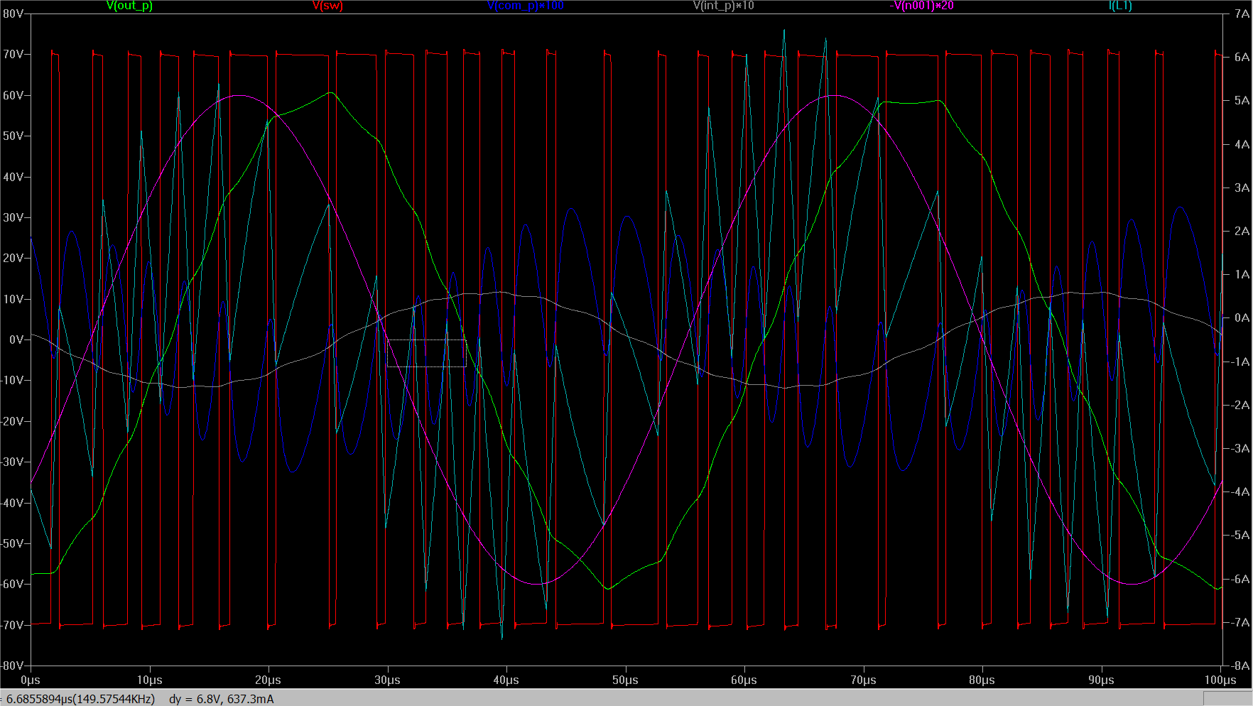

The paper doesn't directly mention phase shift, however, note the troubling zero-crossing "hysteresis" effect:
It can be seen that voltage measured before
the ferrite bead Vin keeps it’s sinusoidal nature. However,
The voltage measured after the ferrite bead, presents some
nonlinear behavior near to zero. According to (??), the voltage
across the ferrite bead is computed and shown in Fig. 6.
As can be seen in Fig. 6, pikes appear when the signal
passes through 0 V
https://hal.archives-ouvertes.fr/hal-01103584/document
Although phase not mentioned specifically, please note Figure 5 showing what appears to be an amplitude-dependent phase-shift from input to output across ferrite, with a discontinuity at zero.
Figure 6 shows the zero-crossing distortion.
Figure 8 shows frequency-domain distortions introduced.

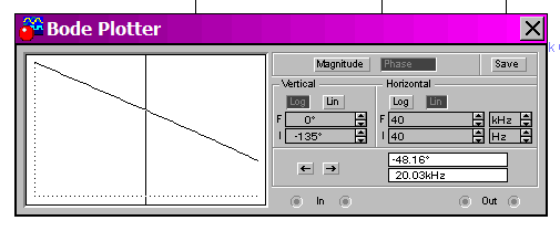

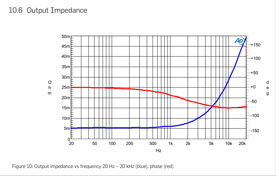

IcePower 1200AS2
has 50º at 2 kHz. And about 70º at 20 kHz. In other technologies (A and AB) it would be unacceptable. Why not in class D?
I think it is a design flaw but class D is a bit mysterious to me. That is why I opened the thread.
But if it is such a clamorous flaw how is that the graph appears in the manual? -> I decided to open this thread.
NO! Because Icepower is not High-End, many shortcuts against good engineering practice were taken in design. B&O is a company led by money discipline, not by engineering discipline...

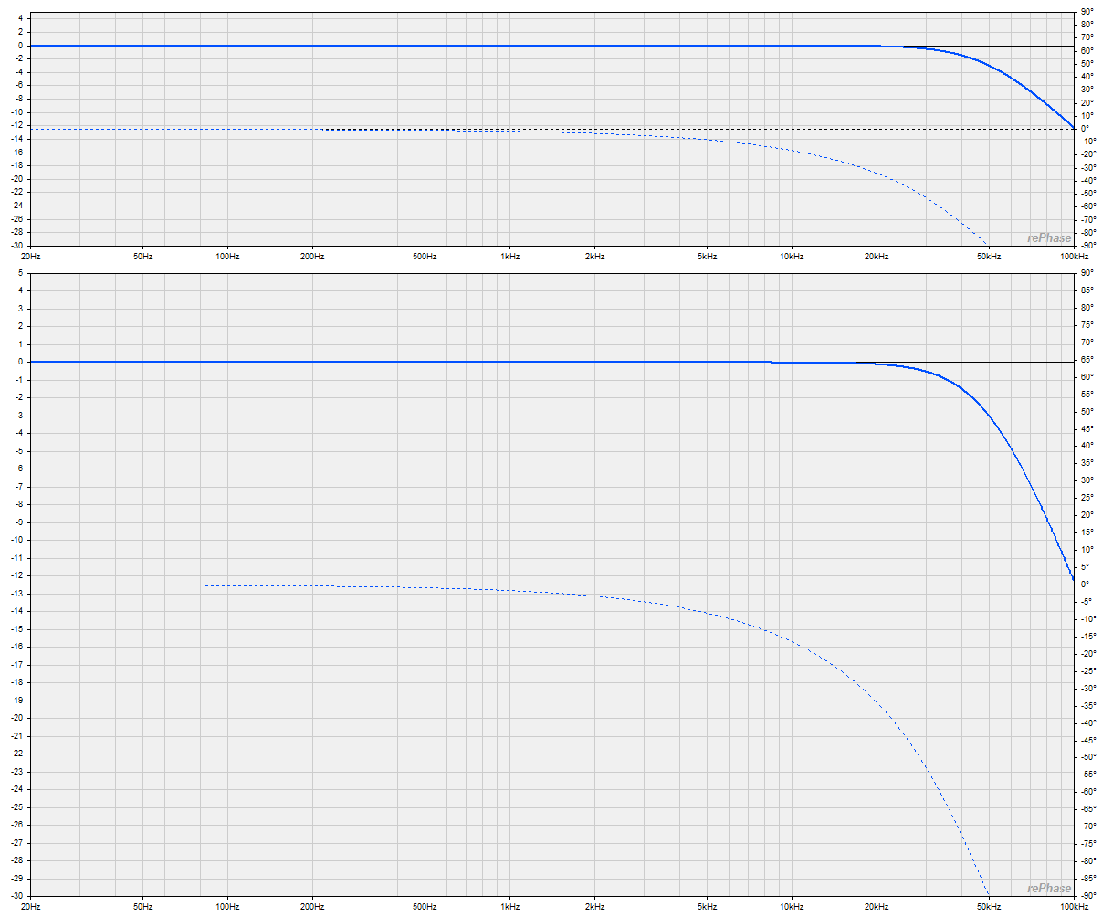

Phase shift wise, class D is different from linear because there is a delay involved in modulation, and sharp LPF is required above 20Khz for clean modulation. However, as I showed, there are approaches to make a class D amplifier act as a fixed delay through audio band.
General solution to class D modulation is phase-shift self-oscillating with post-filter feedback. This can be tuned for flat output impedance, delay and frequency response. This is currently made by Hypex and a few others. The technology I'm developing uses same modulation, but it is more oriented towards high-volume listening, and has been offered to complement their product range.

675719d1523960655-phase-shift-class-amplifiers-affects-sound-76489414-30ce-471e-bc96-f9dd04c23dc1-png
Figure 10: Output impedance vs frequency 20 Hz – 20 kHz (blue), phase (red)
