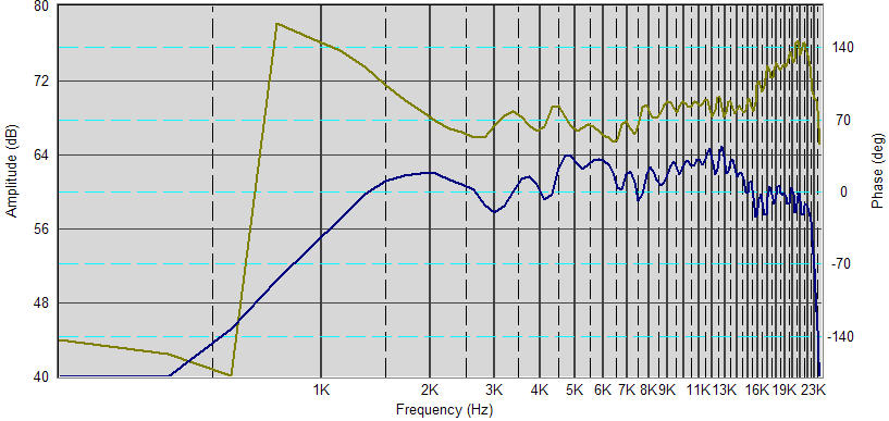

Okay. I played around with SW. Looking at the tweeter, the phase would probably look something like the attached picture. Amazing it doesn't use the original MLS data, probably using a different algorithym to take out the delay.
The network capability is probably better suited for generating response with the XO included instead of using COMBINE. since the combine was probably designed for combining near field and far field data, I do not thing the phase information is combined. But I havn't trie it though.
The phase of the bass looks mixed up. If you can get a different in distance between the speaker to mic versus speaker first reflection to mic of about 1.2M, then the you should be able to get better phase measurements for the woofer.

Thanks for taking the trouble.soongsc said:Okay. I played around with SW. Looking at the tweeter, the phase would probably look something like the attached picture.
One question: how do you determine how much phase delay to add which gives you the "right" result? Is it purely visually?
Secondly, does this correcting of phase delay affect xo design? I was under the impression that it doesn't.
As I'd mentioned I was getting exactly identical results by using the COMBINE operation and the physical aggregation of xo components. Also, the near and farfield combination is done using SPLICE, IIRC, not using COMBINE, in SW.The network capability is probably better suited for generating response with the XO included instead of using COMBINE. since the combine was probably designed for combining near field and far field data, I do not thing the phase information is combined. But I havn't trie it though.
So basically, this means I should move the mic back further? Let me do another set of measurements (tonight) and see.The phase of the bass looks mixed up. If you can get a different in distance between the speaker to mic versus speaker first reflection to mic of about 1.2M, then the you should be able to get better phase measurements for the woofer.

Problem Solved!!!! 🙂
I am now able to get neat summing of the LP and HP curves, without a single dip or peak anywhere which was not there in the original LP/HP curves. So, I don't see any big phase misalignment problem any more.
The problem was my sound card. Its latency jumps randomly. I can take five different readings and they'll have five different delays between 0msec and the start of the MLS spike. I have always known this, but I've never known that this would cause phase misalignment between the drivers. (You have to excuse my ignorance... this is my first design project.)
With my card, it's not even feasible to "get the delay right" using the "Pulse Response" operation and then proceed to the FR measurement. You simply have no way of knowing whether the latency during the FR measurement was the same as the latency during the Pulse Response reading. So I gave up doing FR measurements altogether. I just did Pulse Measurement and applied FFT to it to get my SPL curve.
To get the tweeter and woofer to phase-align, I took pulse readings of tweeter and then did multiple pulse readings of the woofers till the MLS spikes in both aligned perfectly, by visual comparison. Then I applied FFTs on both, plugged the SPL curves into the xo's, summed the xo's, and got a well-behaved sum.
Luckily for me, the latency jumps forward and back in largish, discrete steps. It never seems to jump to completely random points... it always jumps back and forth to specific points, which are almost 1msec distant from each other. So the spike will either be at 2msec or at 3msec, but not at 3.1msec. Therefore, a visual alignment of two pulse measurements seems to work very easily. The two spikes either align very well, or they very obviously don't align.
So, this problem appears to be licked.
The last niggling doubt or unease I have is that the reverse-polarity summing is not giving me a deep notch... the notch I'm getting is barely 4-5dB deep. However, this is far less serious than the situation that I was in earlier.
Any comments about why my reverse notch is so shallow? My guess is that the phase data of my woofers is "smudged" because the two woofers are not in exact phase alignment with each other. Don't ask my why this is so, but this is the best guess I can hazard. Maybe it has something to do with the fact that the two woofers are in series.

One possibility is that using discreet measurements will prevent you seeing the deep notch. It may be there though. Look at the phase plots and if there is 180 degrees difference at the null point, there really will be a deep notch even if it doesn't show.
I remember reading earlier of someone saying you should remove the excess delay. This will make the phase plot more straight instead of wrapping around, but it is still the same. You must remove the same time (milliseconds) from each the tweeter and woofer or else your plots mean nought.
The main issue is relative phase. Do to one driver what you do to the other. So, you can measure with a poor microphone, use a poor sound card, delay both channels etc, and you will still be able to see whether the two drivers are in phase with each other at any given frequency.
The microphone should be in the same spot for each measurement. I like to do each driver in quick succession to make sure I don't bump anything.
I like to use pink noise to do my phase measurements with the mike at 2'. Some may disagree. I can watch the FFT spectra for anomalies and re-start the test if desired. I can set the averaging up and let the curve settle. This can give a more robust noise input than a MLS signal.
I think that room contributions are less critical when measuring relative phase than, say, SPL measurements. YMMV.
