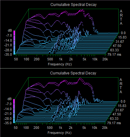

Last month I cut out a dustcap. Unfortunately I broke the rules and altered the crossover (slightly) at the same time. The difference was subtle but very nice, like not changing the tonal balance but cleaning things up.
Here is an on axis plot (sans crossover) of : Green = before, Orange = no dustcap, and Red = a simple cylindrical plug. CSD is before and after.
I did a similar experiment with one of my older spare Coral Flat 8's which had a damaged dust cap, (which are aluminum domes crimped on the voice coil former with a gauze covered vent hole in the middle) and to be honest I don't think removing the dust cap is all that people crack it up to be...
My measurements mirror those of yours pretty much - simply removing the dust cap actually makes the cavity resonances between 1-2Khz measure much worse because you still have a cavity and now that it's exposed it radiates directly instead of being largely obscured by the dust cap with only a small amount of the resonance "leaking out" through the hole and by re-radiation from the dome.
With the dust cap simply removed the result was unsatisfactory, you now have to fill the hole with something to eliminate that cavity resonance - eg a "phase plug". I tried a variety of different lengths, shapes, like cylindrical, bullet etc, and all of them have the same effect of eliminating the cavity resonance between 1-2Khz provided they are a close fit.
Where they all differ is in the 4-8Khz region, where even small changes in the shape of the "phase plug" have a large effect on the response. Although I'm sure it's possible with just the right shaped taper to get a relatively flat response, with trial and error I could not get a response anywhere near as flat from 4-8Khz as the original dust cap being in place.
My conclusion was that for that driver, a phase plug is a mistake. Whilst filling the cavity did improve the resonance between 1-2Khz, it was relatively minor to begin with when the dust cap was in place, and without going to a lot of trouble to develop just the right shaped plug the response from 4-8Khz was all over the place. It's not just a matter of sticking something in that looks like a bullet and hoping for the best 😉
Treble response from 10Khz up whilst slightly flatter was a lot lower in level, and with far worse off-axis response than the original dust cap. On these drivers the dust cap is acting as a horn loaded dome radiator. (With the curvilinear whizzer cone acting as a horn for the dome) Removing the dome means all the treble radiation is coming from the whizzer cone only, so response drops a lot >10Khz, and treble becomes a lot more directional, even with the phase plug in place.
What could have been done instead, is adding soft damping (cotton wool ?) behind the dust cap to eliminate the 1.5Khz cavity resonance and just leave the dust cap in place. It really is an important and active part of the driver, responsible for a lot of the treble response and dispersion, not just a shiny embellishment...
I've found the ~10Khz "oilcan" resonance of the aluminum dust cap can also be largely eliminated without removing it simply by putting a small dent in it near the edge with a small flat blade screwdriver - a mod that I've done to my other units as well. You can't see it unless you look closely, the treble response is not significantly reduced (unlike removing the dust cap) and the response is significantly flatter, with a much better CSD ~10Khz.
