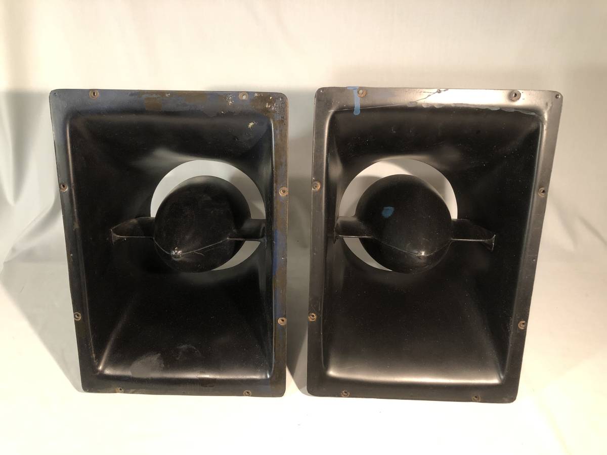

The phase plug on the Turbosound TMS-3 is symmetrical, and by reducing the volume in front of the woofer, it horn loads the output.
Basically the phase plug reduces the volume at the throat of the horn, and by doing so, raises the acoustic impedance, increasing output.
The shape of the phase plug should also equalize the pathlengths, if properly designed. By changing the pathlengths, it changes the shape of the wavefront at the throat.
Also, I resurrected a twenty year old thread because I was looking for info on one of the other Turbosound phase plugs, the "axehead."
