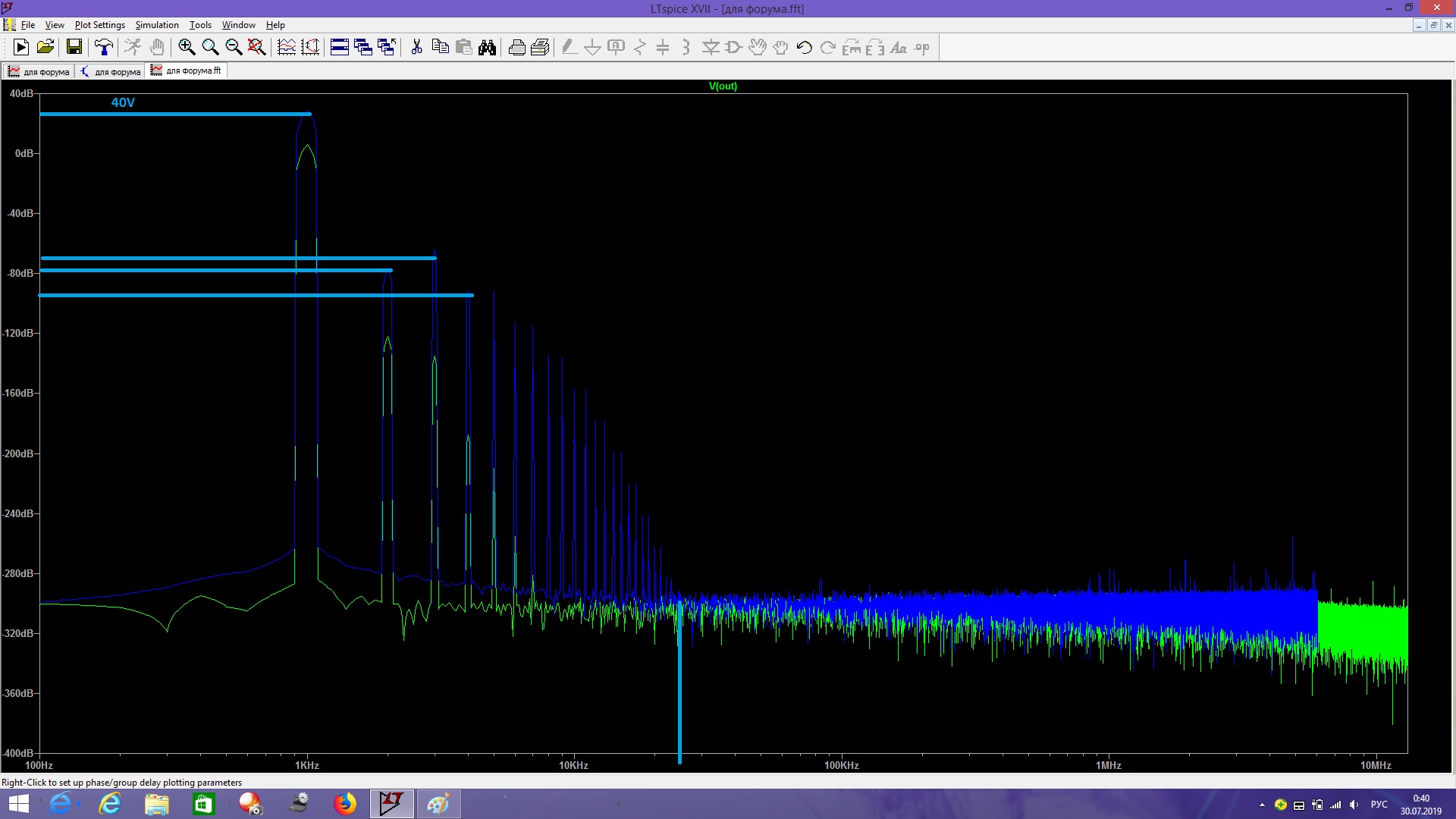

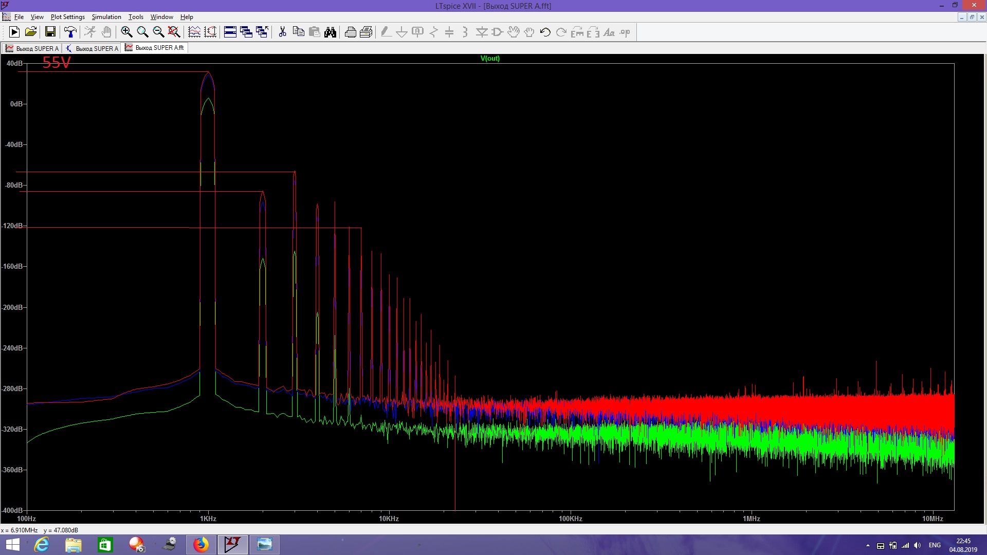

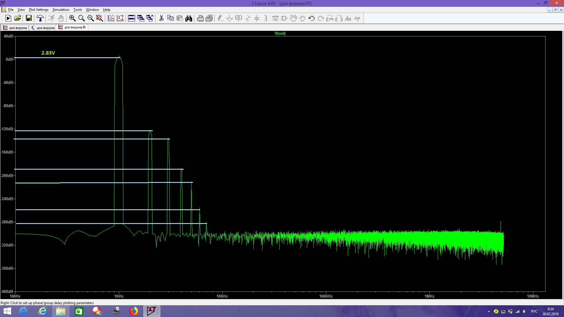

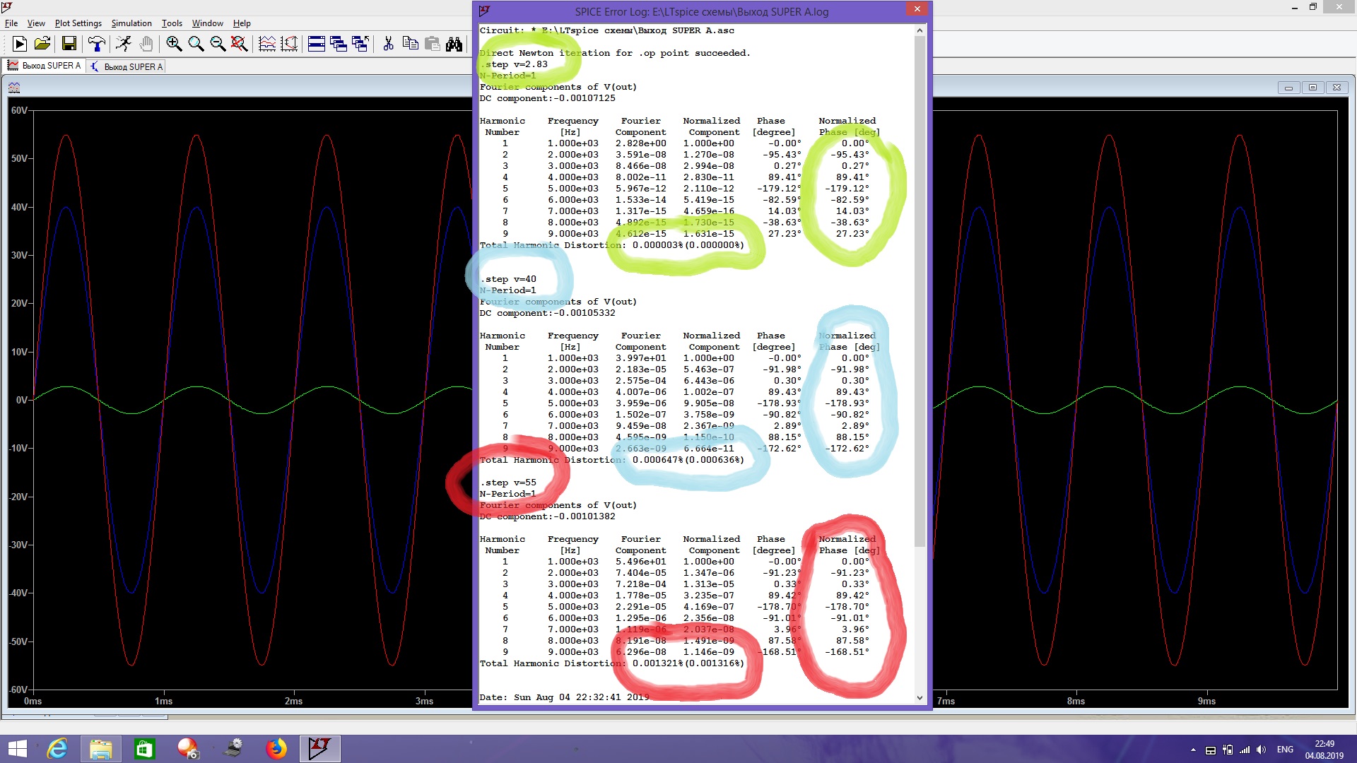

I specifically singled out yellow, the level of 2.83V, and in the same place indicated the phase in degrees for the same 2.83V. Where did you see H3 above H2 and H5 above H4? All harmonics highlighted in yellow fall one after the other.
Not only the harmonic level is small, but the phase shift too. Yes, it looks unusual, because the level of harmonics is extremely small.
The blue level is 40V RMS (for a load of 8 ohms it is 100 watts). The red level is 55V RMS (for a 8Ohm load, this is 189 W). Are you trying to achieve a monotonous reduction in harmonics for a 55V sine wave in your amplifier? Are you listening to a sine wave through your speakers at maximum power?
Specify at what voltage you showed these your phase shifts.

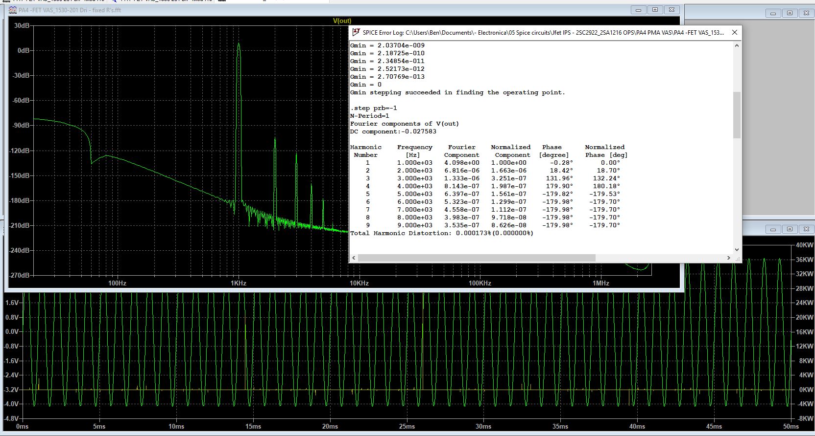

I made myself the same question many times, however never asked on the forum.
I have something similar: H2 = 18,7°
Have no idea how important the phase angles of the harmonics are.
It often happens that the distortions of two amplifiers are about the same, while the phase shifts are very different.I feel its much more useful to look at the distortion residual rather than try to devine information indirectly from the phase angles.

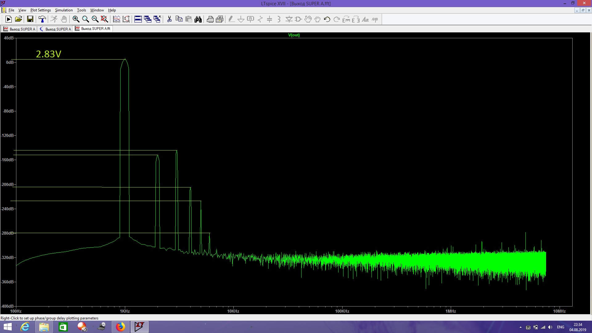

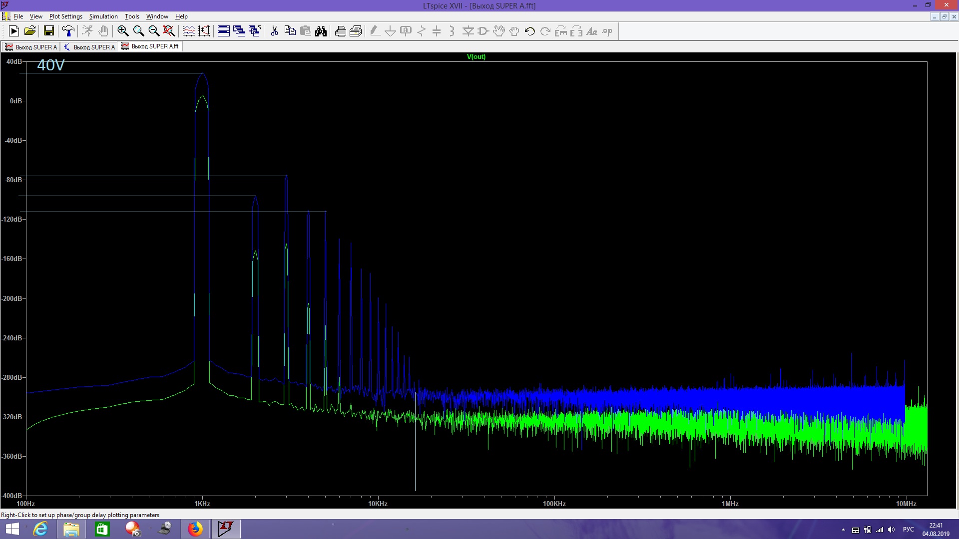

Hi guys. I decided to reconfigure the amplifier, for all tested amplitudes 2.83V, 40V, 55V and again at a load of 8 ohms.
This time I limited the phase rotation angle for all harmonics to 180 degrees. The result exceeded all expectations. Note the extremely short range of distortion.
It is also seen that the phase shift of the third harmonic at all three amplitudes is very small.
It is possible that the phase shift at the third harmonic is the most significant in the process of tuning your amplifiers, too.

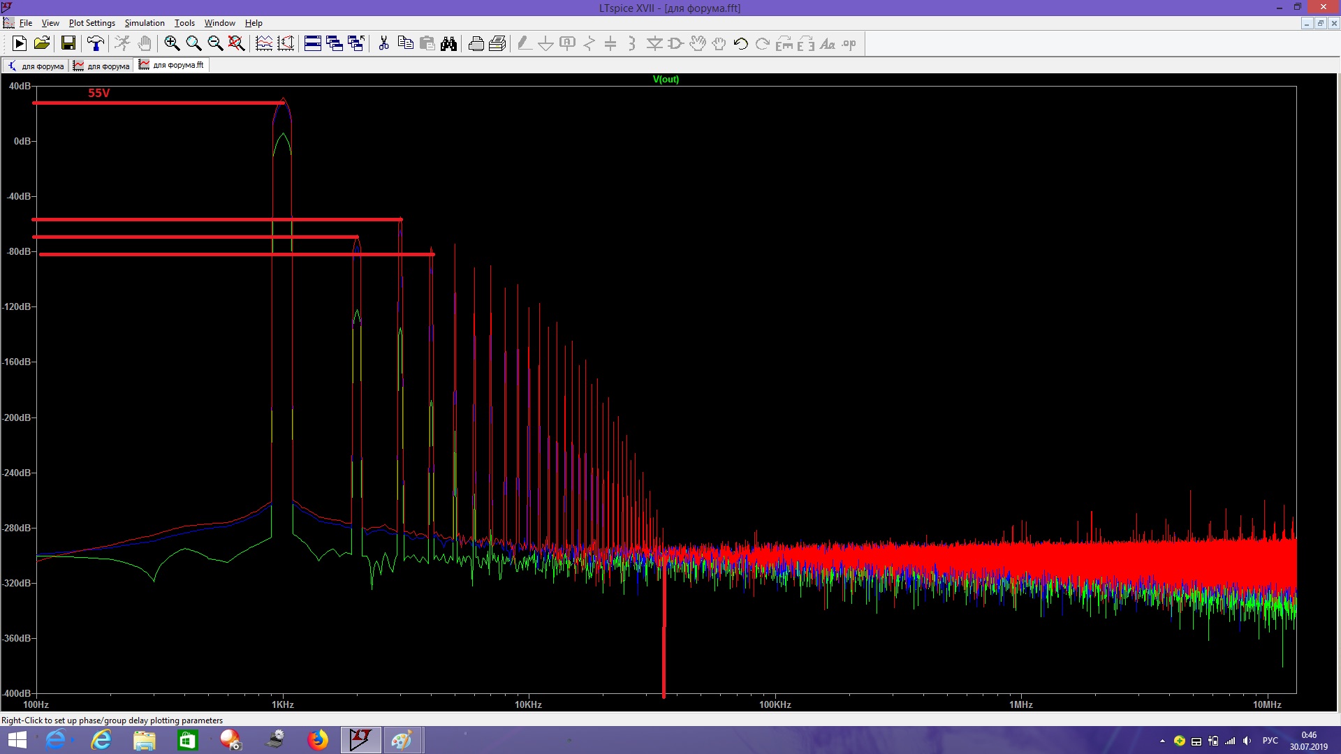

Firstly, it is a circuit model without general feedback.
So you are achieving better than -120dB distortion (1kHz) at high power
without global feedback? How does it measure at 20kHz, same power?
TCD
These are good questions. Unfortunately, with such a high resolution of the generator, even at 1 kHz, the program begins to count for a very long time.
Probably, the measurement procedure on real instruments with limited accuracy will be changed to measure distortion at high frequencies.
