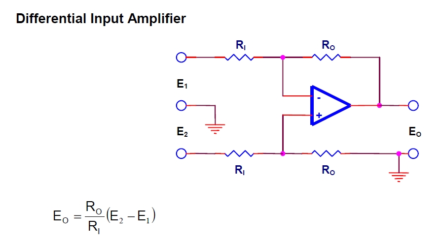

It looks like you have a differential amplifier circuit like in the image attached below.
In the transformer circuit the secondary winding resistances form Ri, and Ro would be the 5.1k resistors. The voltage across the normal (pins 6-7) secondary winding could be represented by a voltage source in series with it's Ri resistance. The other winding of the transformer (pins 8-10) that acts as a resistor could be represented as two voltages sources in series that are equal and opposite in series with it's Ri resistance. Since those two voltages sources cancel out, we can omit them from our model and replace them with a short.
Therefore, what you have is a differential amplifier with a voltage source connected to one Ri and the other Ri connected to ground.

No, not at all. If you are concerned about current flowing out of the op-amp into the transformer, it doesn't do anything. The current flows into a winding that is in effect a non-inductive resistor. The fields cancel and no flux is produced, at least as a first-order effect.
Again, one winding (pins 8-10) is wound so it acts like a resistor, not a transformer winding. Half of it is wound clockwise and the other half is wound counterclockwise, so the fields cancel. There is neither input into the op-amp from that transformer winding, nor effective core flux created by op-amp output current flowing into that winding. The winding is only a resistor, that's all, there is no transformer action for that winding.
All the other transformer windings are wound normally, so coupled flux is produced resulting in transformer action.
Why don't you check and see? I think the model I described should come pretty close to predicting the gain you have.
EDIT: You left one thing out of the diagram you produced above. There is no generator representing the normal transformer winding (pins 6-7) secondary EMF which should appear in series with the Ri connected to the op-amp inverting input. Or you could show that as an ideal transformer connected there. Either way amounts to serving the same purpose as far as modeling op-amp circuit.
Also, from the resistance values you measured, it looks like the two windings that form the resistor element are slightly unbalanced. That may very well account for a some small-ish net flux associated with the resistance winding. That could be used to compensate for transformer distortion to some extent, but the effect is probably small enough that it doesn't have much effect on a first order model of what the expected circuit gain would be.

Sorry, i'm a lazy guy... there is so much things to represent in the transformer (equivalent circuit model).
To be simple, if the secondary coil (8-10) has no interaction with the core flux, could you explain me how the center tap (9) of this bobin (8-9) is returning half of the signal ?
If i balance the two secondaries resistances, the circuit is running into instability.
Measuring across 8-9 or accross 9-10 does interact with core flux, as there is no cancellation when they are used alone. They only cancel out when connected in series, due the the inverse phase relationship between them (EDIT: in other words, relative to pin 9, pin 8 and 10 are both in phase with each other, so there is no voltage difference between them).
